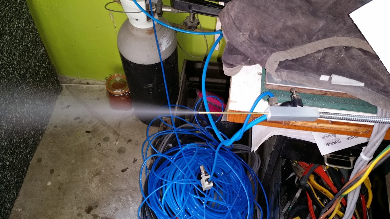

    Some update. i like designing and challenge.
    I tried the way they tell it but the effect was not to my liking. The spray pattern was not good and the control of the flow was lame.
    So in my free time i started experimenting and little by little i designed my own fog-less mister cooling. Bellow is a video of me testing the nozzles while Jeff is cutting my Z axis spindle mount, this today. Unfortunately the phone battery run low so i captured the moment with too much flow from the nozzle, you can see the mist at the back, though in fact its no mist but droplets, there was too much flow. So the video is of how it should not be, but you can see the cleaning effect of the air blowing away the chips.
    Later when i lowered the flow it was perfect, blowing the chips, cooling the bit but at the same time no mist in the room after half an hour milling. I am thinking to manufacture some and sell them for a reasonable price.
    What i can say is that just sticking tubes together as per some drawing does not work well, all flow connections and transitions should be well thought and shaped, plus the exit nozzle must be shaped properly. when done properly the flow seems to reach ultrasonic speed judging by the sound and at the same time does not mist but forms nice, thin, long, properly shaped flame like cloud that disappears completely after hitting the material. The best result is when at the middle of the "flame" at "ultrasonic" speed forms a nice needle like thicker stream of droplets.
    what i mean without wanting to insult somebody is that after i played around and experimented for a couple of days, i saw that even a product which all worship and is worth 350$ is not so well thought of, as they want us to believe. Some day when i have more time will illustrate what i say with photos and proper video. lets say that with the bigger flow nozzle when adjusted properly i achieved a 40-50cm long stream where at this long distances is only 5cm wide and still no mist there. Its only flow being too much flow, though maybe for stone will be ok. In fact if there was a reflector at the back where the flow could hiot it there was no mist at all, cause all droplets were falling down. The problem comes with too much flow and nothing to stop them. At the end there is transition to mist, so that must be avoided, by limiting the flow for example or the nozzle size and shape.
    For now a crappy video of the system . Forgot to say also- crappy Chinese valves and speed adjuster did not work. Same with custom valves made from this and that. But "made in Italy " valve worked like a charm for precise flow control. Guess why.

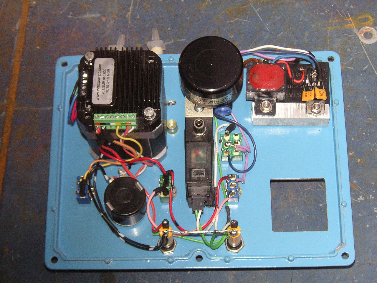

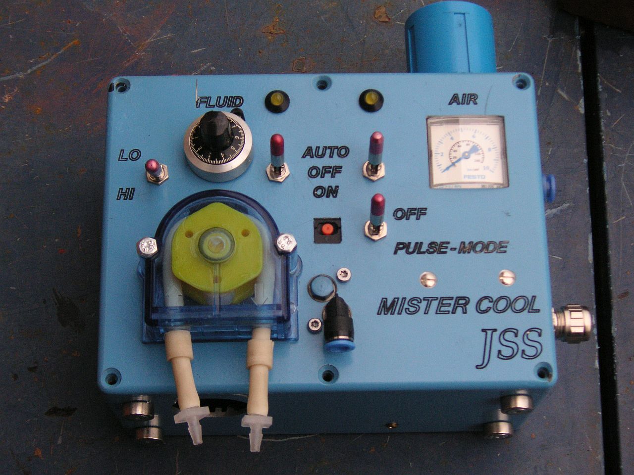

    I got fed up with trying to get the flows right, so made this
Name:	Mister cool-1.jpg
ID:	14953   Click image for larger version.
Name:	Mister cool-2.jpg
  8. #7
    Quote Originally Posted by johnsattuk View Post
    You could sell that at Etsy as steam punk art . Man, its beautiful. Looks like a mist cooler coming from the future or like something savaged from a spaceship station
    project 1 , 2, Dust Shoe ...
  9. #8
    Totally independent control of Fluid and air, air can be pulsed for better pocket clearance,without affecting the amount of fluid delivered. Can squirt fluid alone (up to 90 cc's a min )for some jobs.
    Fluid container can be put wherever you like ( within reason) , does not siphon or drain back, will handle different viscosity's .
  10. #9
    I Like the sound of that John and very well made. . . . Got couple of Q's if you don't mind answering. You may have just added another Job to my endless list.!
    Whats on the heat sink on right.? Looks like thermister, resistors and black box which I'm not sure about.! And what are they doing.?
    What and where's the power source.? ie voltage.
    Where did you get the peristaltic pump.?
