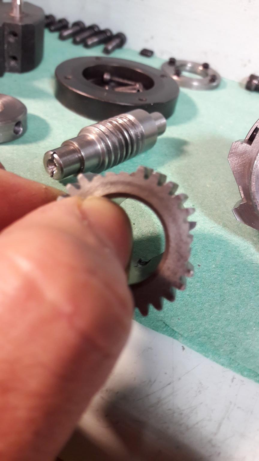

    Hello Saracen,
    I work in a school and we have a Boxford 160 like this one. We are having turret indexing issues. I don't suppose you have a diagram of the turret assembly so our technician can strip it down? Only manual I can find is online for £60! Zero chance of school buying that for us.
    Thanks in advance,
    Neil Brodie
    (DrNBrodie at gmail.com)
  6. #26
    Hello please let me know the precise problem as I have striped a few of these and I may be able to assist. They are not very complex and parts and diagrams are on the Boxford website.
  7. #27
    Here's the page on the Boxford Spares site:
    http://www.boxford-software.com/spares/160Turret2.html
    I don't have a manual for it; I just dismantled slowly and made notes as I went.
    My problem was also the indexing, in that the pressure from the springs on the pawl would stall the motor and stop the thing from turning. I cleaned it all out and re-greased it and it has been fine ever since.
    Adrian.

  8. #28
    I did exactly the same for the same problem but I also increased the pulses and it helped a lot it also made locking more precise.
  9. #29

  10. #30
    Thanks for the spares link, it helped a lot. We have got inside and the issue seems quite obvious... 😂
