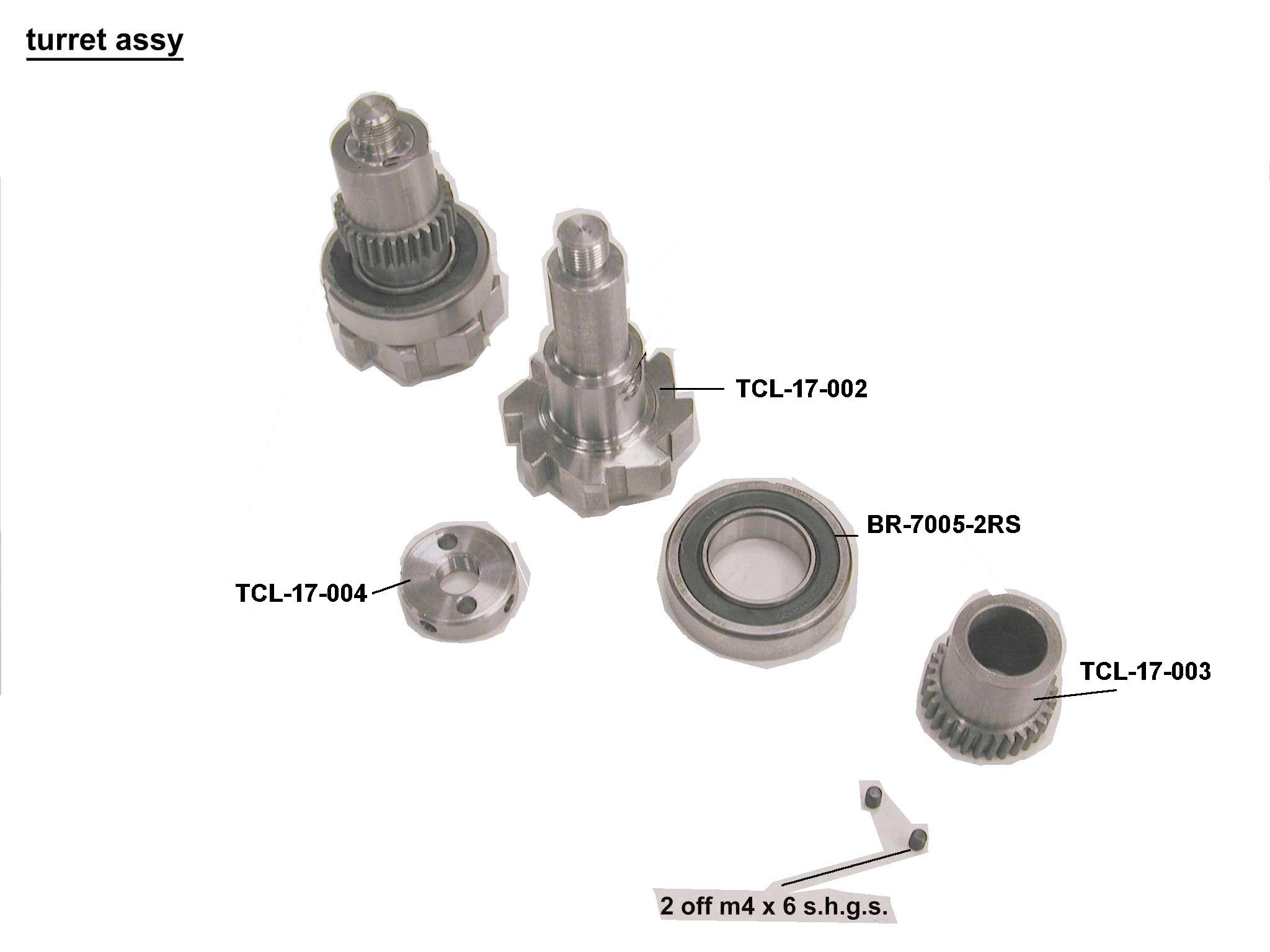

    Hi
    Not sure if you can help or not but I've got the same problem you had with the turret gear, I've bought a new gear from boxford but just wondered if the gear is timed up to the turret station stops in any way or is it just placed on the shaft with the gear teeth sitting any place you want, I'm assuming you have bought a new gear also and repaired the turret as apposed to buying a new one as they are so expensive?? Any help would be very much appreciated,
    John
  3. #33
    If I remember correctly the shaft had a key way in it. To locate the gear.
  4. #34
    Quote Originally Posted by DrBrodie View Post
    Hi
    Firstly thanks for your reply,
    Sadly no keyway whatsoever on mine it was secured in with two grub screws at the end face of the shaft. The issue with this is I would need to drill 2 new holes and tap them to secure it again this way.
    I've had a look online on boxford website and they sell the grub screws and the gear has no key way slot in it so I assumed all must be done that way??
    John
  5. #35
    Quote Originally Posted by John wilkinson View Post
    Hi
    Don’t remember having to drill any holes. Do the grub screws go through part 17-004? If you haven’t solved it I can be more help next week when I’m back at school.
    Neil

  6. #36
    Morning Neil
    No I haven't solved it as yet, the grub screws go through the face of the gear and the shaft it slides onto, so the holes are drilled, then tapped, half of each hole on each part so I suppose it is a kind of keyway, so when the grub screws are screwed in this would then be the keys to stop it from spinning on the shaft, I had a look at the photo you put on a few years ago and it does look like it was the same set up
    John.
  7. #37
