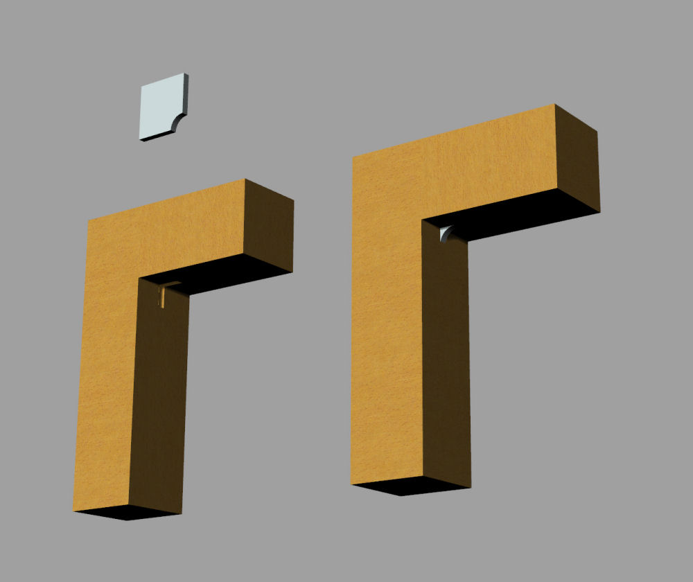

    Or you could make your own 'scratch stock' from an old hacksaw blade

    Eddy , thats the baby ! I'll try and find one on ebay.. :)
