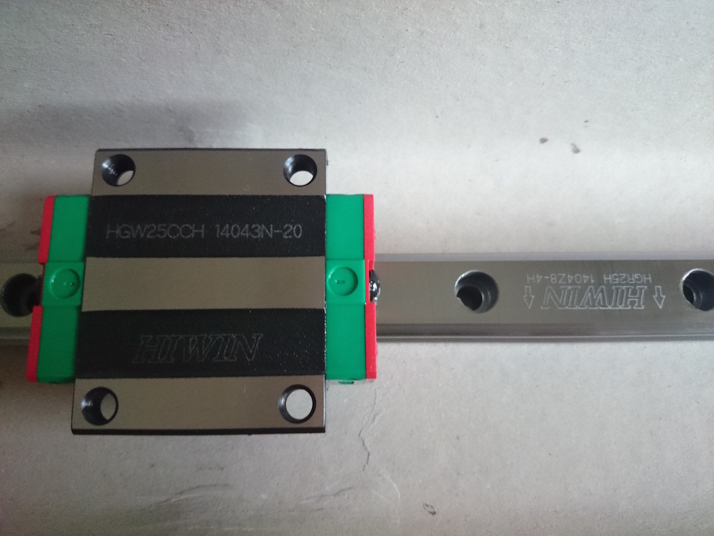

    Sorry it took me this long to report back on the cheap-ish european source for Hiwin rails, cnc-store.eu, but everything worked out great. Delivery and processing was really fast and communication straight forward. I started out ordering two 50cm HGR15H rails and the first two of four HGH15 wagons to fit my massively oversized Z axis ball screw, upon arrival their size chocked me, tiny little things. So for my main order, the x and y axis, I went with HGR25H rails and HGW25 wagons and now having just recieved those I am again chocked, this time in reverse :) They are massive with a build quality that for my limited use should last very close to forever.
    All of the wagons come preloaded and do indeed require a bit of force to move, now I just hope I'll be able to build the machine with the accuracy in alignment that they will require...
    Included are two pictures, the packaging itself deserved to one of those as it was very impressive. Heavy cardboard stapled to a wooden board to resist beding in transit. Very nice job!

    Too late now but I think you should have got 20's all round. The 15's are a problem to get grease into but if you find a good solution please let us konw.
    http://www.mycncuk.com/threads/7273-...highlight=hg15
  9. #19
    I agree, 20's would probably have been a better fit for a 150x150 machine, thanks for letting me know about the greasing issue.
    Have you noticed any considerable wear in on your hiwin setup, things sliding easier I mean?
