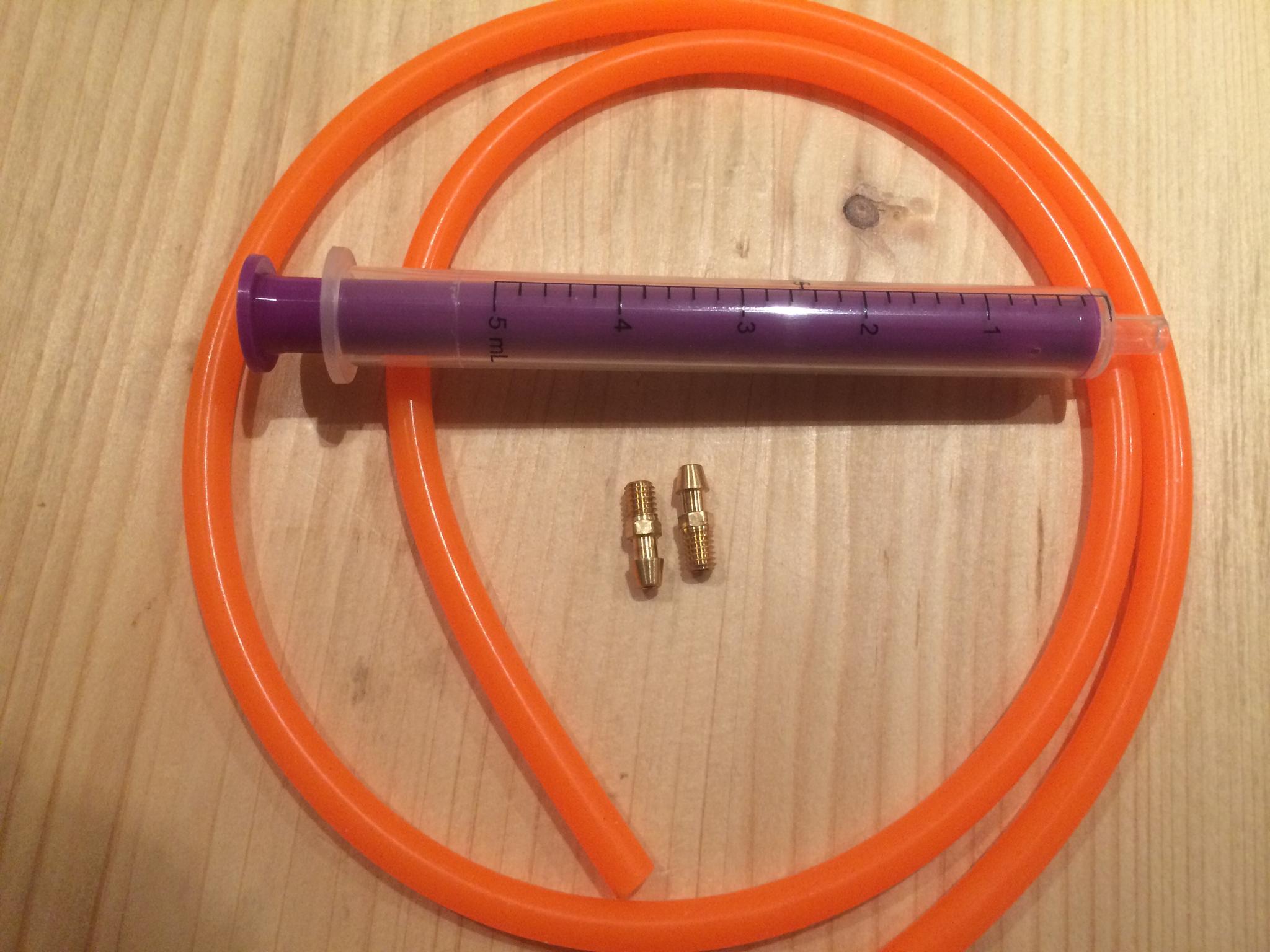

    Too late now but I think you should have got 20's all round. The 15's are a problem to get grease into but if you find a good solution please let us konw.
    http://www.mycncuk.com/threads/7273-...highlight=hg15
    I set out today to try and solve the grease problem on the hg15 and I think I may have done it with a little m4 nipple some silicone tube and a syringe to inject the grease which I plan on warming up first so it's a little more liquid. I will report back tomorrow when I give it a go.

    Through the rail. Drill the rail and set up so, that when the carriage is over grease goes in through the rail hole.
    I don't fully get what you are saying. It's not so much access, although there is little clearance between the nipple and the base, it's because of the non standard nipple design and finding the right end for a grease gun.
  8. #26
    The principal works with the nipples only thing I'm struggling with is that the grease is quite thick and very hard to pump in with a syringe. Is there a thinner type of grease I could use or something I could mix it with even if I have to do it more often. ? At the moment I'm just trying high performance lithium bearing grease class2
  9. #27
    Quote Originally Posted by charlieuk View Post
    I use this method all the time on hard to reach areas, even with 6mm nipples. Don't mess around with a syringe buy a small grease gun. Then put standard 6mm nipple on one end of pipe with threads inside the pipe and 4mm nipple on other end with nipple inside the pipe so can screw into bearing.
    Then just connect 6mm to grease gun as normal. You'll need to wire the pipe to the nipples else the pressure blows them off.

    Think what siliavski means is drill the end of the rail along its length offset so you don't intercept a securing bolt drilling, then drill down from the top of the rail to intercept the hole, drill & tap the end drilling for a nipple, so home all axis and grease six nipples, never seen the 15mm rails up close but you might be able to get a 3mm hole in it & that should be more than adequate for wheel bearing grease.
    Mike
    Mike
    Thanks Mike (and silyavski) I understand that now and it sounds like a good idea. Both ends of the rails would need to be drilled.
    The important thing is where to drill the exit hole in the rail, need to study some diagrams or remove a bearing to see what's best, maybe it needs more than one hole in order to reach all the races ?
