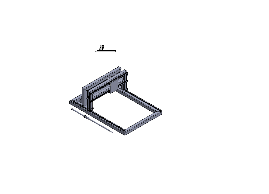

    Hi Vagelis
    In the meantime I looked at your photos of your frame- i think it is nice and strong.
    I would go with 80x80x4 or where the rails are 80x80x8 but i want to use only one size of profile.
    2014.11.16. It is the day when I started the planning of the machine.
    The Z axis is the easiest as Jazz suggested to you- I also going to put the carriages to the fix plate.
    For the X axis frame I try to plan a strong frame in frame solution against torsion.
    C would be ideal for placing, fixing all- will see later. I do not want to mix the profile and the final design should be aesthetic too. Not for comment yet, just sign

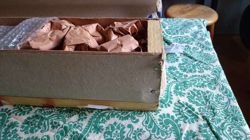

    Sorry it took me this long to report back on the cheap-ish european source for Hiwin rails, cnc-store.eu, but everything worked out great. Delivery and processing was really fast and communication straight forward. I started out ordering two 50cm HGR15H rails and the first two of four HGH15 wagons to fit my massively oversized Z axis ball screw, upon arrival their size chocked me, tiny little things. So for my main order, the x and y axis, I went with HGR25H rails and HGW25 wagons and now having just recieved those I am again chocked, this time in reverse :) They are massive with a build quality that for my limited use should last very close to forever.
    All of the wagons come preloaded and do indeed require a bit of force to move, now I just hope I'll be able to build the machine with the accuracy in alignment that they will require...
    Included are two pictures, the packaging itself deserved to one of those as it was very impressive. Heavy cardboard stapled to a wooden board to resist beding in transit. Very nice job!
