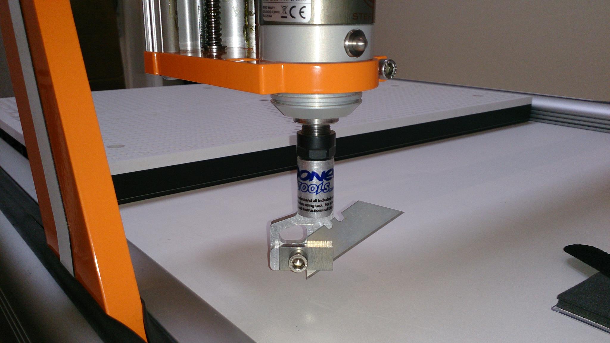

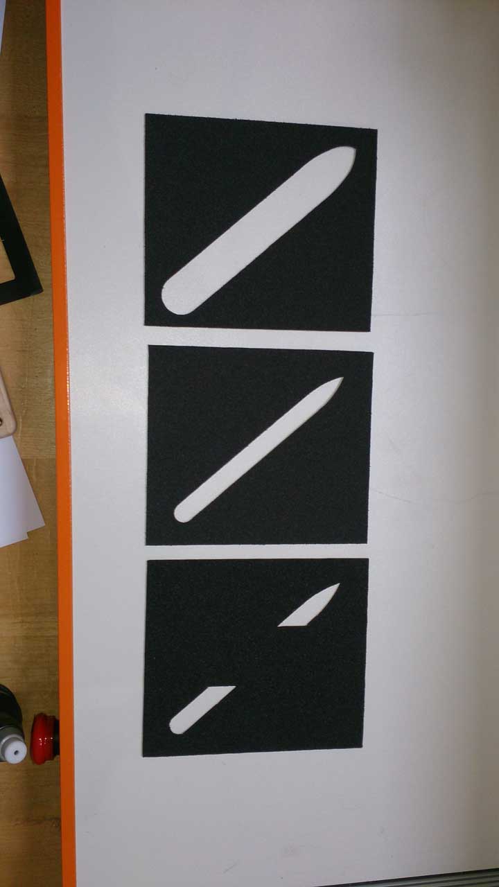

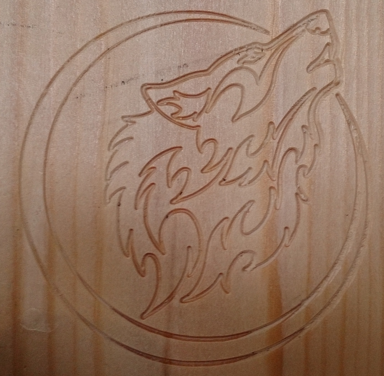

  5. Yes, I've had it for about a year now.
    And I've been using it a lot more than I expected, though almost all in cutting foam, paper and card (I use the Donek D4 dragknife and a Stepcraft vinyl cutter).
    I have also cut wood and MDF (using Stepcraft's 500 watt HF spindle and the Kress 1050 FME-1). I have not tried cutting aluminium with it, but have no reason to think it wouldn't work, within its limits of course.
    For the money, I feel it was a good option. It is supplied in kit form, and while the build largely went smoothly, even though I am quite experienced at building stuff there were a few glitches. Support from Rory of StoneyCNC was superb, and utterly invaluable throughout the process - if you're buying in the UK or EU I would buy from them without question. Nothing too major, though, and the machine has been up and running nicely since then.
    The only thing I've found is that some play does work its way in over time, and it needs periodic maintenance (probably every 30-40 hours of operation) to tighten things up to correct it. Once you're used to it, not too much of a problem. But in general the Stepcraft has performed well - it's reasonably accurate, easy to use and maintain, and has done the job I bought it for brilliantly. However, it really is for light use - it would not perform as a production machine, working continuously all day every day...
