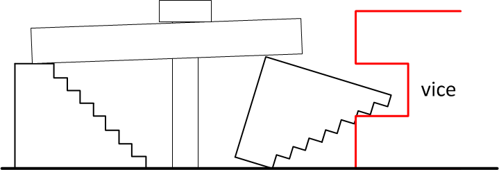

    To be honest the clamp shown in the photo you provided is a far better option and just needs on hole drilling in a piece of plate that can be done on a pillar drill. The type i described are so easy to make also, i have 4 that i use in conjunction with various lengths of stud iron to clamp stuff to my lathe cross slide when jig drilling holes ect, pack the ends with some coventry die chasers.

    You could use a stepped block, I'd hazard a guess they were suggesting something like this, though you'd need to experiment and you may need something under the back edge of the upturned stepped block to force it to rotate down onto the vice.

    You don't use the stepped blocks like that, you would just use the one on the end set to the appropriate step height.

    Just thought i would add before i get corrected, re stepped packing blocks.
    they are actually designed to be used as a pair leaving you with a parallel surface to clamp off and so they are usually used on tall jobbies so are not really suitable for your application, was not being pedantic.

    Yes I know, I wouldn't use them like that either, I'd have just made some new dogs out of 10mm plate. I was trying to second guess what arc had suggested to the OP!
