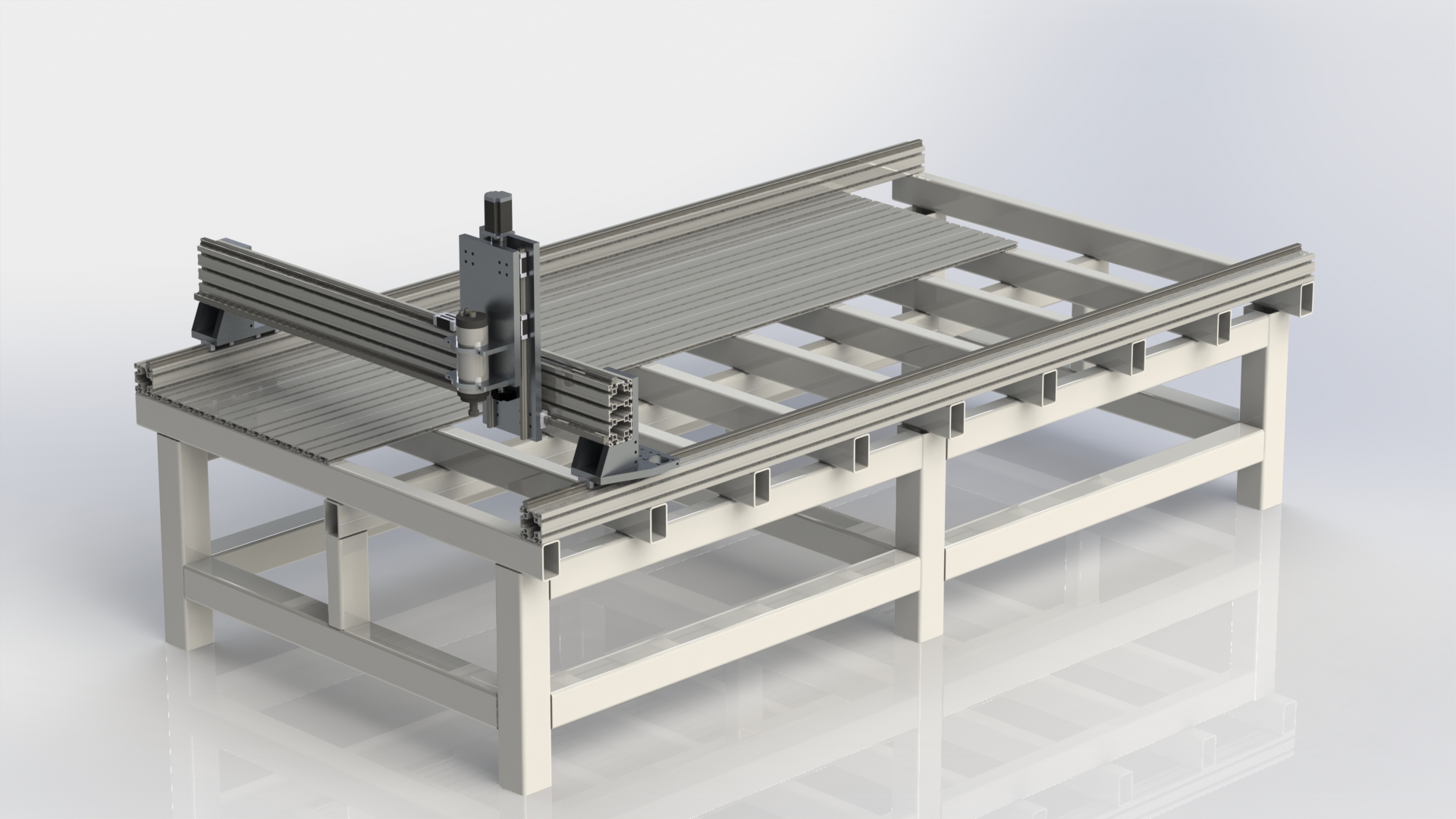

    OK ive managed to get a little more done this morning before the wife started chewing my ear.
    Fingers crossed if all pans out, i can have the frame uilt for friday and into powdercoat for saturday/Monday.
    Im thinking about servos on the X & Y and a leadshine on the Z. any suggestions?

    Best advice with regard to Z axis is to put rails on front plate, bit where the spindle mounts, and bearing blocks on back plate, i.e. opposite to what you've shown.
  7. #17
    Is this to make it more rigid..? From the commercial ones ive seen they are all mounted like this. as i thought with it being the Hiwin rails with less play than the SBR stuff

    I would wait for conformation off one of our more experienced members but i would think the Z needs to be on the other side of the gantry so it is better centered over the X axis bearing blocks.
    Mike
  10. #20
    Yeah ive been thing about this myself, The setup works on my 4x4, however thats only cuttin MDF and light plastic. i have been toying with the itea of vertical ones on this one, but the side to side motion worries me as im not connecting the gantry under the table.
