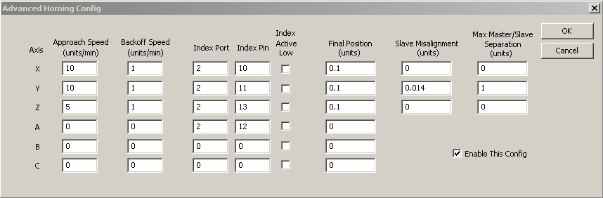

    Good to hear that the IP-M will support slaved motors soon. If that had been the case 12 months ago then i'd have jumped on it rather than the PMDX/ESS combo.
    For reference though, the last few plugin versions for the ESS (ESSv10r2d1d being the latest) support misaligned home switches. You can now apply an offset in the 'advanced homing config' dialog rather than having to physically adjust the switches.

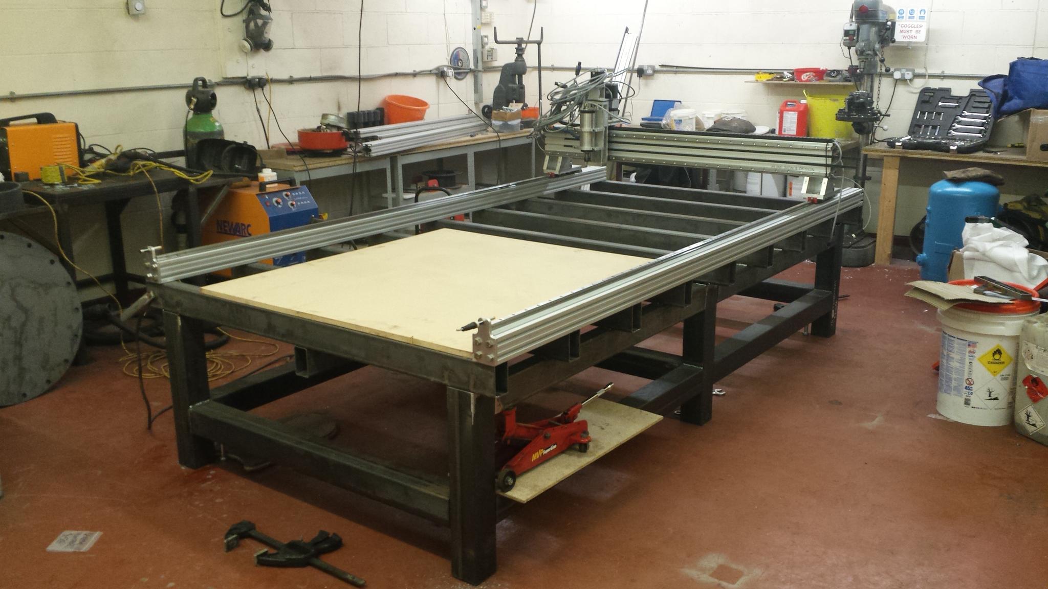

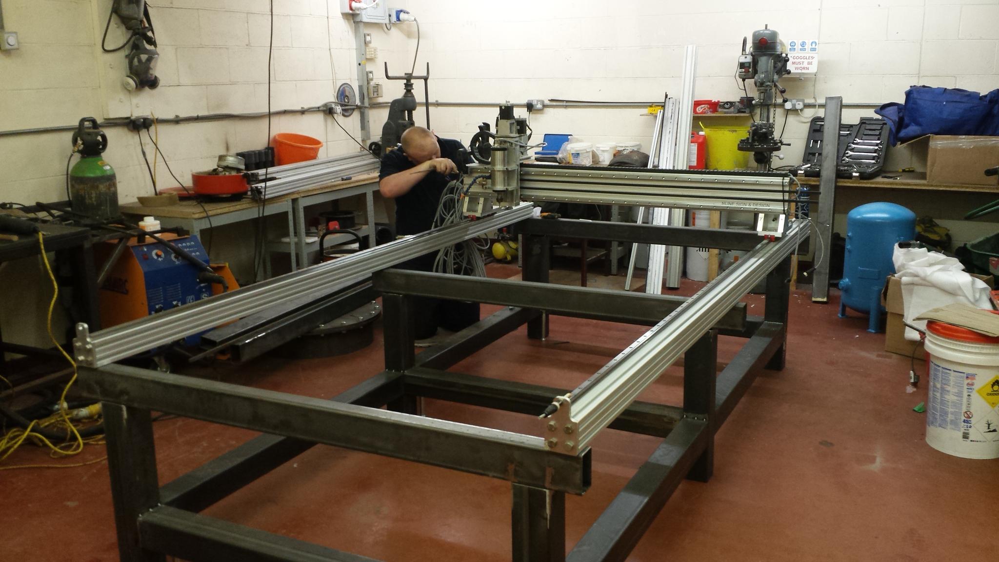

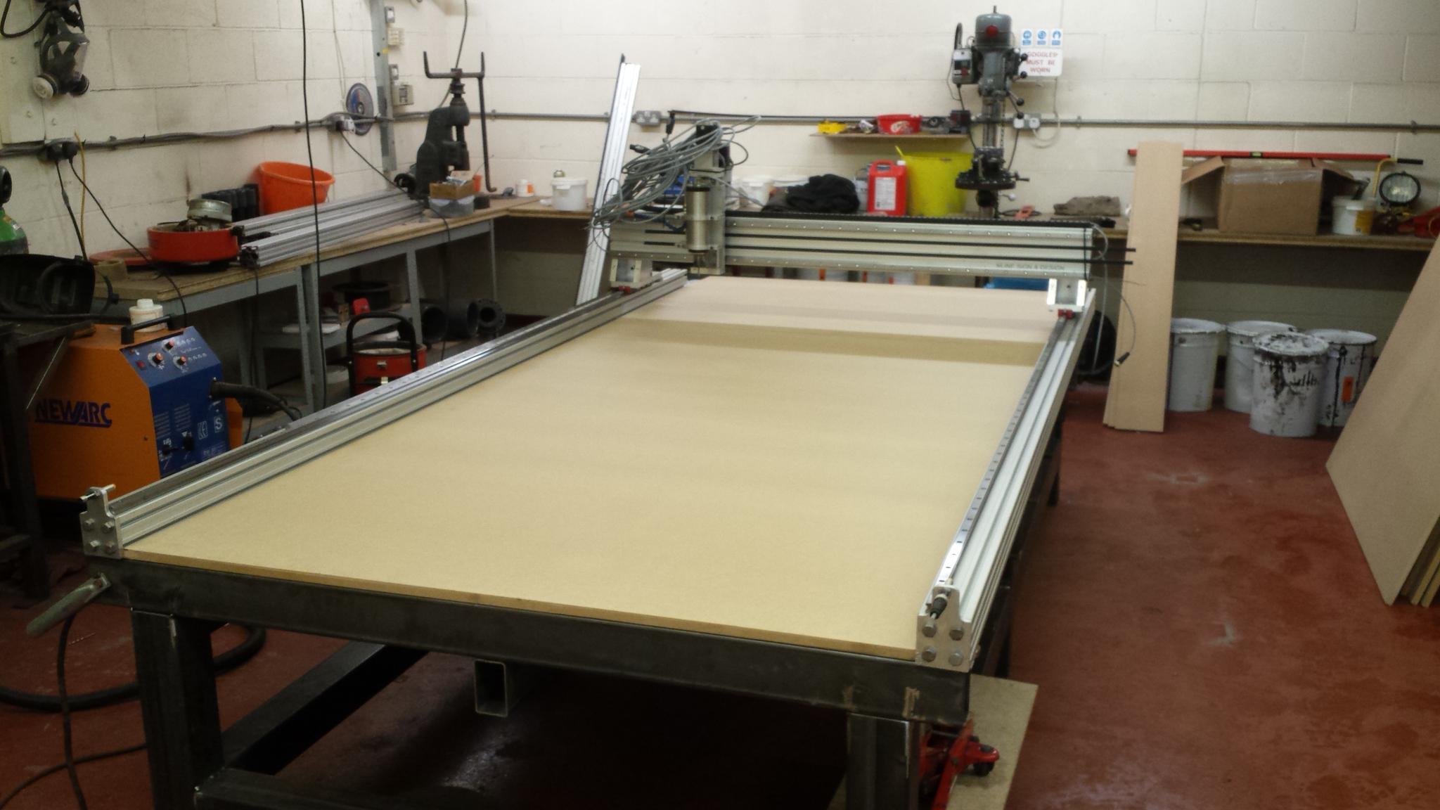

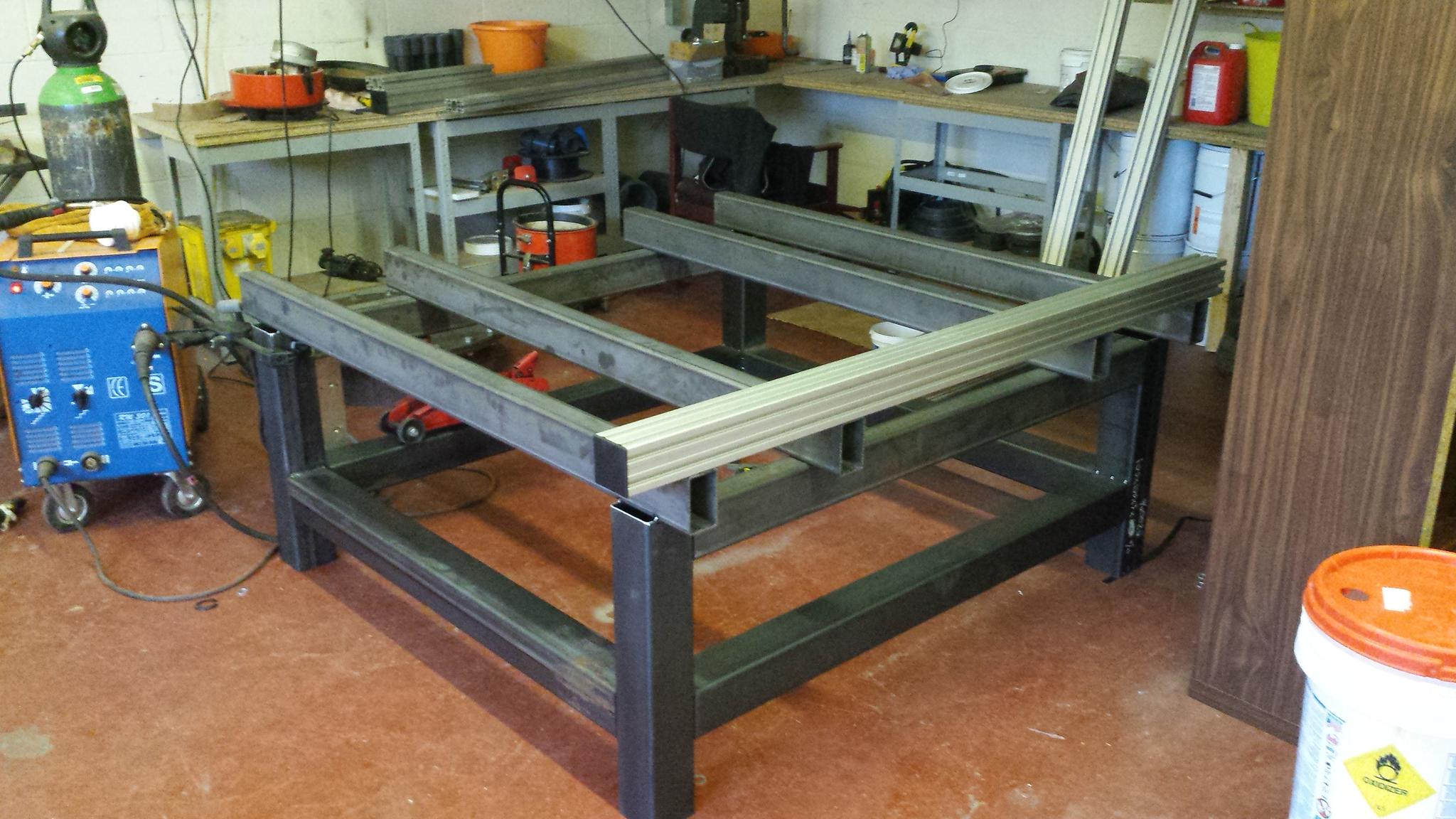

    Well, I've managed to get a good start on the machine over the past couple days. This thing is solid!

  8. #47
    What a beauty. My heart warms looking at big steel structures
  9. #48
    Thanks, I have the same warm heart feeling haha gets warmer when I try and move it. Haha
