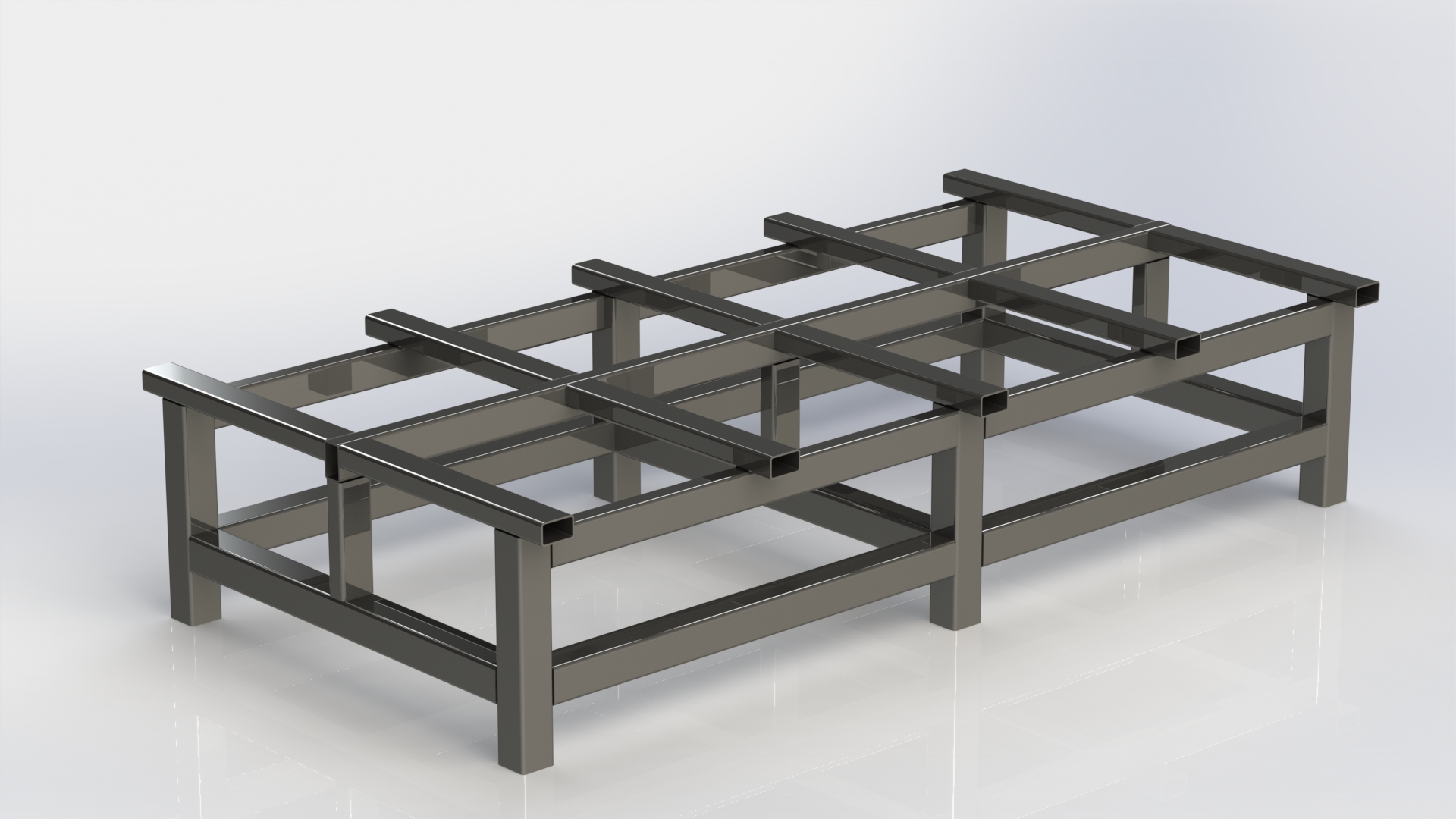

    OK so... We start off with a nice and heavy base.
    Base is constructed of 100 x 100 Cold rolled box section for the main legs and 100 x 60 on the base table.
    80 x 80 Extrusion will run alone each side of the table with smll slots in the box section to allow for slight adjustment. then locked off with angle brackets
    Im still not sure if i should lose the leg in the centre to allow me to run a brace under the table to help a little more to aid the crabbing of the gantry. this will also open up the possibility of using rotating ball nuts in the future.
    Over complicated derek with not enough support for the bed. The spacing of the cross beams is too far apart and I would make them full width and support from under side.
    Less is more.? Go bigger on the steel structure but have less of it. Check this out to get an idea what I mean.
    Now. you have really threw a spanner in the works! after seeing that i just want to buy one outright! haha
    In terms of not enough support, shall i just run the crossmembers striaght through as you say? i had planned on putting an Ali extrusion bed over the top of this also...

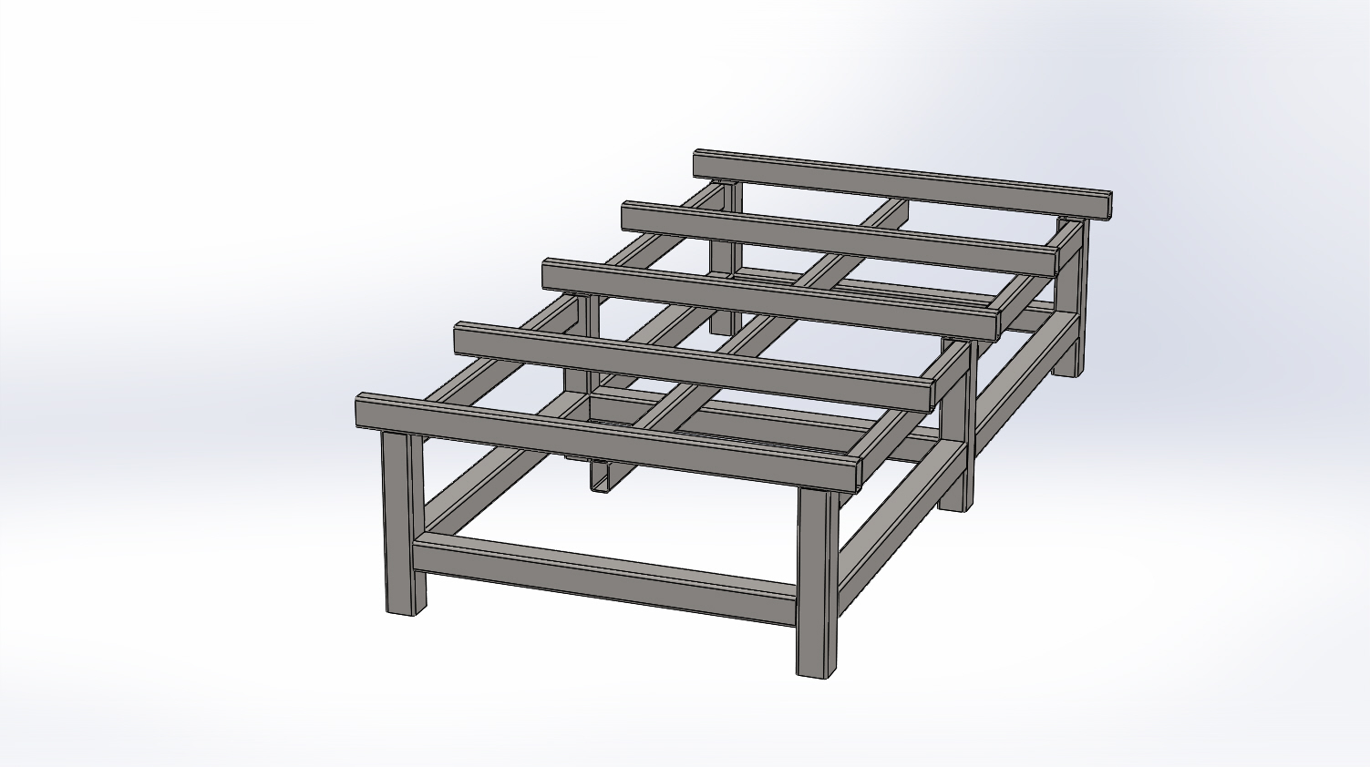

    Is this what you had in mind?
    Ive turned the bed supports vertically to give a little more support and transfered the long one to the bottom to support

    Yes and No. Yes to one piece supports but the spinal beam needs supporting from below not just fastening under the bed supports as that's doing nothing really.!
