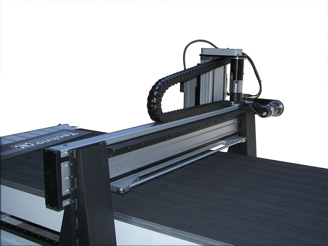

    I dont suppose anyone knows what this bar is for on the bottom of the gantry of the Techno machines do they? Im guessing that when its tightened it pulls it square of some sort?

  8. #18
    Nevermind ive found ou what it is
    "a special steel backing beam and torsion bar are integrated into the axis for added stability. The torsion bar acts like a sway bar on a vehicle, which in turn keeps everything straight and taut when cutting loads change. The steel backing beam provides extra support to the linear rails, greatly improving the router's rigidity."
