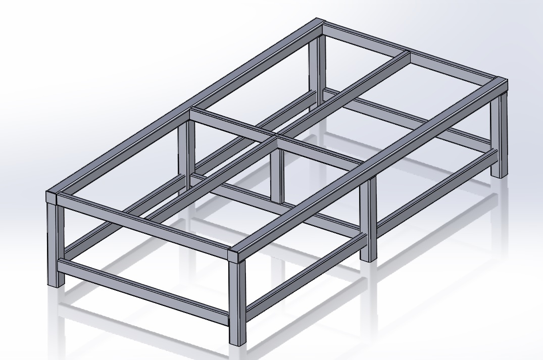

    Best advice with regard to Z axis is to put rails on front plate, bit where the spindle mounts, and bearing blocks on back plate, i.e. opposite to what you've shown.
    Normally Eddy I'd 100% agree with you but with such short travel then no I'd go with something like how it's set out now. Thou I would have the bearings on the front plate lower with next to no overhang and extend the spindle down in the clamps. This will give full support to spindle/front plate from the rear plate.
    If longer travel then I'd set it out other way.
    Derek I wouldn't mix servos and steppers and go with same on all axis. Not that they can't mix but it keeps electrics all the same and there won't be much difference in price. If your going with servo's or even steppers for that matter then suggest you get a decent motion control card. Definately will need one for servo's to get decent performance out of them.

    One more thing with frame I swap the sections around and make couple of length changes. I'd use single piece top rails from square section and rectangle section for lower pieces see pic to see what i mean.

    Nice on Dean, I had originally drawn something similar in, but I was wondering if the extrusion would sit level incase a bit of warp creeped into it.
    The way I have it I thought may compensate for any un level beams or warping

    No I wouldn't have it like you have at really because any bending or warping of the cross beams will directly affect the profile and rails and take away accurecy. I drew it without the cross beams more to show the single piece top rather than 2 pieces but other than that it's meant to be just same as you drew it.
    I wouldn't do it your way at all because it will make getting rails on same plane harder and any movement of cross beams will directly affect profile. The surface bed sits on isn't so critical as you will surface the bed parallel to the spindle but the surface the profile/rails sits on must be flat and on same plane each side or allow for the profile to be adjusted onto same plane.

    I'm not sure I follow what your saying pal... I understand removing the vertical from the centre and putting a cross base in as the sides. Are you saying not to use the 9 cross members on the top now? If so what would be the best way to mount the extrusion
    Ok well seeing your other post about already ordering stuff and the fact I can't be arsed to explain then just crack on. . .Lol
    The controller you want for servos is the IP-S because of it's much faster frequency that high count encoders require to get the best from servos.
    BUT just for clarity then the latest IP-M Beta Firmware now does slaved motors, all be it in a cut down way to the IP-S. (I haven't tried it yet so can't vouch for how well but I will and report)
    The way the IP-S handles slaved motors is different to typical way slaved motors are done with other controllers in that when it hits the switches it's got an option to measure the difference between each switch contact then applie an offset movement to one motor to square the gantry. That said with servo's you'd home using the encoder index which is much more accurate than switches but it works well for steppers without encoders.
    Other controllers like the ESS require you to manually adjust the switches to square the gantry.!
