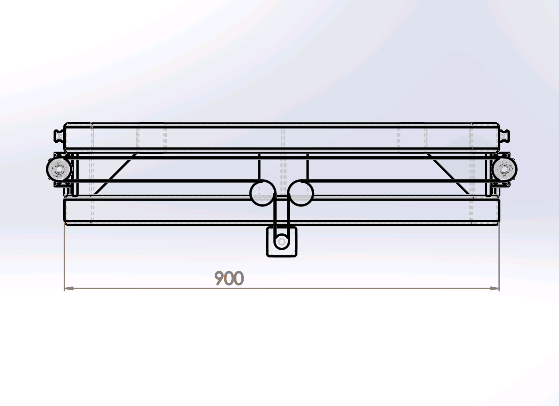

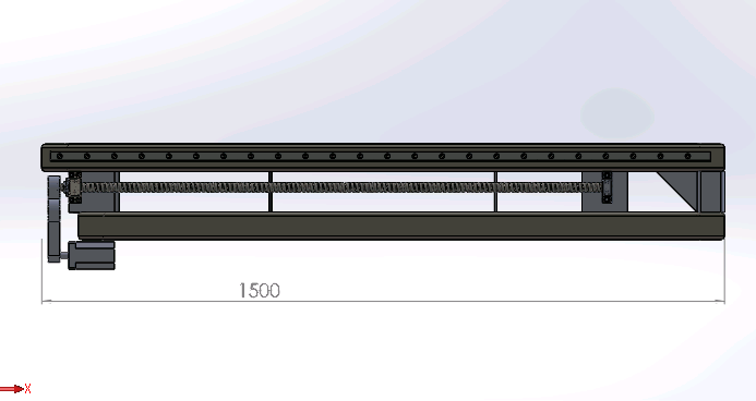

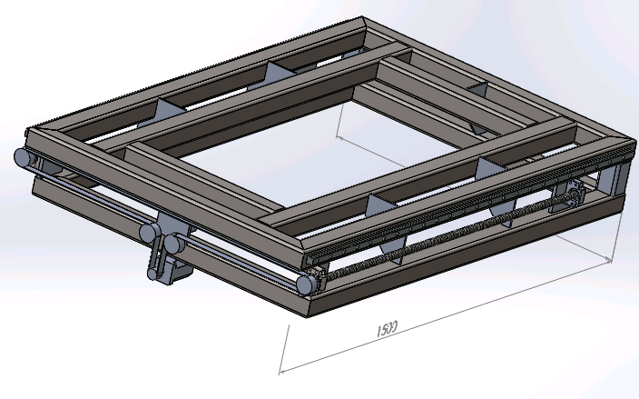

    Now i am looking back at your gantry design. What size are the profiles, why 4, why are not connected each other? Whats your idea there?
    I will go on with the Fix gantry system because it is properly fit to my goal -the moving bridge is a big advantage and present for me- so I am not restricted with a fix bridge height.
    However I do not want to cut this line and leave it this way.-probably I will make gantry with this principle too.
    Some draft are attached with the gantry base solution.
    I prefer to save the expensive, vulnerable parts
    balls crew rail , belt drive so I tried to hide them next, behind or under the frame -I belive this is the best place for them against the impact of
    -work piece uploading
    -chips
    -coolant
    The other view is to apply the roof trusses principle where incredible small profile in a certain arrangement can form a very strong element.
    In my dwg the three SQtube run along he perimeter tying to each other with reinforcement plates.
    It is a pity I cannot check and compare the different version with software so only suppose it gives big torsion resistance to the frame

  6. #45
    Looks good but you might need a bit more triangulation. The thin gussets only work in one direction so ideally you need them in equal amounts in all 3 planes.
    Why is there a bit gap in the middle?
    What rails are you using? There are different types and some can handle 4 way loading and others cant so are best mounted on top of the rail. Espesially if you are using a heavy moving gantry.

    Hi Vargai,
    so you will go with moving gantry right? The way you have drawn the rails looks ok, but how you plan to straighten them and make them parallel?

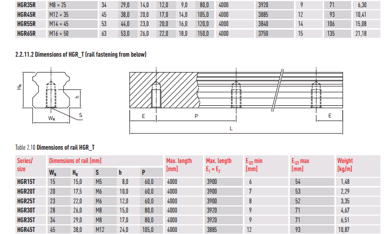

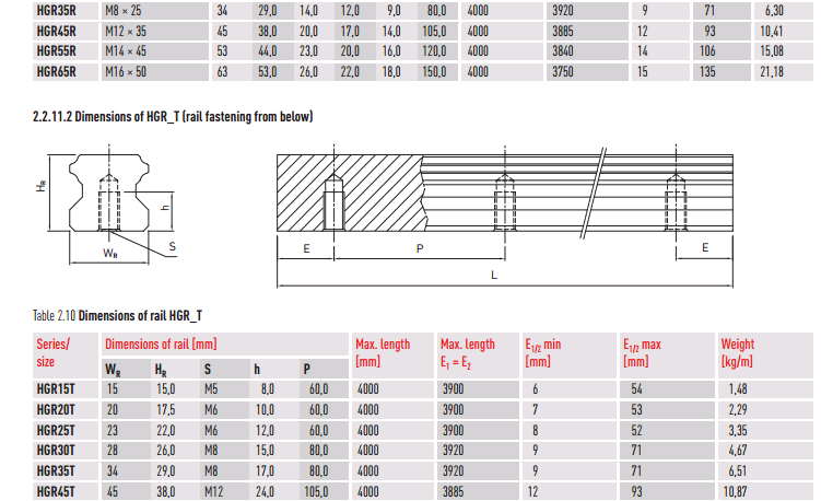

    regarding the rail I would use one like this which is regular type now
    The problem is as you pointed to it at my case only the upper row of ball hold the load but the moment resistance is good that occurs at start-stop and direction change
    I have no experience using it but suppose it works -the catalogue also mention it as possible mounting arrangement
    Because of my 100kg+ heavy moving gantry I have drooped this design and go with fix gantry where the moving Z will be balanced

  10. #49
    The Hiwin HGR are double row bearing blocks and there is no difference how you mount them, so don't worry about that.
    For a router HGR20 is enough and even a bit overkill, depending on the design. So no worry here also.

  11. #50
    Ok, I'm a bit confused. You keep saying fixed gantry but then you show a bed with rails on the side.
    Is this the bit that will be moving? If so I would have said that it is not the best way to do it. Moving beds should have the rails underneath and at approx. third points or a quater in.
    That way the rails are supporting the load better and are closer together so you can get away with one ballscrew.
    As you have drawn it the bed can bend in the middle under load.
