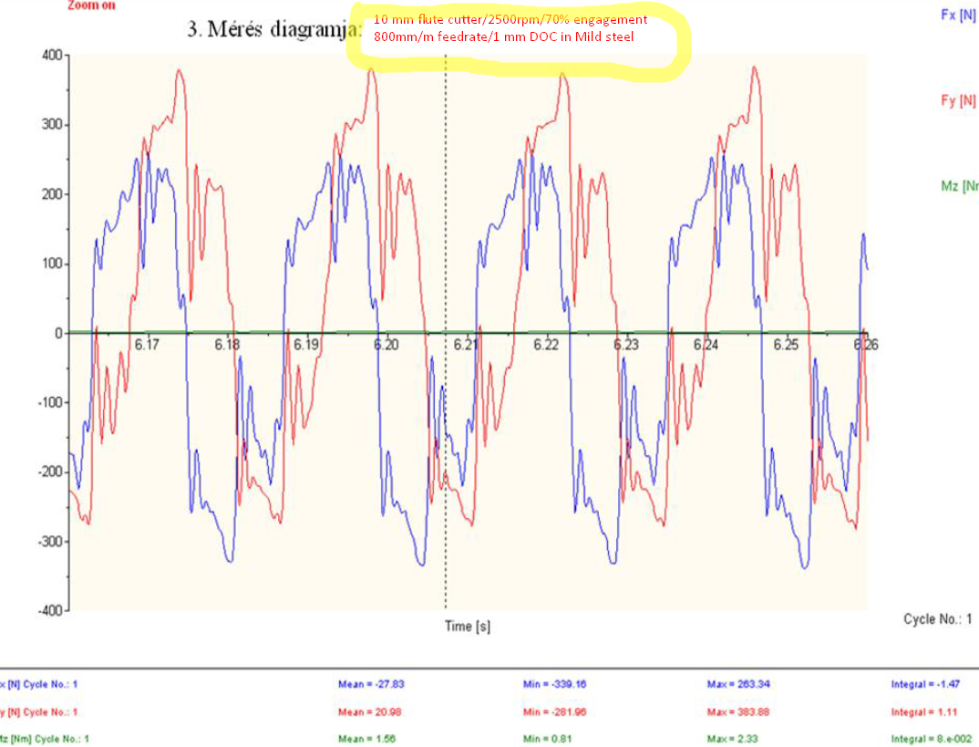

    I have downloaded some kind of study about machining force and my
    goal on 1000 N is not oversized requirement. I hope I can use max DIA 10-12 mm with moderate technology and dia 30-35 face mill on same way.
    The machine will give the right answer and I will give a "reluctant" acceptance to it. I do not care if some work take a while since I will use this machine on one off and small batch production. With good strategy and preparation I even can compensate it but not bother if not. I have a day time job so it will be a free time profitable passion.

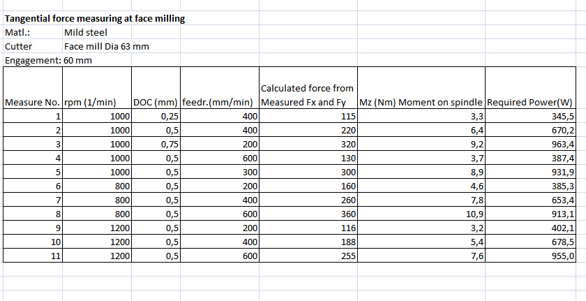

    Could you post a link to that cutting data? Some quote the force required to cut the material and the tangential force seen by each axis can be much lower. Those figures seem a bit high. Unfortunetly all my reference material is on my old pc so will have to dig it out.
    What spindle do you plan to use? To a certain point the more powerful the spindle the lower the cutting force.
    Thank you to correct me. I have just referred to it by heart and of course do not want to propagate false data
    Here is the link and it says 40-50 N
    http://www.ijens.org/103004-5151%20IJBAS-IJENS.pdf it is talking about HSM milling but use 1000rpm for this test ??
    200-400 N is from a college measurement protocol where the matl is mild steel
    the first is 10 mm flute mill
    and the follow is face milling in mild steel
    Sorry for digging too deep but I am confused about the new present day parameter used in Ali.
    At my former job we machined Ali 20% of total and used empirical values in technology heard from colleagues and the owner of the shop. On that Hurco VMC we used max 4-5000 rpm (4-12mm 2 flute cutters) and as I see this is the lowest on router. Could you tell some practical values according to table above? It is not complicated but I am not confident in machining calculator but more familiar with practical data.

    When I look at the machining forces in the above post I think with 1000N one can provide acceptable performance in steel too acknowledging that this is not an intensive material removing machine.
    Building a frame with resistance to this forces not impossible challenge and I am sure your yellow one is pretty stronger. Still believe in the above size the fixed gantry with improvement fits to my goal but I will study yours and Jonathan's .
