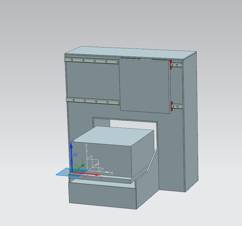

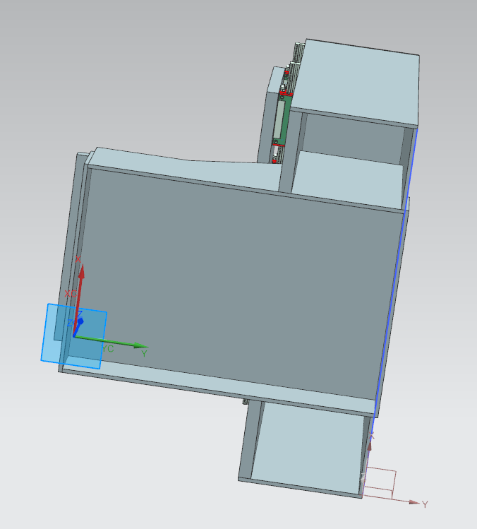

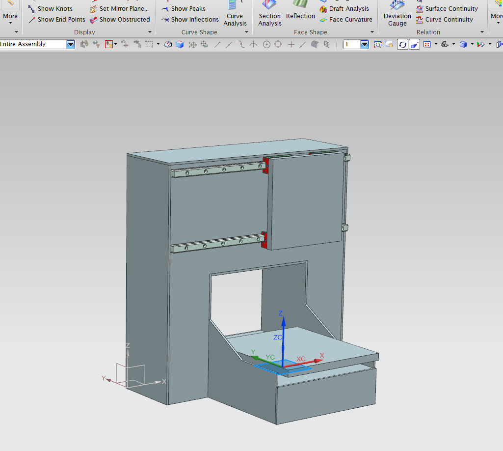

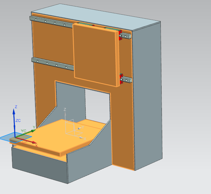

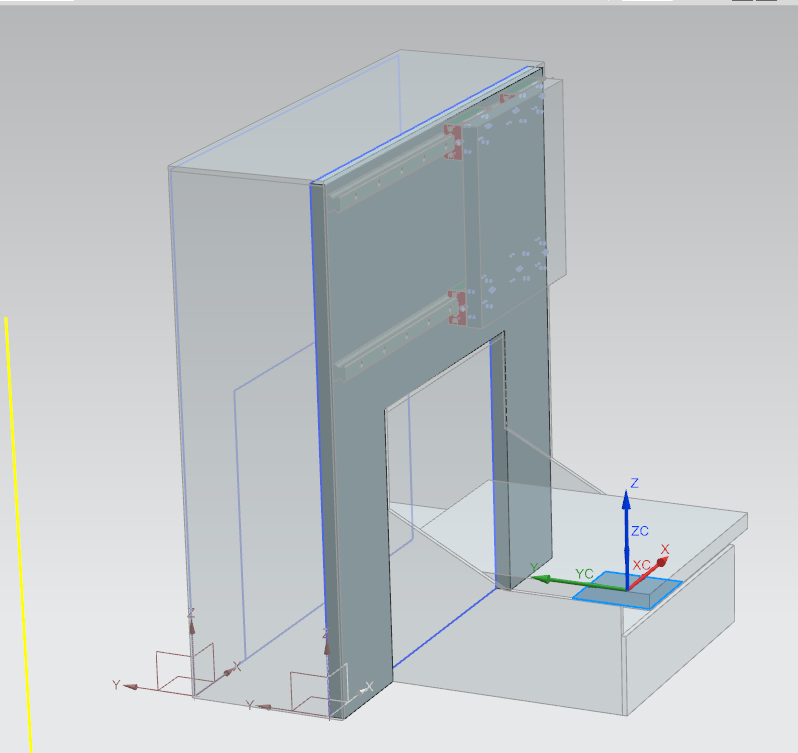

    Some pictures where i am now, as i said still in sketch form:
    On picture 5 you can see in yellow all the plates that are 20mm thick. All rest is 6mm. For now.
    The working area for now 300x300x150, the gantry is 200mm deep x 600mm wide, the gantry legs form 140x200mm each
    Now without the working area shown
    The motor moving the table will be down inside
    the 20mm plates in yellow. All rest 6mm for now untill i do the last calcs when the design is finished. Anyway, structurally there will be no problem.

    Does the Z plate really have to be that wide ?
    Depends. I want to be able to fit even 80-100mm OD spindle, not only the 0.8kw which is 65 mm. But its all together. Not only the Z. Depends what Z design will use, depends on how the electronics will fit inside.
    But i am glad Eddie, that your first question was about the Z, that means that may be you see all that doable.

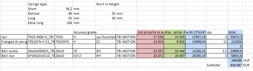

    At first sight seems under estimated with this graded element.
    I have updated my TBI calculation to this set up to rough comparison and think only Hiwin with adding factory made bearing will reach about the 1K EUR.
