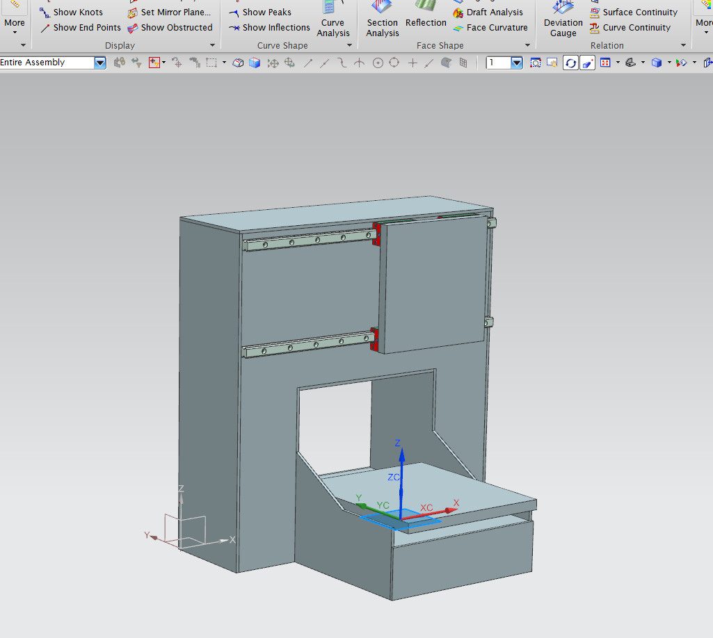

    now that i have build one and meanwhile building my big beast , couldn't help but start to design my next project.

    -to be so rigid to accept from 0.8kw to 3kw spindle / why not even a small mill spindle/
    The way to do it:
    The design. This is the key..I believe it could be done. So let me explain some points here.
    -Working area wide X300mm and Z150mm. The length Y will be 300mm. The machine will be designed so that it could be easily scaled up to 400mm wide and 600mm long.
    The key here is not be working are hungry but to make all things properly. Other very interesting objective of mine is to design in CAM like fully parametric solid model. Which means sb says, hey i need 300x400x160 and i for a minute generate him the detailed drawing.
    -all alu plates will be 2D cut, faces for rails milled for easy alignment. No holes or bolts on the thin sides, 2 plates will be mounted together via square bar inside. This is one of the 2 most important parts. No flipping aluminum sheets, drill, profile, pocket where necessary and that's all. The second most important idea is that this will lead to fast assembly. Thats the purpose-machine to be fully assembled from scratch for a day. So no steel, no paint and so there.

    Now isn't this important. The gantry will be fixed. I gave a lot of thought and that's the proper way i believe to do it. Not only this but is made from 20mm ali plate that forms a box with another plates, for now 6mm, ribs will be fixed where necessary. When i do the final calcs will see what is the price difference for making all from 20mm stuff and will decide then. For now thats how would be.

    Hiwin 20, the long HA blocks, 1605, 1610 screws and may be even geared for better resolution for ultra fine jobs, cause i don't see how this small size will develop speeds

    Dimensions:
    The idea is foot print of no more than 600x600mm and 600mm high for 300x300x150mm working area. Thats a challenge also but i am almost there.
    The Z plate
    250x250 for now and i believe its a minimum but minimum where still is maximum strong. the bearing spread and footprint i mean, having in mind that we are talking here HA bearings, the long ones 95mm each
    Other
    Now,here is the deal. the electronics will be below the machine or in the gantry or at both places. And one main idea is also the gantry and sides and base to be epoxy fill ready, sand fill ready. So i will spend a lot of thought here. One thing is clear. The electronics will be inside somehow. My machine is like this and there is no problem. Air filter and ventilator will be essential. i know Dean will be the first to say that this is not right. But it must be.
    Some pictures where i am now, as i said still in sketch form:
    On picture 5 you can see in yellow all the plates that are 20mm thick. All rest is 6mm. For now.
    The working area for now 300x300x150, the gantry is 200mm deep x 600mm wide, the gantry legs form 140x200mm each
    Now without the working area shown
    The motor moving the table will be down inside
    the 20mm plates in yellow. All rest 6mm for now untill i do the last calcs when the design is finished. Anyway, structurally there will be no problem.

    Does the Z plate really have to be that wide ?
    Depends. I want to be able to fit even 80-100mm OD spindle, not only the 0.8kw which is 65 mm. But its all together. Not only the Z. Depends what Z design will use, depends on how the electronics will fit inside.
    But i am glad Eddie, that your first question was about the Z, that means that may be you see all that doable.
    project 1 , 2, Dust Shoe ...
    Silyavki, I like your idea and concept drawing and I think there will be a market for an affordable small machine that's capable of some real work. It might be difficult to do something like that on a budget looking at those big alu parts. You might consider using something more affordable for some of the large parts e.g. instead of using solid 20mm plate use two 2mm or 3mm plates epoxied to a 20mm birch ply or even mdf core. A bit more expensive but maybe bamboo ply for core? Make a piece like that and try bending it, you will be surprised how stiff it is. The laminated approach does however complicate some things because you do not have a solid core to tap holes etc but I guess there are good plans to make it work e.g. bolts right true or alu inserts in the wood core were thru holes is not feasible.

    Just throwing ideas in; is there any mileage in this Z plate design ? http://www.cambam.co.uk/forum/index....cseen#msg32687
    At the very least I'm thinking it could be useful as a method of spindle mounting, making it easy to swap spindles or maybe swap to a laser head, etc.
