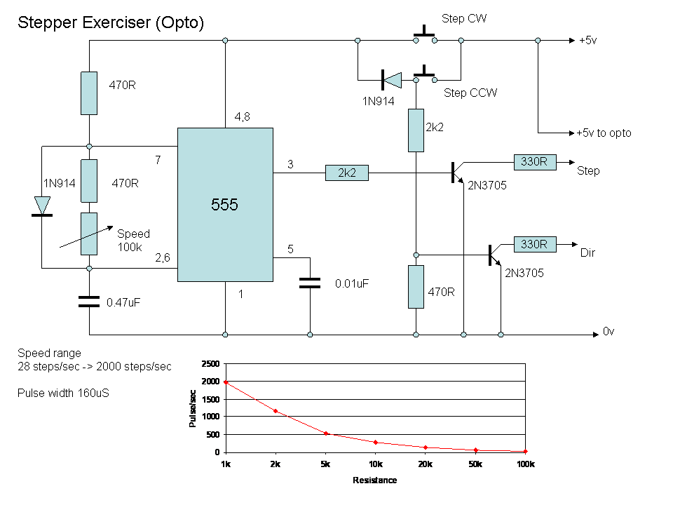

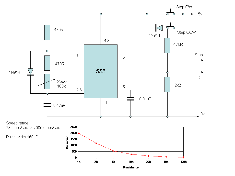

Ross,
Try the attached for size...
If you are driving opto-isolated inputs to the drivers let me know as it'll need a couple more parts...
08-08-2009 #93
Hi Irving,
on the small pic I think I can see the link to the dir out pin but it is missing if you enlarge the picture, I assume it goes to the divider part of the 2 resistors.
peter
08-08-2009 #94
Thanks Irving thats exactly what I was looking for.
For this board I'm going direct to the driver chip but it will be useful to have the opto verision as well if you dont mind. Is it posible to do single steps with this circuit as well :whistling:.
Thanks again
Peter, seems to be ok when I look at it, dir pin is linked to the resistors

09-08-2009 #97
Thanks Irving, your a star. have a couple of beers
The single steps are for fine tuning, I'm planning ahead really. Once it has built the machine I want, this mill will probably be redundant and not worth selling, so I thought that It might be useful if I just need a part skimmed or holes drilled at set distances. If I also fit a DRO of some discription I can manually control the machine as a stand alone without having to draw the part and produce g-code etc. etc.
