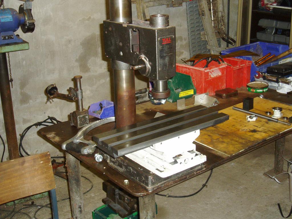

    With the stalemate on the quill I've been looking at the X-Y table, bit concerned with the flex in the 22mm rails and skate bearing arrangement on one side, and then making up some sort of T slot table.
    For £80 I can get a cast iron compound table (not as big as I would have liked) or I can use some of my THK rails, but still need to sort a table.
    Is 8080 extrusion ok for a table if the rails are bolted to it? Still want it to be as cheap as possible but realised that cutting corners still costs in the end.lol

    Ok feed up with messing around and decided to take the advice of you guys (think it was the 2nd or 3rd post) and buy a compound table...:clap:
    Got this one
    http://www.axminster.co.uk/product-A...able-21825.htm
    Free delivery is a bonus. Bit of work and it it should be ok. T slot tables of the same size where the same price, so at least I will have a decent table. If it works I will have only spent £100 as the drill was free and the other tools are useful for other projects
    Extra long tap and suitable bolt also on order. Hoping it will all be here for the weekend.

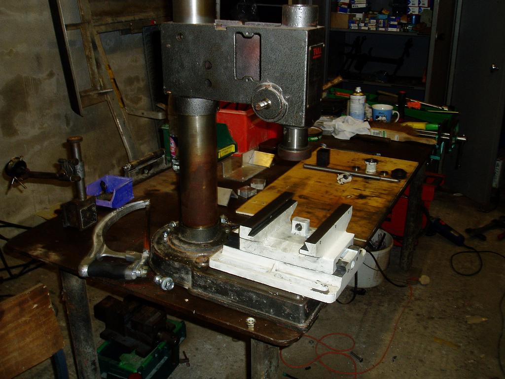

    Compound table is useable after all lot of rework. (Think it was cast, rough milled and bolted togother)

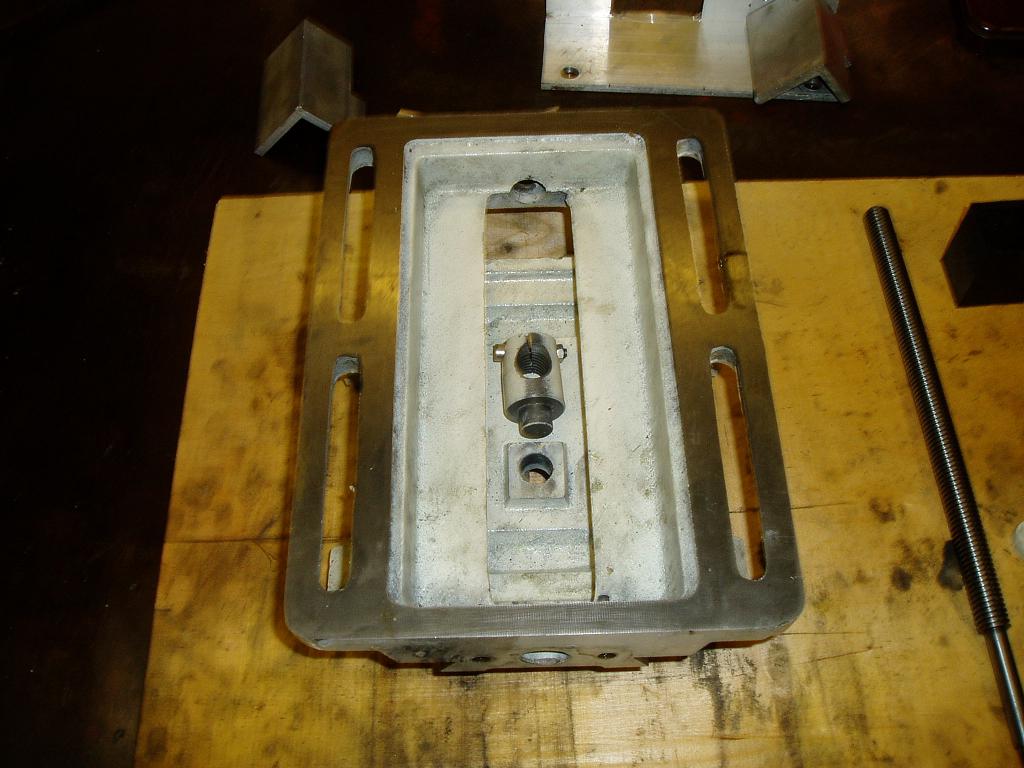

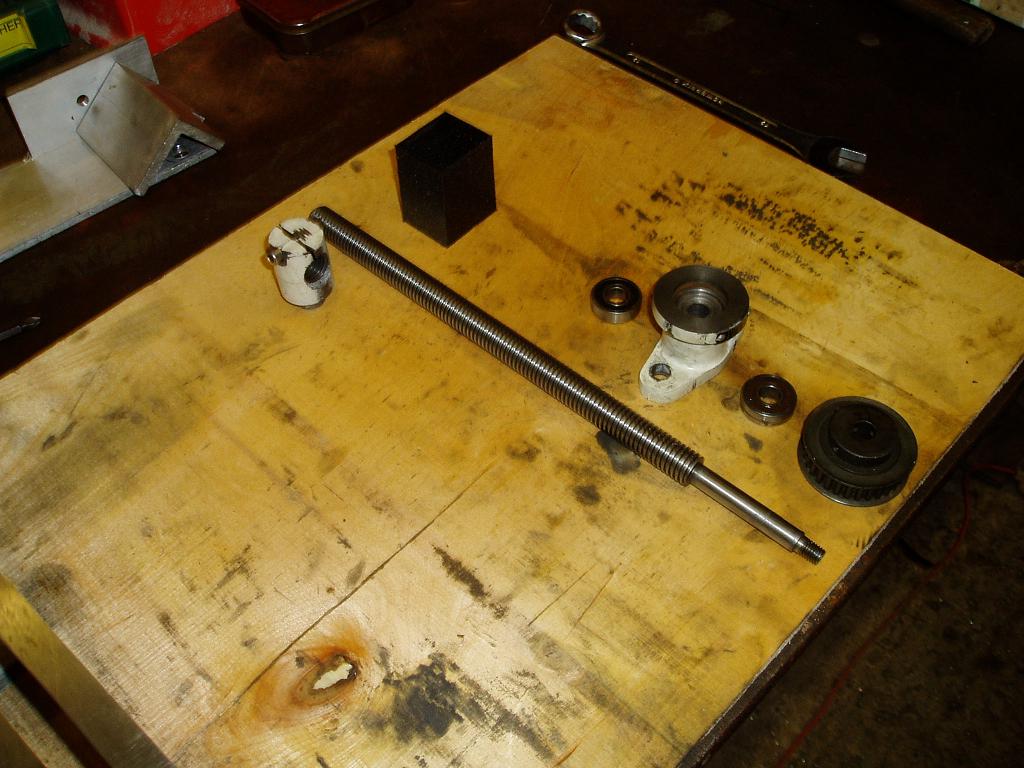

    The bit I'm struggling with is eliminating backlash in the acme screw. I've Cut a slot and fitted a pinch bolt, but as the screw and thread are so rough the friction caused is not good.
    My question is how critical is it to completly eliminate backlash or is the compensation in Mach able to overcome it?
    I can probably improve the current state (about 2 or 3 deg. as a guess) but will take more time...

  5. The bit I'm struggling with is eliminating backlash in the acme screw.
    How about using a Delrin nut instead of the brass(?) one (or a second nut made of delrin to remove backlash)
  6. #56
    Cheers. The originals are cast iron, will the delrin be strong enough on their own if I replace them?
    Wheres the best place to get ready made ones? as the thread is imperial (1/10 inch) Or is it still cheaper to buy a tap and make them my self?
  7. I'd guess they'd be strong enough, although wear rate might be high.
    I think one of the guys on the forum has been making and selling them (I don't know whether he has the correct tap for your threads)
    What diameter are the lead-screws?
    Are the nuts cast in place or are they removable?
    Pictures would be good.
  8. #58
    Ok you'll have to excuse the photos and the state of my workshop. For some reason if i dont use the flash then there not in focus..:cry:
    The screws are 16mm dia. (15.65 on the calipers) and have a 2.54mm lead (imperial 0.1") Cleaned and polished the screw so thats looking better but just noticed the nut has cracked where I have been tighting the pinch bolt, so definetly need a new one, ups.
    The nut on the x axis is removable and the y axis is fixed.
    Ive had a quick look on tinternet and found lots of different ideas but I'd like to know If any one has a tried and tested method, I've fitted bearings to the screw which was a major improvement, so just need to sort out the backlash in the nut..

  9. #59
    Screws are 5/8" x 10 tpi not metric,
    Unfortunately 5/8" usually comes in 8 tpi.
    Is it definitely an Acme screw or square thread, acme has tapered sides at 29 degrees ?
    Then are they both RH, LH or one of each.
    John S -
  10. #60
    Bugger.. I thouht Acme was square, and trapazoidal had the taper?
    Anyway they are square and both RH, y axis moves correct but the x is opposite to the lathe (clockwise rotation moves it towards you)
