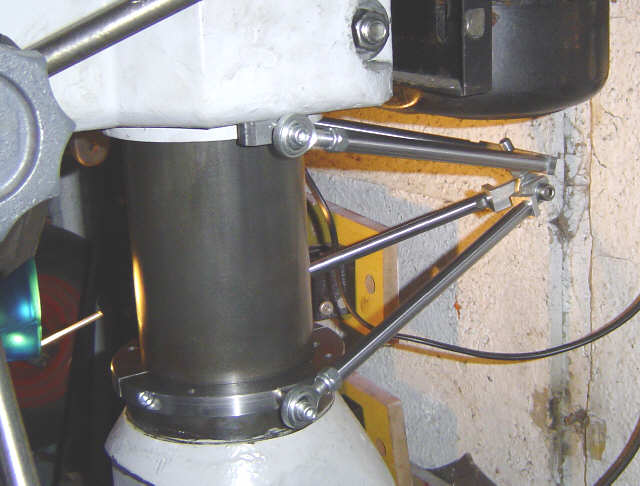

    I'm happy with the way my [ame="http://www.cnczone.com/forums/showthread.php?t=70099"]wishbone stabiliser [/ame]works if you want to copy.

    Cheers for the stabiliser idea, Not quite what i meant tho. not bothered about rotational postion. I was refering to the the existing head rocking on the post (out of tram(I think..))
    In the picture of yours, is that the locking bolts I can see at the back of the head casting?
