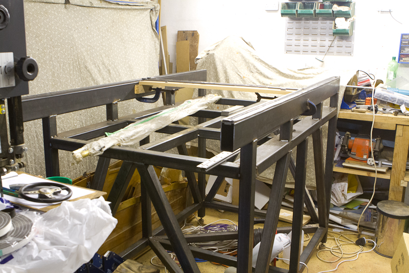

    This is an overall view of my machine (very much work-in-progress).

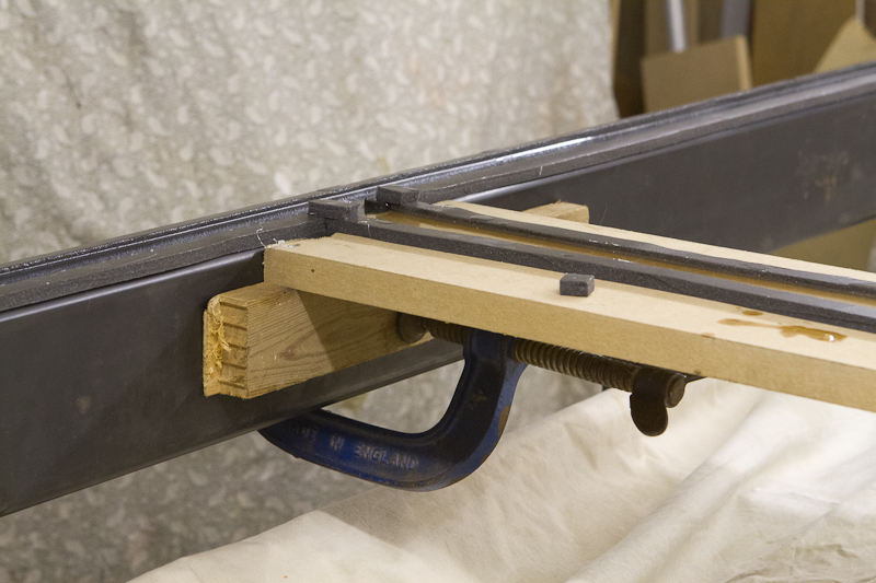

    Top rails are about 1800mm, spaced at about 1000mm. Construction is all-welded, a mix of 50x50x3 and 100x50x3. As far as I can judge, the X rails dip in the middle by about 1.3mm. I don't know if this is welding distortion, or if the original box section was slightly bent.
    I used a single central bridge, an odd length of MDF that was about the right size. It is screwed to some odd bits of batten, clamped to the rails so it is level with the rail surface.

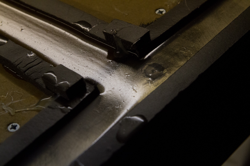

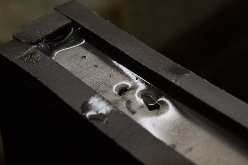

    The dam uses Screwfix thick draught excluder, which stuck well. To avoid leaks in the corners, I used small dabs of hot-melt glue. I tested this first, in case it melted the draught excluder, but it seemed OK and worked well. The only leak, in fact, was over a couple of the plug welds that hold a 25x5 strip in the top of the rails (to take the tapped holes later). There was clearly a very slight weep through these. This shows the hot-melt glue, and the sink hole close to one end over a plug weld.
    I don't expect this to be a big problem later.

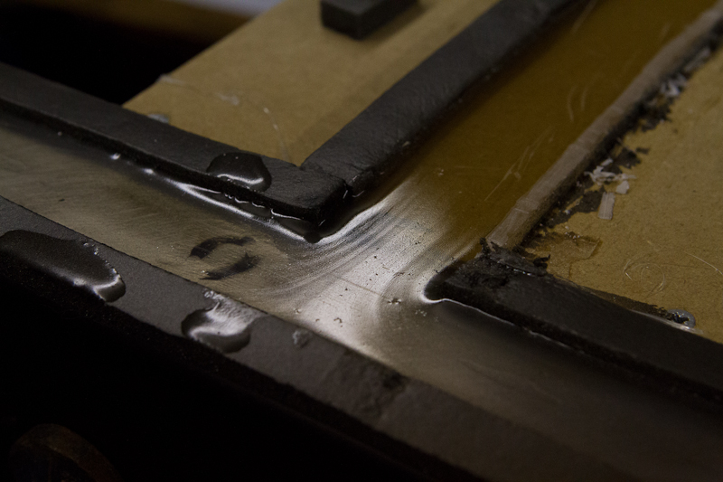

    There were a couple of things that were worrying me before I started. One was the horror stories of shrinkage, especially at rail/bridge joins. I didn't see any evidence of this.
    One thing that I did do was to run up and down the epoxy with a small stick once I had poured it, to encourage it to find its own level. I think that that might explain the visible stripes in the epoxy at the join, although you can't feel them on the surface. I could also remove almost all the bubbles by poking them with the stick.

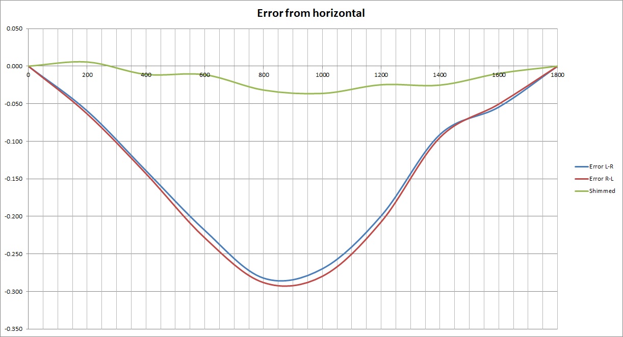

    I had no idea just how level epoxy levelling left the surface so I checked one of my rails this evening. About 1750mm long, joined to the opposite rail about 1000mm away via a single central bridge. Epoxy around 4-5mm deep (there was a dip in the middle of the 100x50 box section rail support of about 1.5mm). Once set, I removed the meniscus from the epoxy with a coarse file and also ran the file over the top of a few bubbles that had formed.
    For checking, I used a precision level plus feeler gauges, resting on a couple of ball carriages on the profile rail bolted directly on top of the epoxy. Using a 200mm level, I measured the deviation from level at 200mm intervals along the rail, then calculated the variation from a straight line between the two ends of the rail (which were about 4 thou different in height. This was because I had moved the frame slightly from when the epoxy was first poured.) I'm sure that there was plenty of scope for errors to creep in, but at least it gives a feel for the overall magnitude of the errors. I'm sorry for the mixture of imperial and metric units in this post but I still can't get a grasp of the magnitude of small measurements once you are down to tens of microns and I have to go back to "thou".
    I was surprised by how good the results were. Remembering that these figures are variations from a straight line between the two rail ends, the maximum variation from "flat" was about 7 thou corresponding to a dip in the middle of the rail and smoothly rising towards each end. Given that this resulted from an epoxy self-levelling along a long, narrow 1750x30x5 "channel", and even though fairly runny by epoxy standards it's still not quite like water, that seems pretty good. Knowing the numbers gives me more confidence in moving forwards, and I'm planning now to use epoxy levelling on the gantry as well.

    I wasn't sure how deep to make the epoxy but 5mm, maybe a touch less, at the deepest seemed to be about right while leaving an adequate depth at the shallowest points. I wonder if the roughly 7 thou variation is due to the change in depth along the length of the rail - there is a slight dip in the epoxy surface where the epoxy is deepest. Might be coincidence - don't know. I was concerned that the epoxy should be deep enough that the self-levelling would work; I had a feeling that the epoxy might not flow quite as freely if it were too shallow. Again, this is conjecture and not tested. I was not concerned about depth as far as tapping was concerned; the epoxy drills easily (rather more easily than the steel, anyway) and I would not expect unfilled epoxy to hold a decent thread. Although I used 3mm box section, there is a 25x5mm strip inside the box section to give depth for threading. I drilled the box section and plug-welded the strip in place using an improvised wedge arrangement to hold the strip against the inside of the box for welding. In retrospect, I should have used Eddycurrent's "glue it in place" technique. Once tapped and bolted, it ain't going anywhere...
    Another variable to play with is epoxy strip width. I used draught excluder tape to make the dam and with the aid of hot-melt glue to plug any joins, it worked well. However, it leads to a narrower strip. Njhussey's technique with MDF walls glued to the sides of the box section clearly gives a wider strip. Personally, I believe that the narrower strip (as long as it is wide enough to support the rail) works fine and is perfectly adequate but it does make it essential to remove the meniscus which has to be done without damaging the surface that will take the rail. A wider strip means that the meniscus will not interfere with the rail mounting, and in any case there is more room to hack at the meniscus without damaging the surface. My way uses less epoxy, and I didn't have any problems taking a coarse file to the edges but that doesn't mean that it's the best way.
    I'm sure that the epoxy technique would work well for a differently-shaped area. My experience suggests that the epoxy does not level itself absolutely but it might be better over a square area rather than a long thin area. Additionally, I wonder if large variations in depth affect the top surface so doing the filling in two passes - the first gives a "nearly there" surface and the second corrects any minor residual error - might help. Or be ready to shim out the odd thou or two at the end if you need a really flat surface, but the epoxy will still get you closer than any technique other than machining or grinding. Even a slab of Ecocast will need to be mounted carefully to avoid deflection when bolted down.
