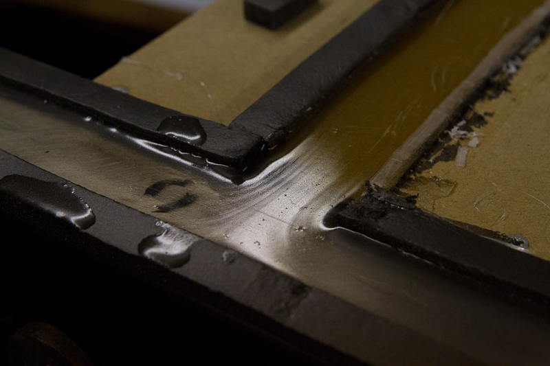

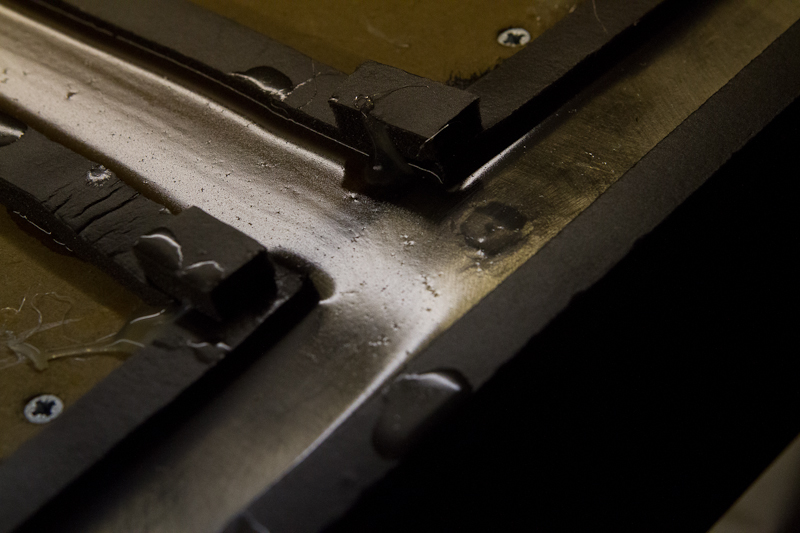

Here was my second attempt on the X axis:
https://www.youtube.com/watch?v=FDrcpnVUcEE
And using this method on the Y axis:
https://www.youtube.com/watch?v=aw0pM_uV1kwLast edited by routercnc; 04-07-2019 at 09:54 PM. Reason: links added
