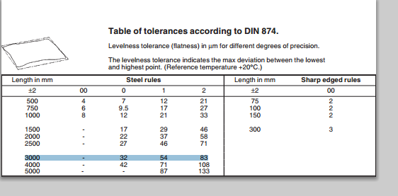

    Its relatively speaking. I did not mean to brag or mislead, just to encourage and lay down the points that should be followed to the letter, if one wants to achieve what could be achieved at home.
    Yes Dean, its more like a wishful thinking. Of course it could not be measured, especially at home. I agree its not real 0.01mm. Maybe even not real 0.05mm at some places. But may be it is between 0.01 and 0.05mm if lucky and done right/. I was able to discover bigger than 0.05mm gaps using the edge and strong led torch.
    Lets say i am happy when with the straight edge i could not find a spot where it did not look perfect and tight fit to the edge. Thats my criteria for straightness for my machine. Obviously on a 3000mm travel, that's something, when done right and at home.
    Having in mind that the straight edge itself is not so straight over 3000mm , table below, that on paper it should be supported/handled at a special length for the measurement to be right i would say there is no way that something could be proven right or not.
    That means though that there is still a small chance in a million that in fact is that straight. . Who knows, when its not measurable.
    So i say, better do things right with the idea that all must be perfect. Yeah the result may not be. But what would happen if one even does not even strive to do it right.
