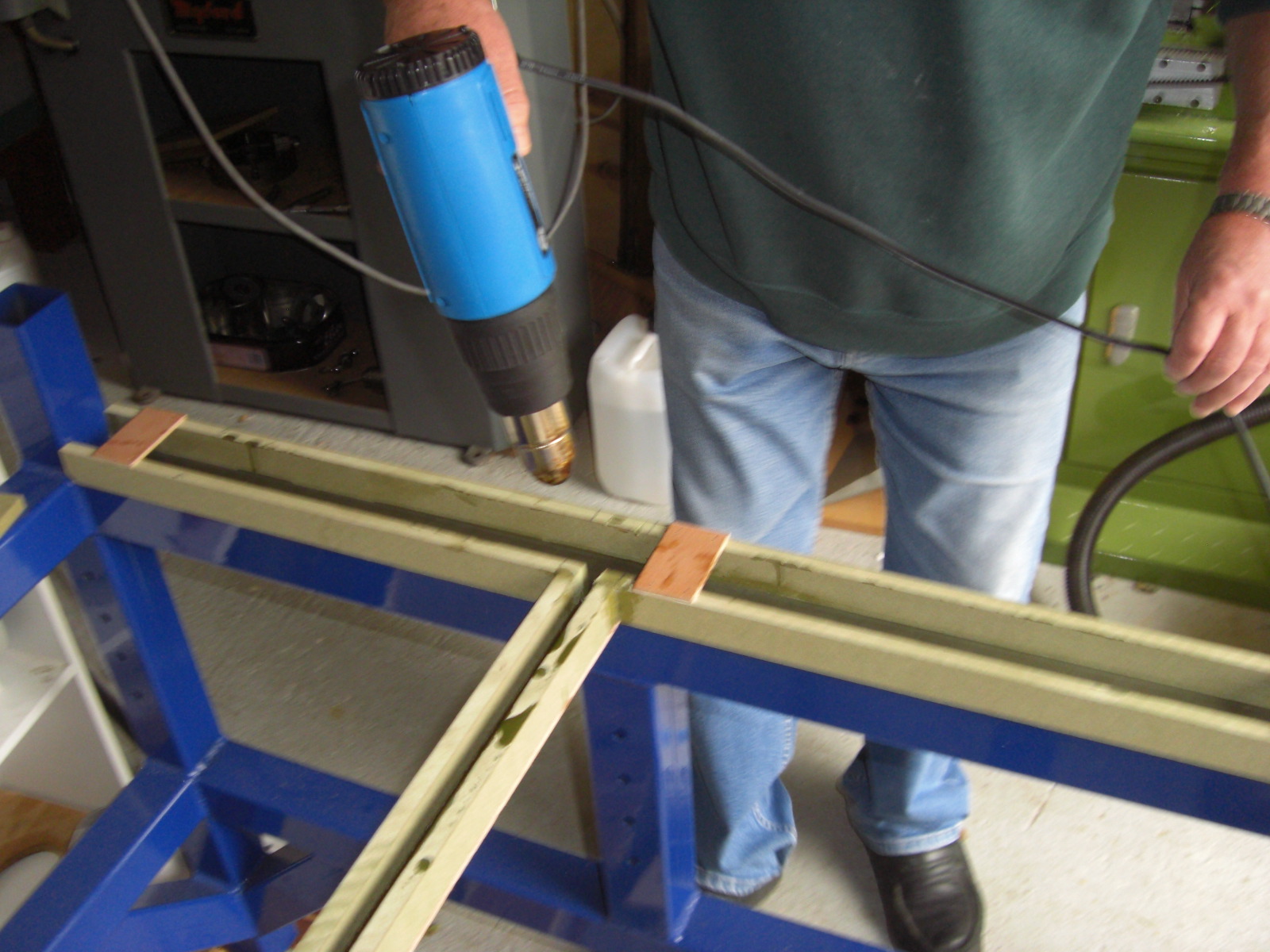

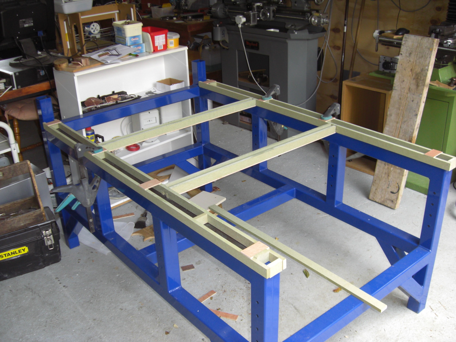

    Ok This has all been said before. The system I used is this http://www.westsystem.com/ss/209-extra-slow-hardener/ this is the pdf. http://www.westsystem.com/ss/assets/...%20105_209.pdf
    It is very important to measure and mix well. it is important to make the moat water tight as any small leaks will spoil the job. I used a thin bead of silicone all round the inside edge. Just make sure that the frame is least at about 18C .
    Mix the epoxy with a flat paddle ie not a round dowel and mix well slowly so as not to introduce air into the mix then let it settle for a couple of minutes. If you have another prepared container with a hole near the bottom about 6-8mm with some tape over it you can then pour the epoxy into the prepared container.
    Then take the tape off the hole and let the epoxy pour from the hole into the moat. (this will get rid of most of the air as bubbles rise and you are pouring from the bottom)
    Don't just pour all the epoxy in one place but try and get it even all the way round. Then if you see any big bubbles you can just flash them with the hot air gun they instantly disappear. (you are not trying to heat the epoxy up it is a quick flash)
    The epoxy is almost like water and will flow very easy.
    Rich There is no way a soldering iron will stop the surface tension miscues thing from happening all around the edges of the moat AND around any bolts you have put in.
    When the epoxy has cured at least a week then remove the moat sides etc and with a rasp bastard file carefully remove the miscues. If you are using 20mm rails you want the moat at least 40mm wide (mine was 55mm)
    I used two dams from one rail to the other and was more than happy with the result.
    This has all been done to death and is not rocket science I think in a hot country you may have to be a bit more careful. The epoxy may feel hard to touch but DON'T play with it until at least 7 Days have past and has been said already make sure that the base is clean and oil free. You can rub some oil around the inside of the moat edges to stop the epoxy sticking to the sides (make sure it is sealed first though). ..Clive
