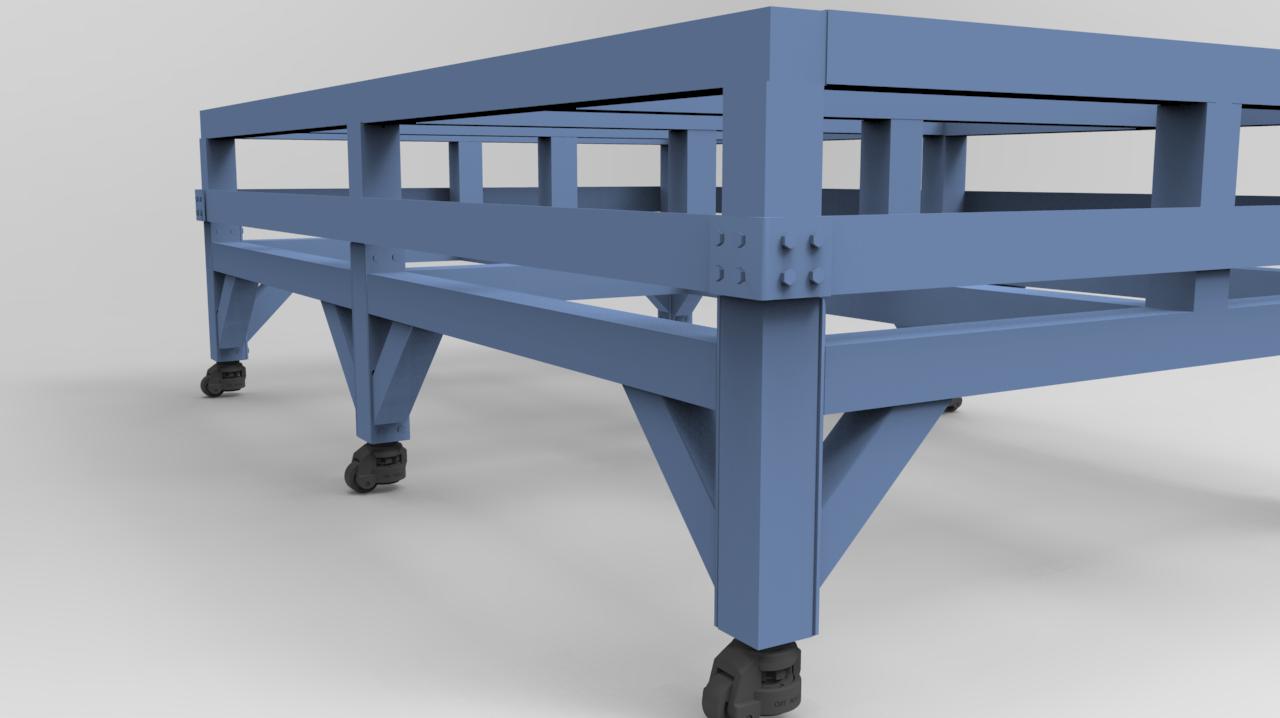

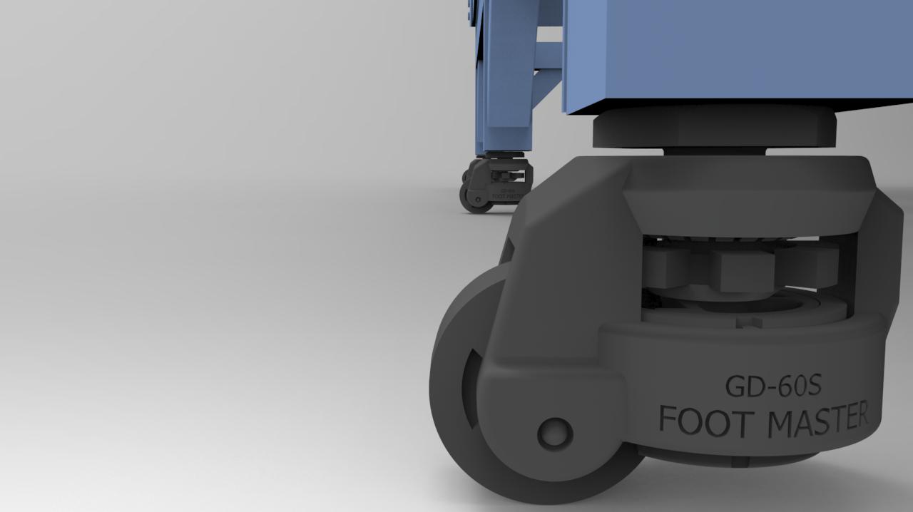

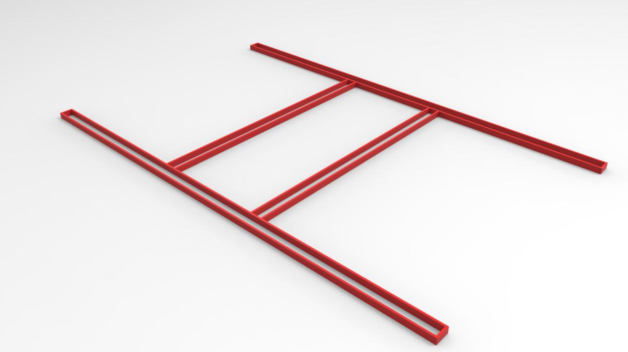

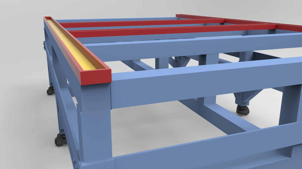

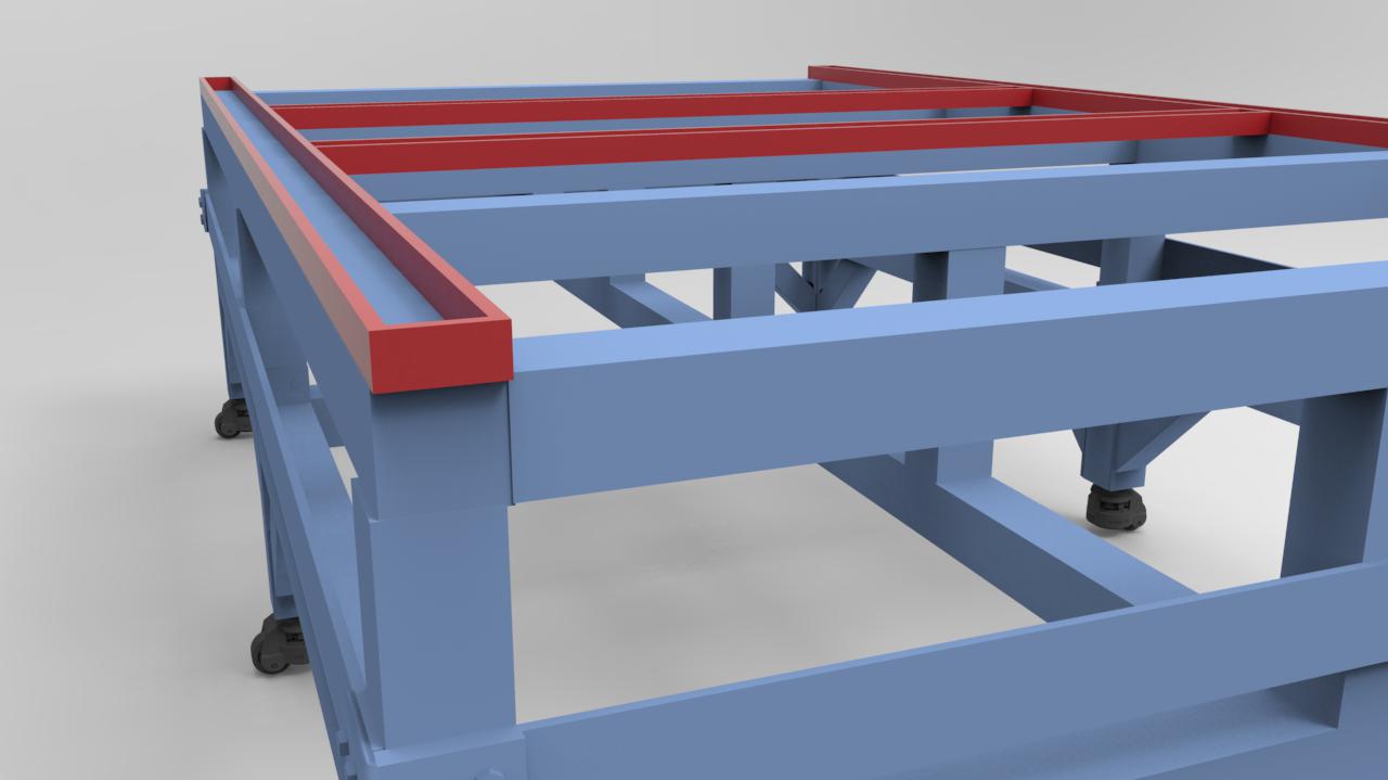

    so in theory i should get the frame as level as a human can by hand using adjustment castors on the feet, then once thats as level as you can get it i then place the dam ontop of the frame (im using 25mm rails so my dam will be 65mm wide) then pour epoxy into the dam and let it level out then wait for about 2 weeks (to be safe) and then i can now bolt my rails ontop of the epoxy assuming its flat level?
    cheers
    ash

  8. #78
    I doesn't really matter if the machine is not level on the floor as the epoxy will level out like pouring water into a channel it will find it's own level. What is important is that you do not have any leeks in the moat I put a very thin bead of silicone all around the inside.
    You will need it about 5mm thick. If you use MDF for the moat after the silicone you could put some Vaseline on the insides of the moat to stop the epoxy from sticking.
  9. #79
    thanks clive, do you mean the silicone has to be 5mm thick or the epoxy? i was going to use about 5mm anyways for the epoxy if so.
    cheers
    ash
  10. #80
    Quote Originally Posted by reefy86 View Post
    cheers
    ash
    The silicone is only to stop any leeks so a very fine bead between the MDF and box section. Iff you have any leeks the job will fail
