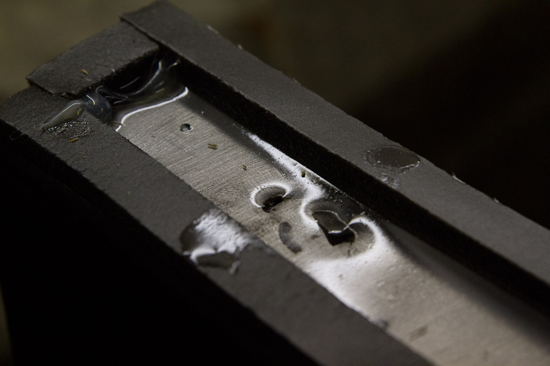

    The dam uses Screwfix thick draught excluder, which stuck well. To avoid leaks in the corners, I used small dabs of hot-melt glue. I tested this first, in case it melted the draught excluder, but it seemed OK and worked well. The only leak, in fact, was over a couple of the plug welds that hold a 25x5 strip in the top of the rails (to take the tapped holes later). There was clearly a very slight weep through these. This shows the hot-melt glue, and the sink hole close to one end over a plug weld.
    I don't expect this to be a big problem later.
