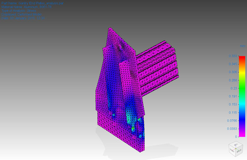

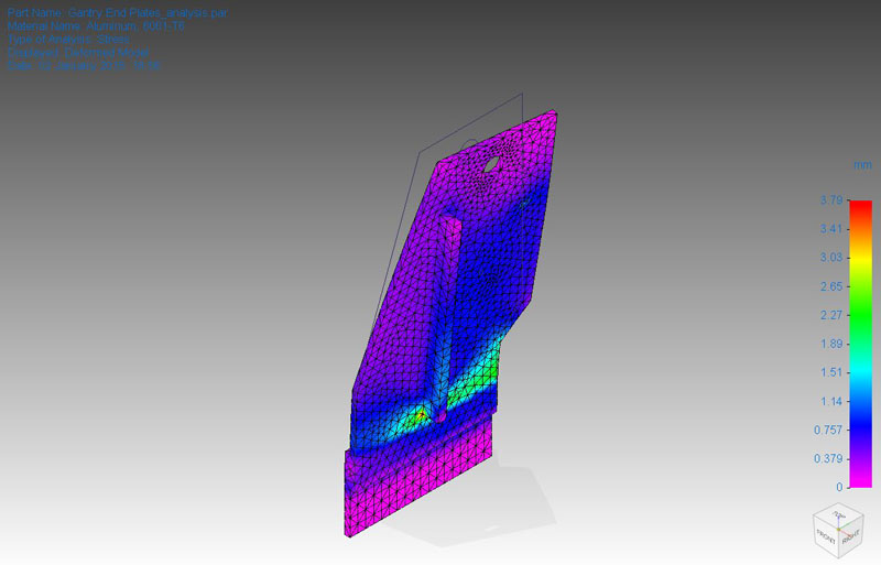

    Hi Jazzcnc, thanks for the feedback.... I hadn't done much calculations of the side supports, so I've now gone back and tried to calculate some forces and deflections. The absolute values are perhaps hard to quantify but the level of improvement is at least relative.
    Initial layout I applied a 500N lateral load to one side, ignoring the opposite side for sake of easy calculations. Load just applied to the top fixing hole of the Section8.
    The analysis show stress concentrations as such.

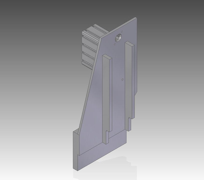

    Adding some ribs and thickening the bottom plate that holds the carriages, also added the Section 8 to better simulate the load area.
    Stress plot looks much better etc.
    I hadn't correctly put the weight of the spindle and stepper motors in, so even with the extra material thickness I'm at 66Kg. Hopefully keeps with one X axis ballscrew.
