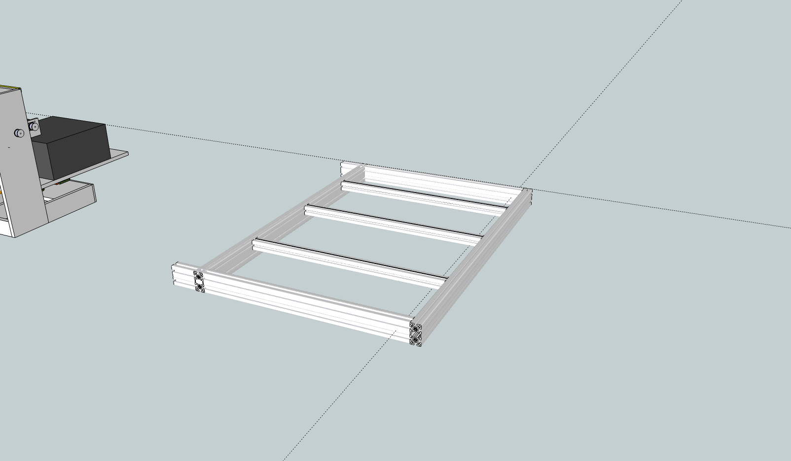

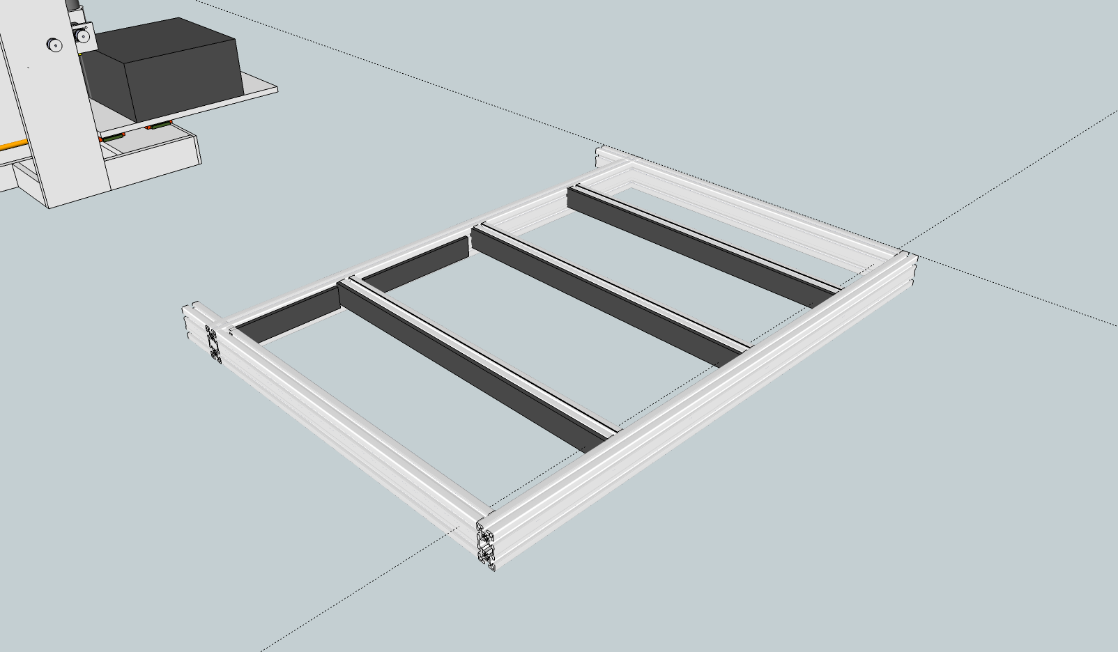

    So i sat down and made a sketch. Once i started drawing i saw what would happen at the end, but let me show the steps why.:
    As its seen the 2x 45x90 1076mm profiles that were meant for gantry are not strong enough for a gantry, so one solution is to cut them to size and together with the 45x45 profile to form the table. Angle plates are not shown.
    Now about that 45x45 profile extrusion = totally useless for a cnc build. I cant seem to find a use for them , not strong enough even for middle of the table, the only thing i see as possibility is to buy 6 meters of cheap steel 60x10mm and use that to reinforce all as shown in the photo below.
    Now about the 45x90 aluminum extrusion and linear rails and ball screws. Lets do it the compact way. rails aside and ballscrews below. Grrrrrrr, not possible. not enough wide for both. So what. Linear rail up and ball screw aside, noooooo, it would eat the size of table and so travel will be limited...
    So whats the conclusion. From all that aluminum extrusion a table can not be formed for the desired size and linear rails bought before.
    Not a big deal cause i have other design in mind where the extrusion will serve for reinforcement and so, but not for the base structure.
    I am working on my first more commercial cnc so i could change a bit the design and implement the extrusion. will soon show drawing where i do that to the exact size of his rails

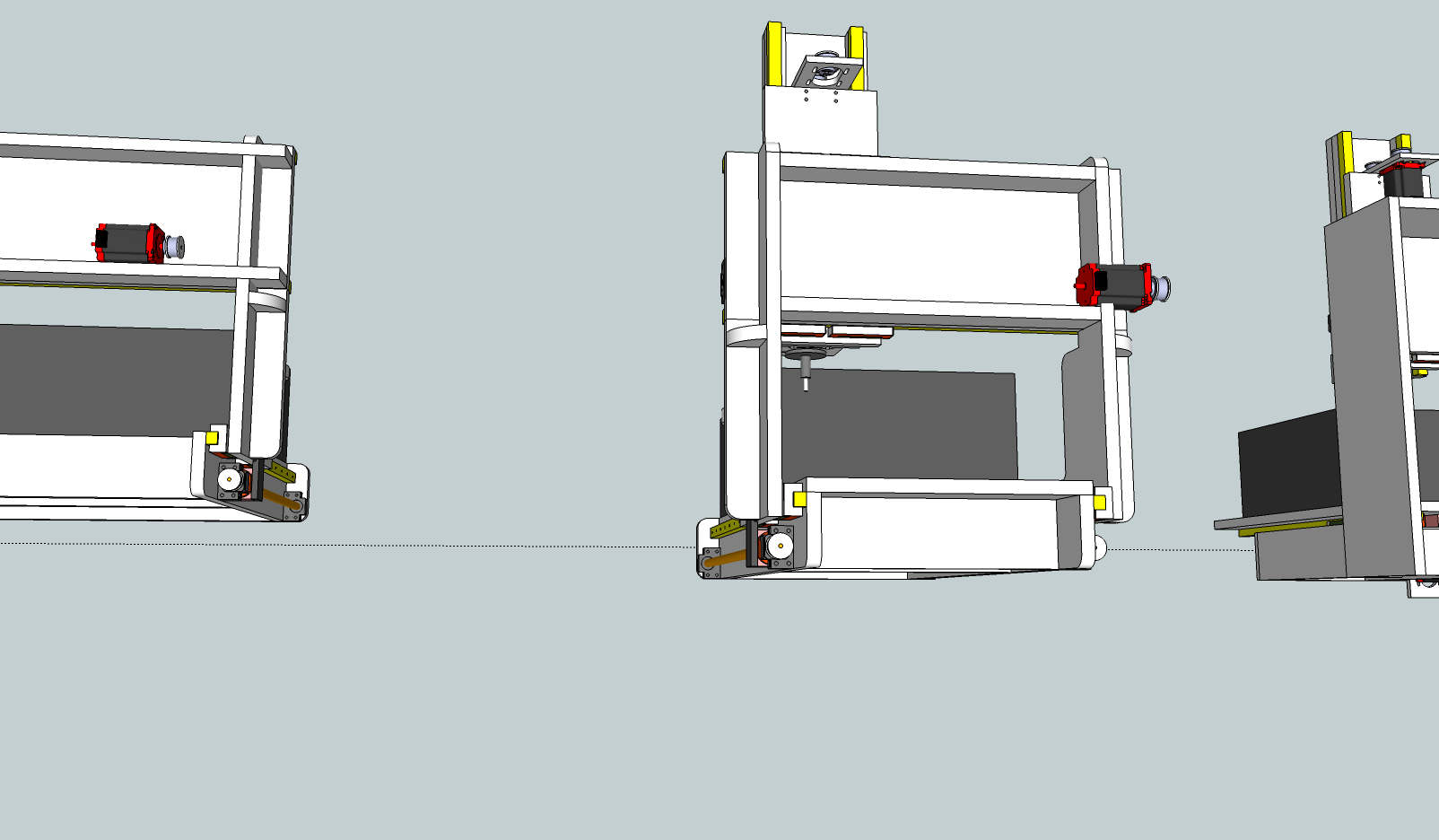

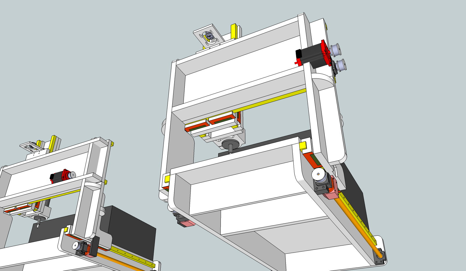

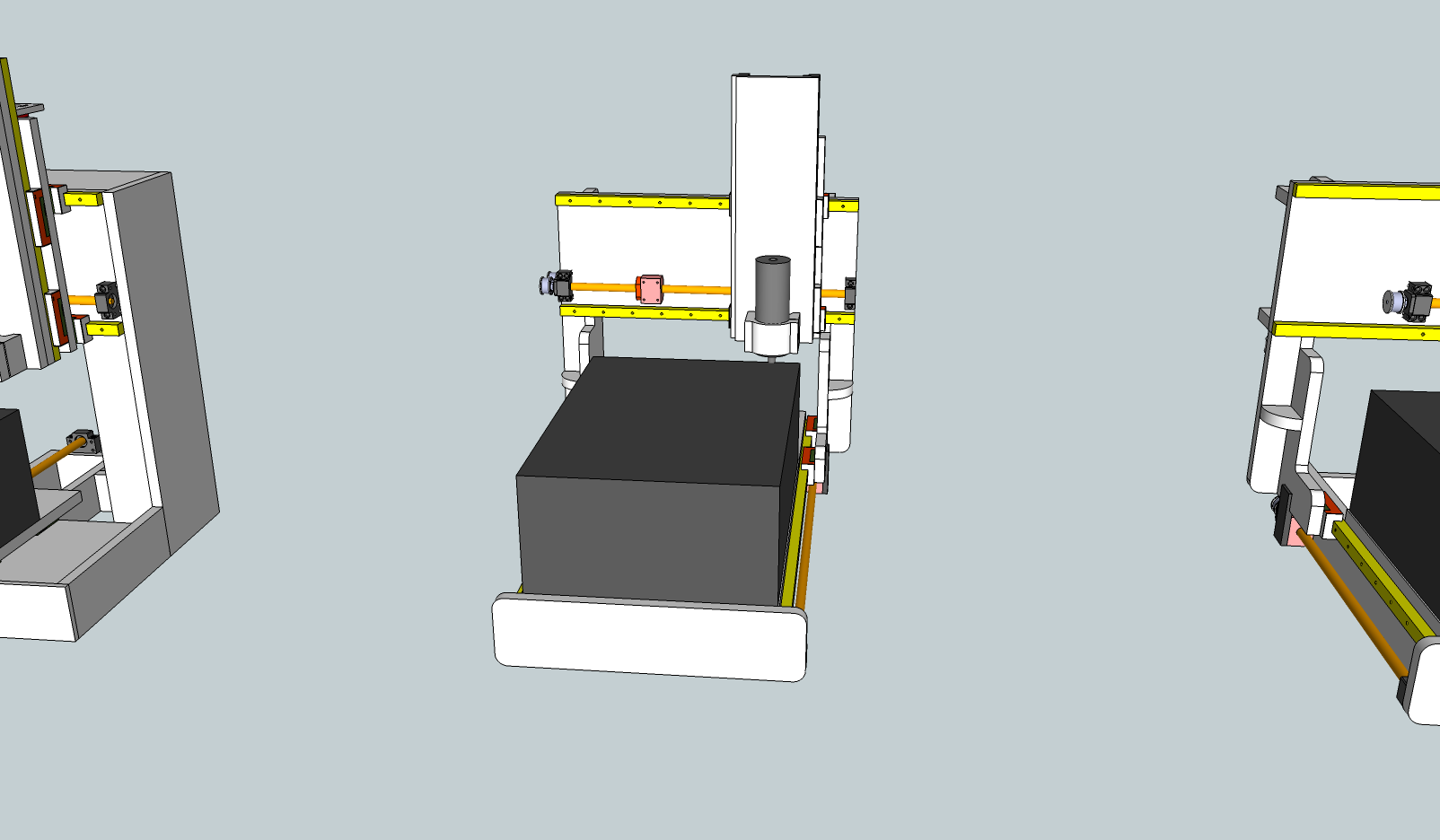

    Here is the general design. Thats the development from the other thread where i started designing small cnc that would be cheap and fast to put together. All is 20mm aluminum plate. So some of the plates could be exchanged for the existing profile.

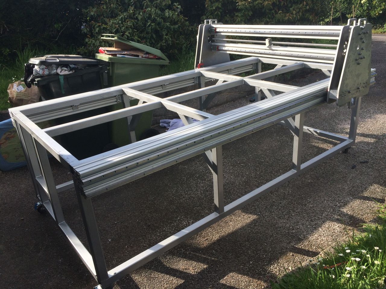

    Hi There, I'm new here but ive just finished building a machine using 90x90 heavy profiles. You may find the pic helpful for inspiration.
    https://youtu.be/txquIxeCVQY
