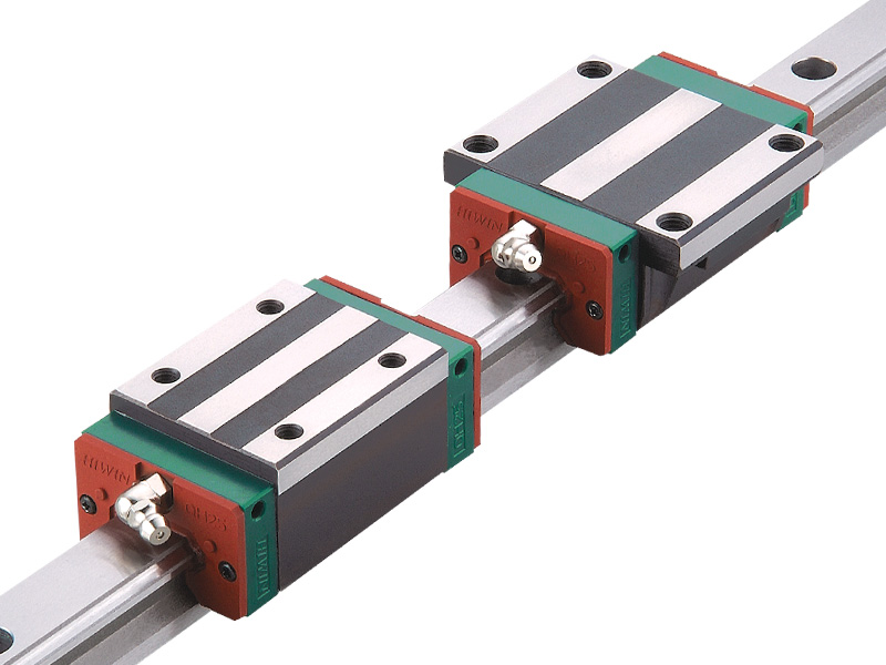

    Mike, Yes they do. Should have some grease nipples...(hehe) on the side. I like to use moly bearing grease for high load applications, this is commonly known as CVjoint grease too. Do not go crazy though so you can at least make an attempt to keep the rails clean of dust/grease gunk. Frequency depends on use, gut feel indication would be 1/month for occasional use, 1/week for heavy use.
    R's
    I'm not sure about SBR16UU type blocks having grease nipples. External features on the sides of these always look like grub screws to hold the bearing in place. I've not re-greased mine and they've been running fine for years. Where possible I think you would have to slide the relevant axis off the rails to smear some grease onto the balls and that involves quite a strip down. It wouldn't hurt to give them a very light smear of moly grease before assembly:

    But Hiwin style blocks do have them and you can grease them if you can get to them, but you are not using that type:

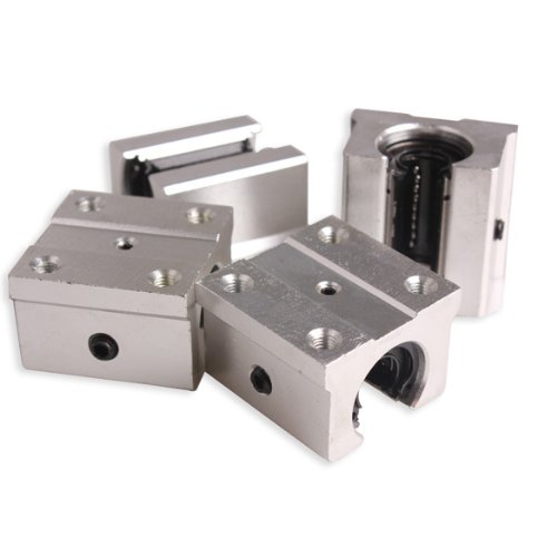

    No they don't have them :(, the side grub is for taking out any slop allowing you to preload them just right on the TBR units, they also have a locating grub in the top that I think is for locating the bearing unit it's self.

    My bearings are the SBR16UU and I did put grease nipples on side and grease them with the gun mine had no grub on the side only on top side was open, if Lee is correct I may have made an error but the grease certainly arrived where expected, having removed Z axis at one point for adjustment bearings were nicely coated and operation has certainly been slightly quieter since application, at extremes of travel a minor grease line appears at wipes max reach is apparent. I did have some paperwork with the two boxes of chinese bearings recieved in chinese so not read but picture showed top grub for loading bearing and side had grease gun aligned hence my judgement to add nipples and grease. Would be interesting to hear any thoughts if I can find paper recieved with mine will scan and add here, although it may well have been recycled as being of little use.

    Had a look for my bearings documentation but could not find picture but did find this one online from same supplier same as picture which was on leaflet which got recycled except for being open bearing for supported rail. As it goes the fact that they all used to be sealed helps me, I have removed nipples on Z axis can always pop one in annualy to grease them again, but they got in the way a little as I hadn't allowed for them.

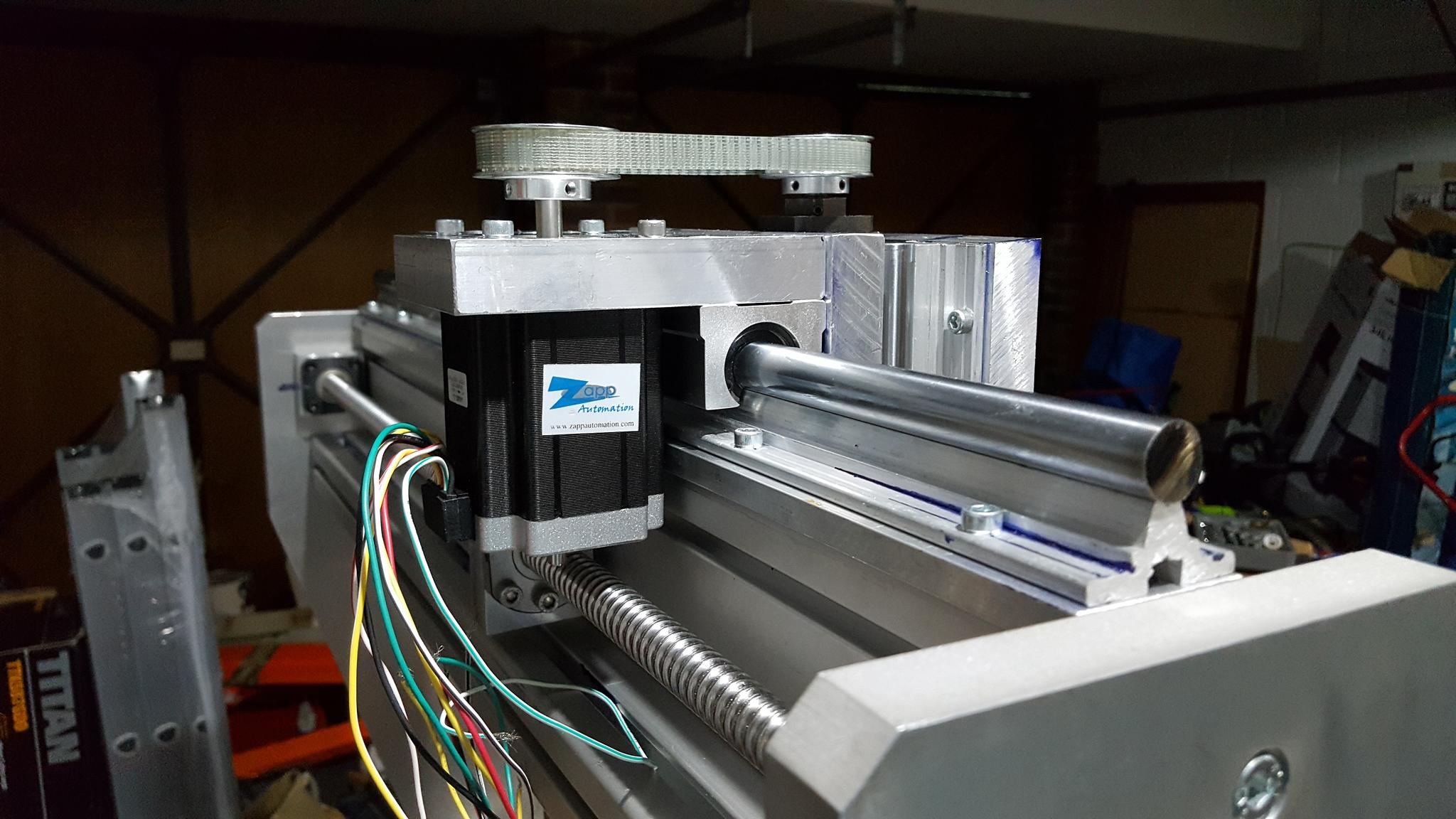

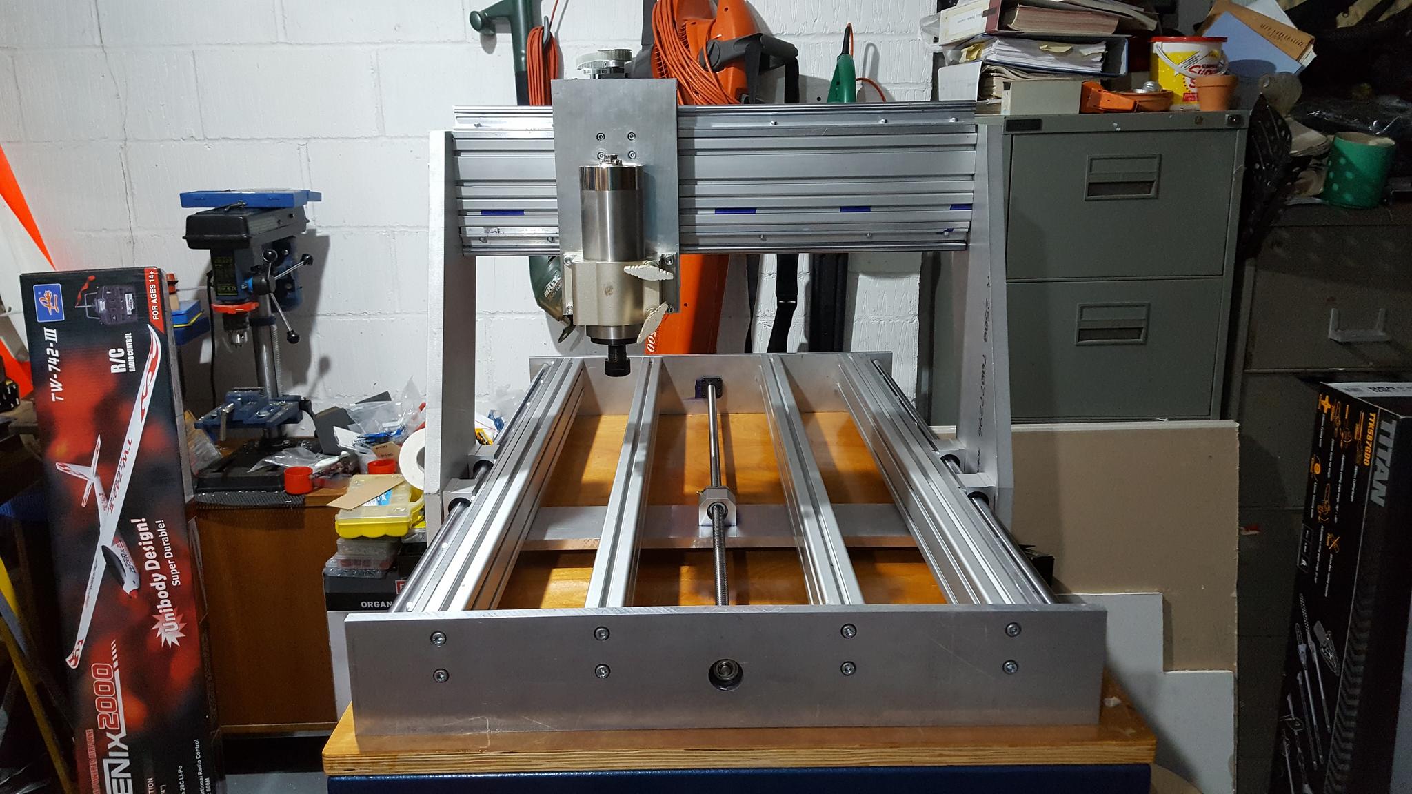

    Quote Originally Posted by MikeyC38 View Post
    Some more pictures of the build. I've been ill since September 2015 and thus made no progress until March 2016. But the Z axis is in place and moves nicely in the Y axis!
    BTW does anybody know if SBRUU linear bearings have to be lubricated? and if so, with what type of lubricant and how frequently?
    Thanks Everyone for the help and inspiration so far!
    Mike
    I have done the initial stages of the electronics build and the stepper motors have be attached to the machine. I have a video of it working (albeit at a modest 1m/min) until I've done the following:
    1) Limit Switches
    2) E-Stop connected to relay to cut power and signal Mach 3 (rather than signal Mach3 first)
    3) Proximity home switches
    Again thanks to Dean for posting a great schematic of how to do a 24V dc e-stop system. What would we newbies do without your help (and ). And to Lee for the steer on grease for the ballscrews.
    Expect to have above done by mid october so I can start doing the tramming etc.
    In the interim I posted another picture with the spindle mounted (just to show that I am making progress!)
ID:	19249Click image for larger version.
    Wish me luck boys!
