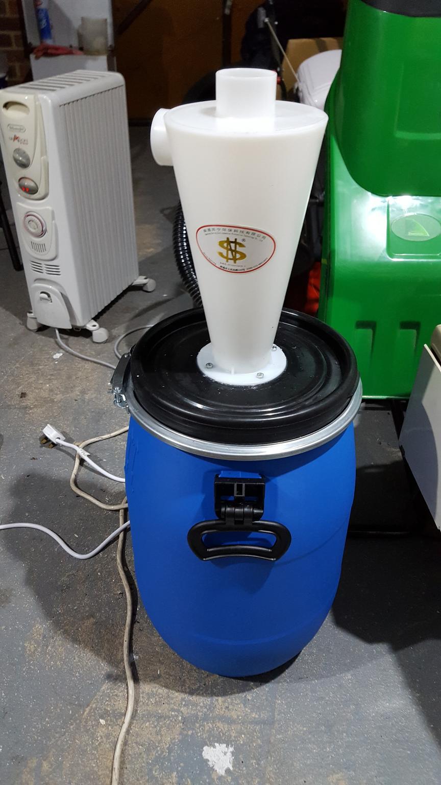

    Great minds do think alike and you are both perfectly correct. Since the video I have'nt done anymore cutting because I realised with the amount dust created just by surfacing, I needed a filtration system. So I ordered a cyclone off Amazon for an amazing price and lots of hose as shown below. I have an old VAX (2000 watts before the EU restrictions!!!) which should do the trick. Also making a dust hood for the spindle based on a design I found on Bjorn Makes YouTube Channel here

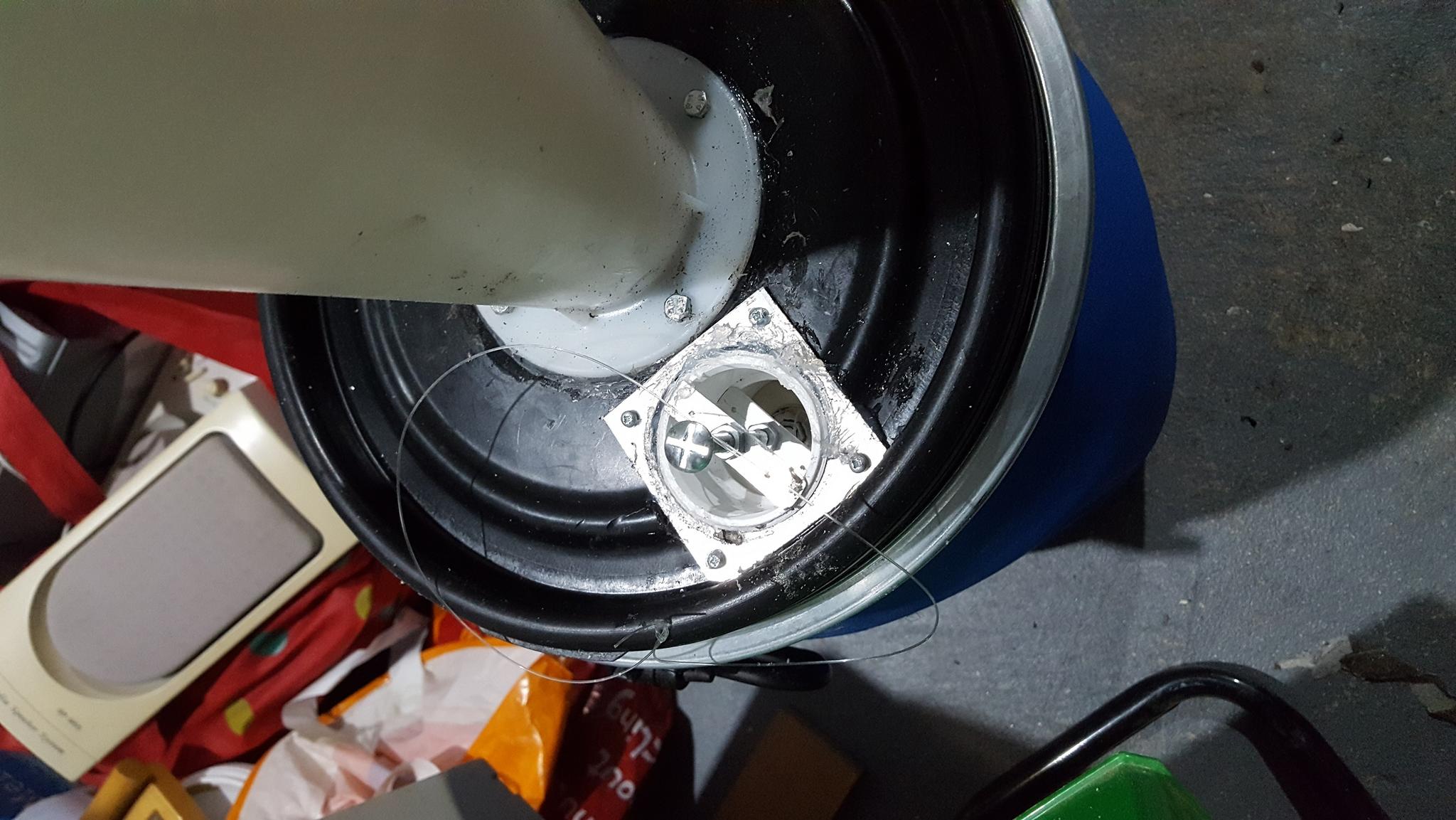

    Following on from the last post, I built my cyclone dust collector, and promptly crushed the barrel, when I put my hand over the end of pipe to check the suction!. Using a hot-air gun, I manged to un-collapse it and restore it's shape. Hunting around on the web, I found a design for a pressure relief value (here) and this design here using a 40mm PVC straight coupler and a neodymium magnet and it works brilliantly!
    see pic Click image for larger version.

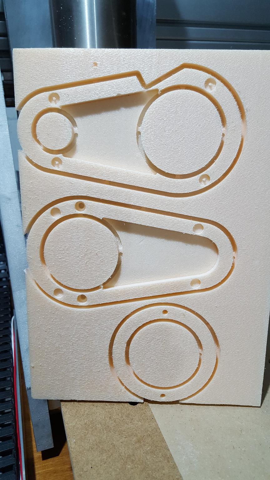

    Also, I have started some test cuts for the dust hood (see previous thread for youtube link!) and really pleased with the accuracy of the machine. The inner ring is 70mm dia +- 0.01mm!!
    There are a couple of toolpath issues to sort out, but the code from Estlcam worked first time!

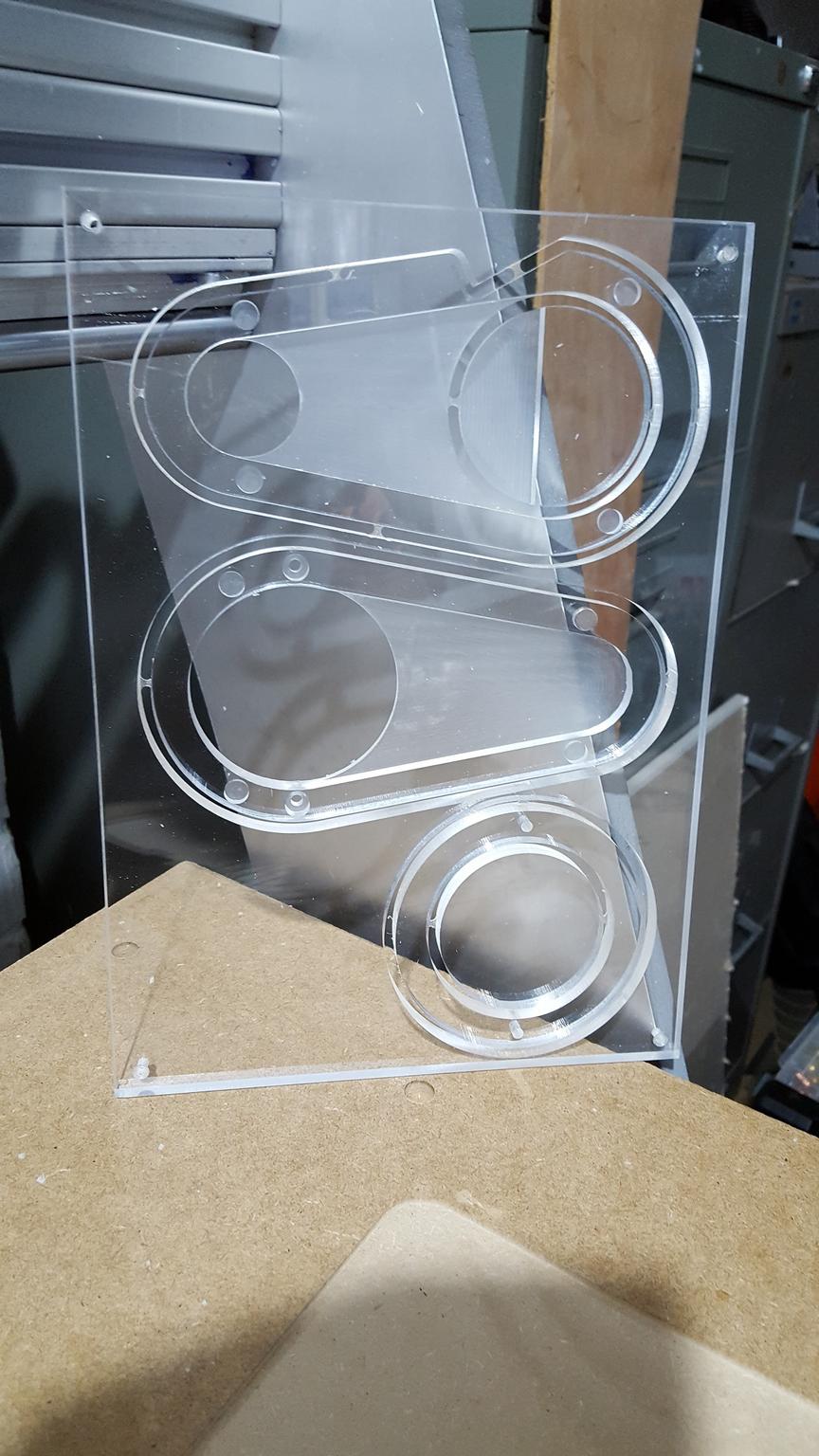

    Sorted out the problem with the toolpath by upgrading to Estlcam v10 and defining the operations in a different order.
    The photo attached shows the final dusthood cut from 10mm perspex sheet using a single flute carbide cutter running at 12,000 rpm, 600 - 900mm/min feed and doc of 1-2mm. Took around 1hr for the all operations. The link to Youtube shows the last operations. I'm pleased with the finish of the pocketing. Now to get on with doing some real projects!
    Kind Regards
    Mike

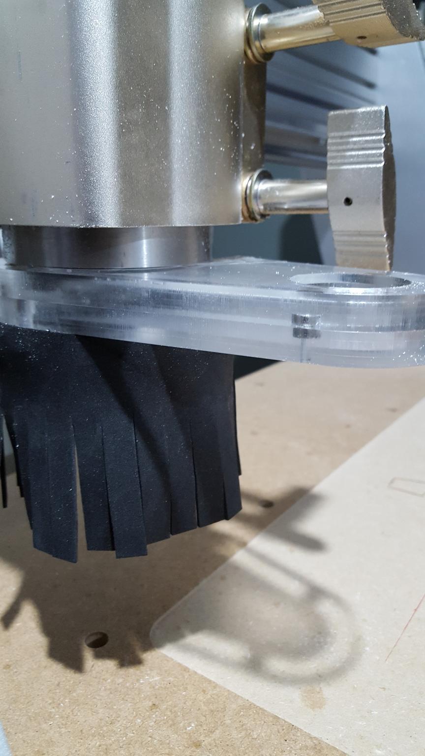

    Thanks Paulus - here is a picture of it fitted. My first CNC project on this machine!
