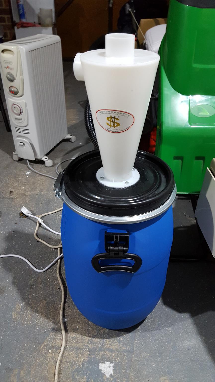

    Dust extraction should be a priority especially if you intend to machine MDF. It uses urea-formaldehyde as a bonding agent and the formaldehyde is a proved carcinogen besides other harmful effects.
    Just watched your video and it doesn't look good to me with all that fine dust.

    Hi Paulus & Neil
    Great minds do think alike and you are both perfectly correct. Since the video I have'nt done anymore cutting because I realised with the amount dust created just by surfacing, I needed a filtration system. So I ordered a cyclone off Amazon for an amazing price and lots of hose as shown below. I have an old VAX (2000 watts before the EU restrictions!!!) which should do the trick. Also making a dust hood for the spindle based on a design I found on Bjorn Makes YouTube Channel here
    Hi Guys
    Following on from the last post, I built my cyclone dust collector, and promptly crushed the barrel, when I put my hand over the end of pipe to check the suction!. Using a hot-air gun, I manged to un-collapse it and restore it's shape. Hunting around on the web, I found a design for a pressure relief value (here) and this design here using a 40mm PVC straight coupler and a neodymium magnet and it works brilliantly!
