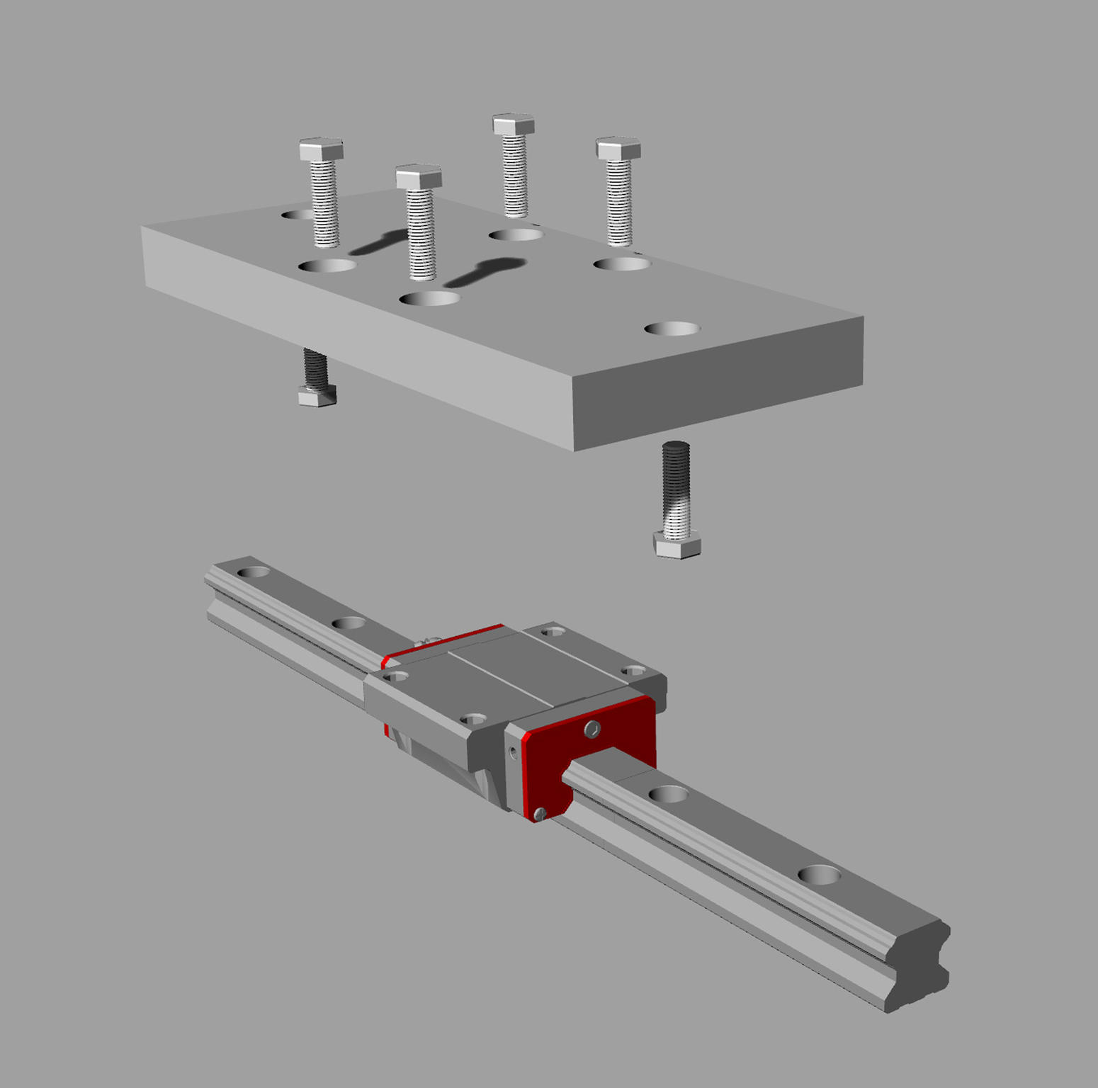

  4. #34
    What about for the bearings you bolt a piece of say 20mm aluminium plate on using 4 cap head hex screws (I've shown bolts) in counterbored holes, then you slide the carriage along to each end of the rail in turn, so you can fasten the plate onto the gantry using 2 bolts (or maybe 4) inserted from below. Or if you put the 2 bolts in first there's probably enough room to tighten them above the rail.

  5. #35
    oops edit I just looked at the previous pages and see you covered it. I would definitely stick with the screws on the outside compared to the last drawing.

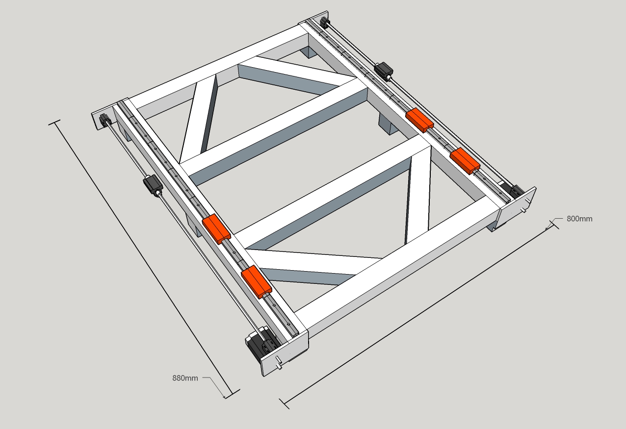

    Hi

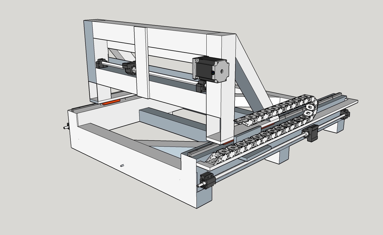

    Thanks for all the advice, I have scraped the last attempt and had another go something similar to the first attempt but using two stepper motors and timing belts for the x axis. all box section is 50 x 50 x 4mm as I have a lot off it in stock. For mounting the gantry to the bearings I will probably mount a plate to the bearings and attach the gantry to the plate like EddyCurrent suggested .

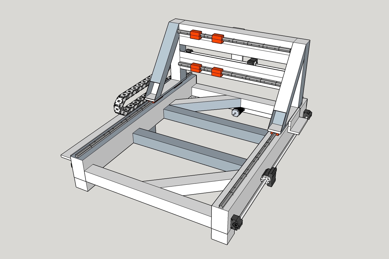

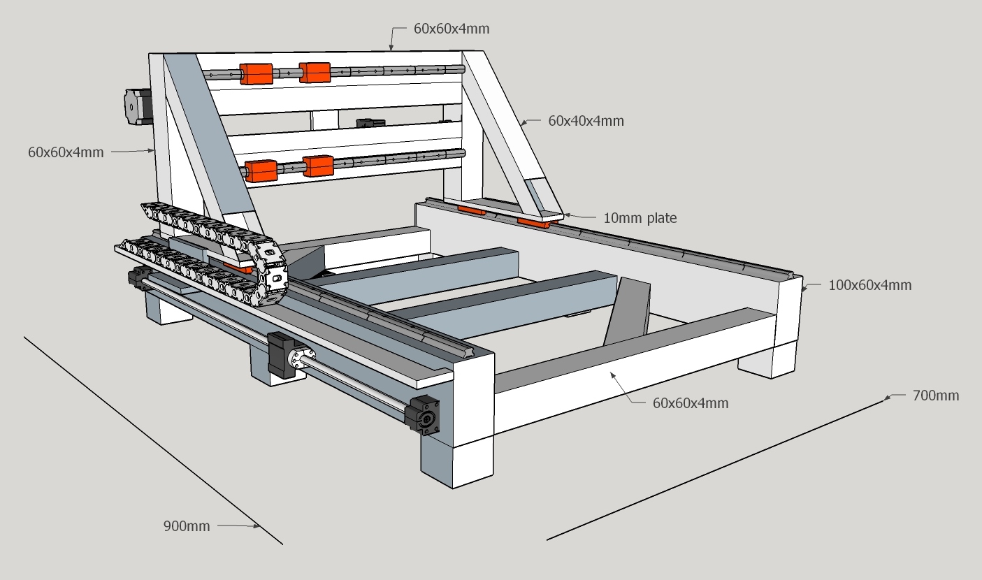

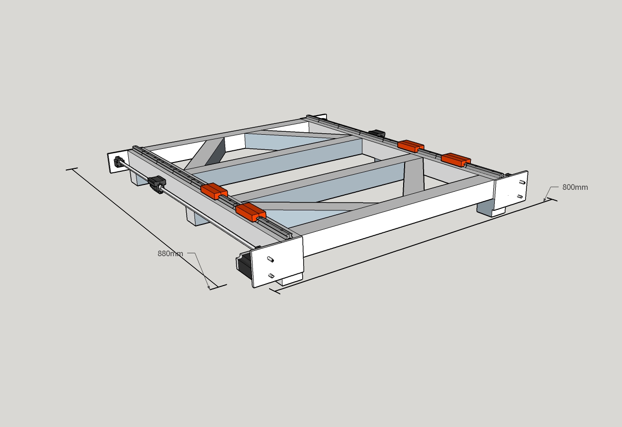

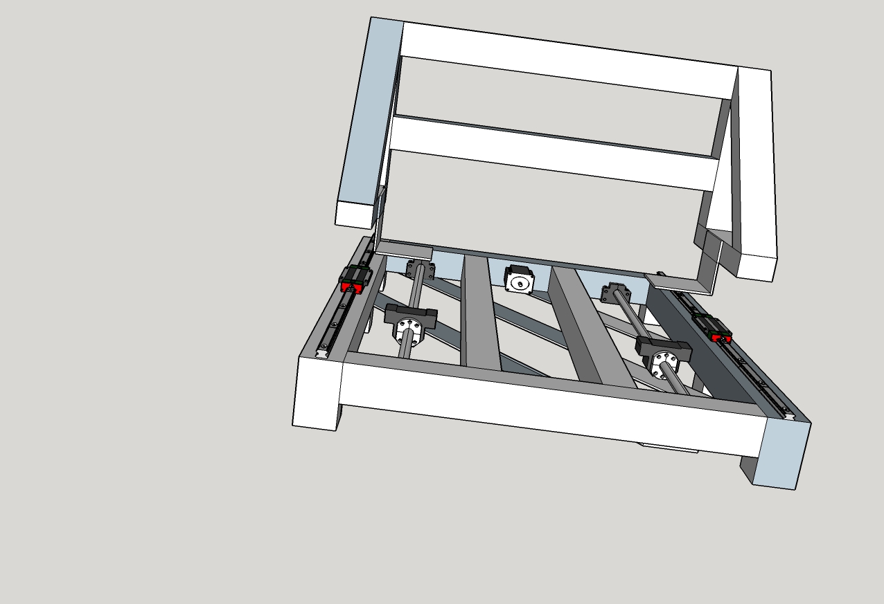

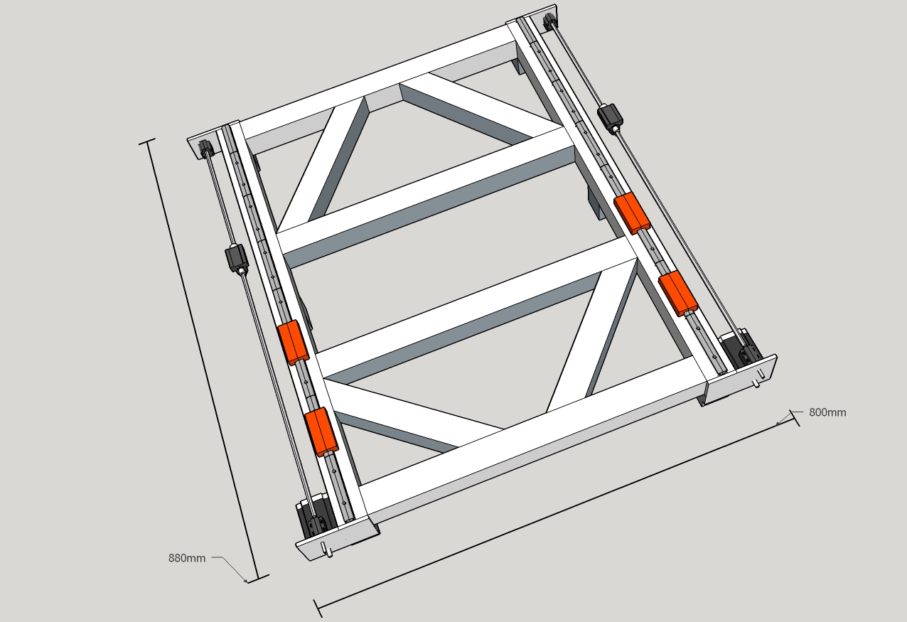

  9. #39

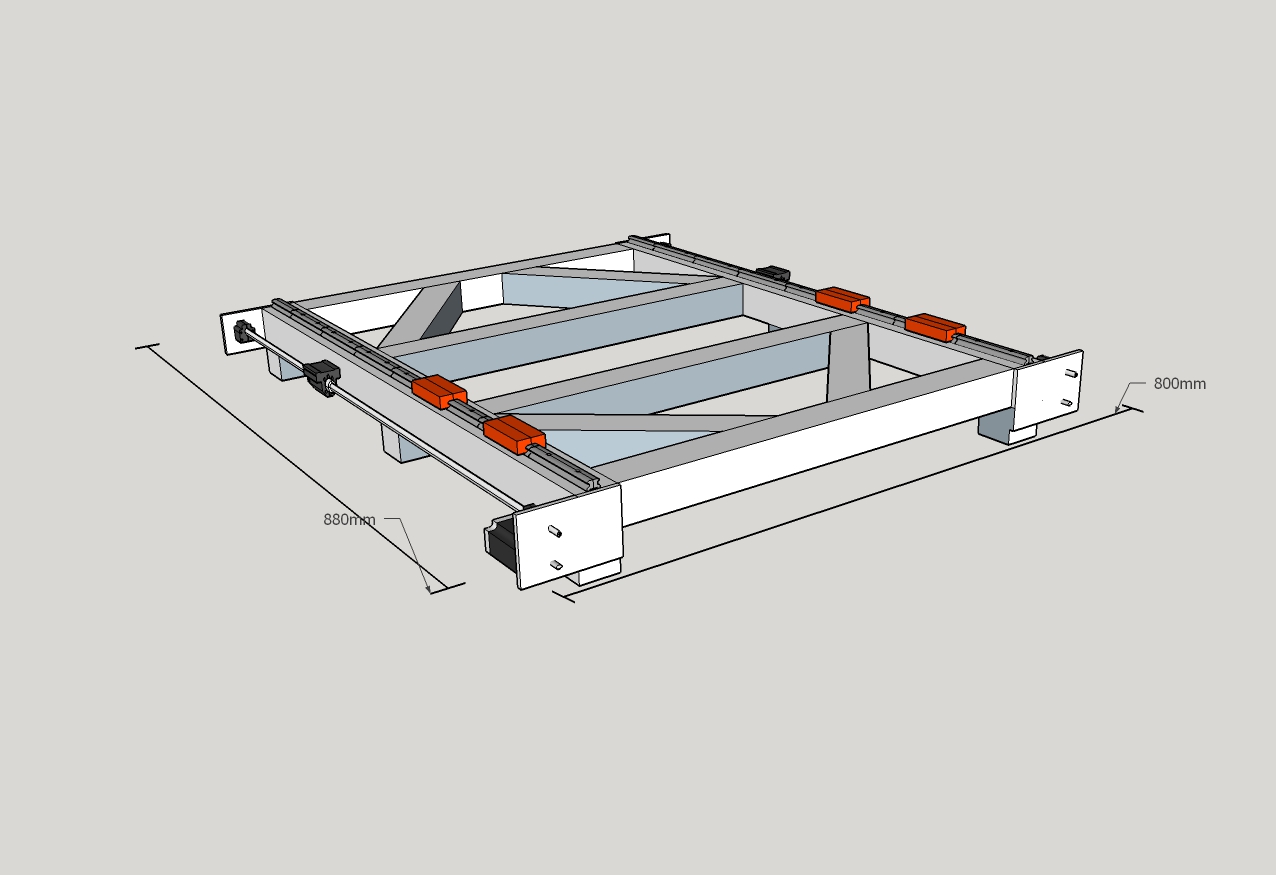

    Hi
    I have been away working for the last year so haven't been able to complete this project but i am now hopefully back for the next 12 months. To recap My goal is to make a simple strong build which will be able to cut hard woods and aluminium at a reasonable speeds, I only have room in my workshop for a machine off 900mmx800mm,I have done the design using 100mmx60mmx4mm box and 60mmx60mmx4mm box .I have change the design from my last attempts and after reading some more logs would like to try and make it using belts and pulleys if possible.The Z axis i hope to make out off aluminium. Here are a few pics
