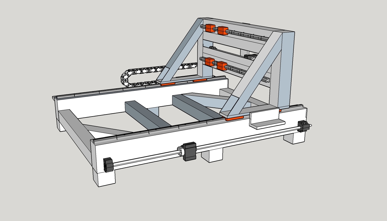

    Hi Jazz
    It was went to fit like this but looking at it it looks stupid .

    Quote Originally Posted by Gregor View Post
    Hi Jazz
    Bad idea for few reasons really. The bed isn't supported at the edges and the L brackets are too flimsy.
    It will work if you Support the edges and run a piece across to each gantry side under the supports with thicker drop plates.

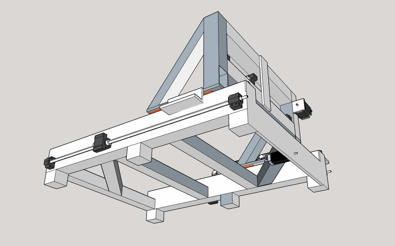

    From your sketch it looks like the belt and pulleys are on the inside of the 50x50 end piece? How the heck are you going to get at them to fit/tighten/adjust etc? I'm not sure about the single carriage for the X &Y axis either, are they going to be man enough for the cuting forces generated?
    Neil...
    Build log...here
    Neil, I think they are the long type bearings but you are right, four of the regular ones (2 each side) would be a lot better.

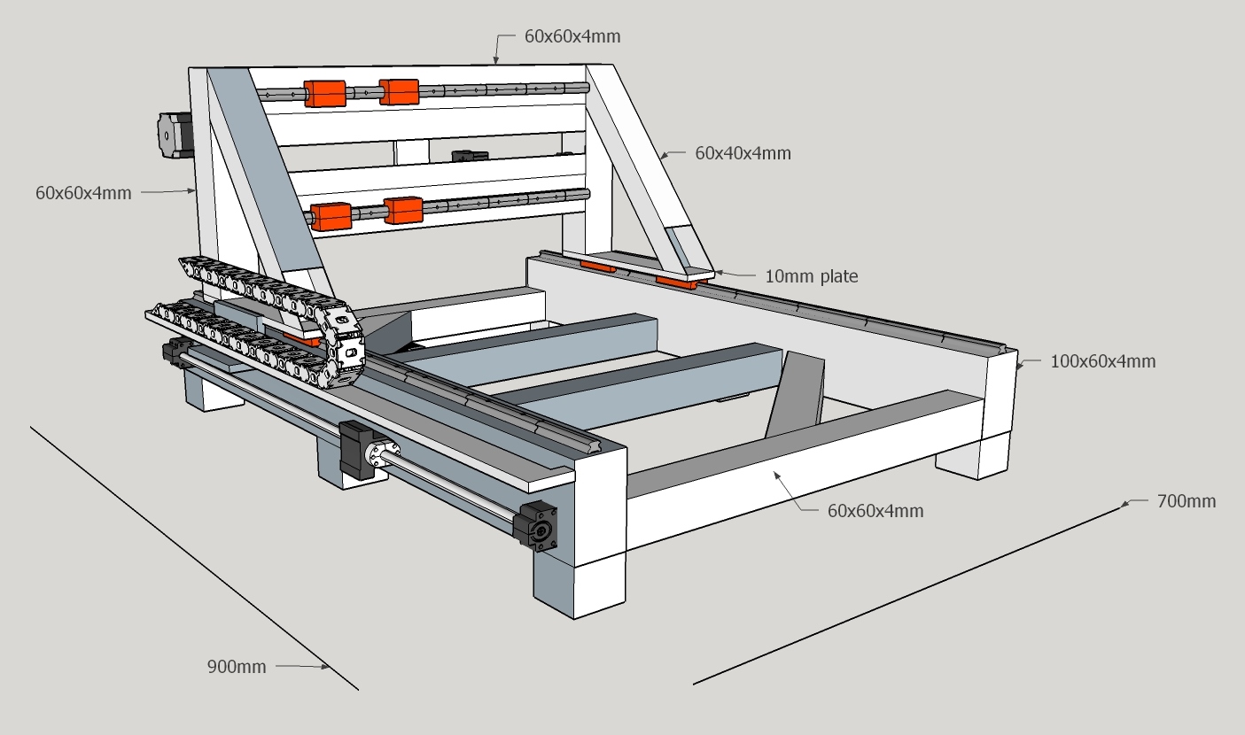

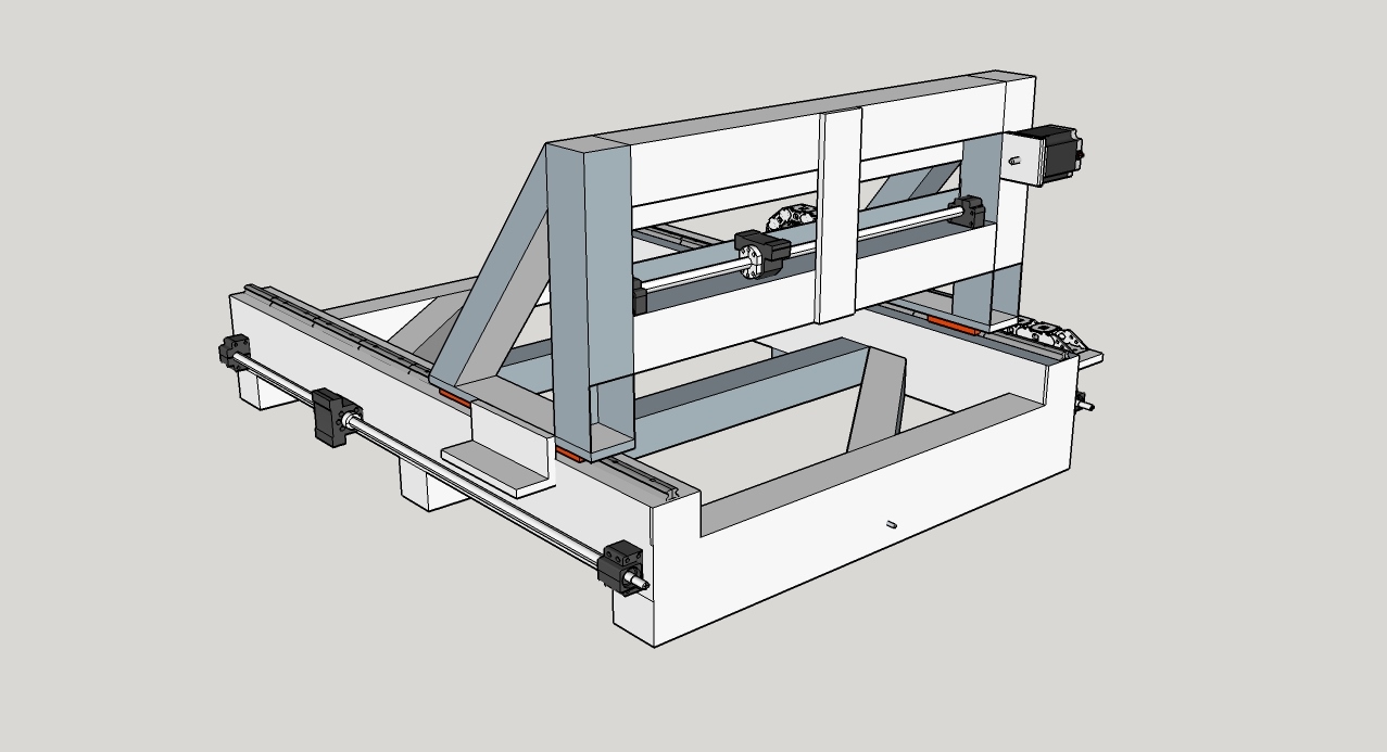

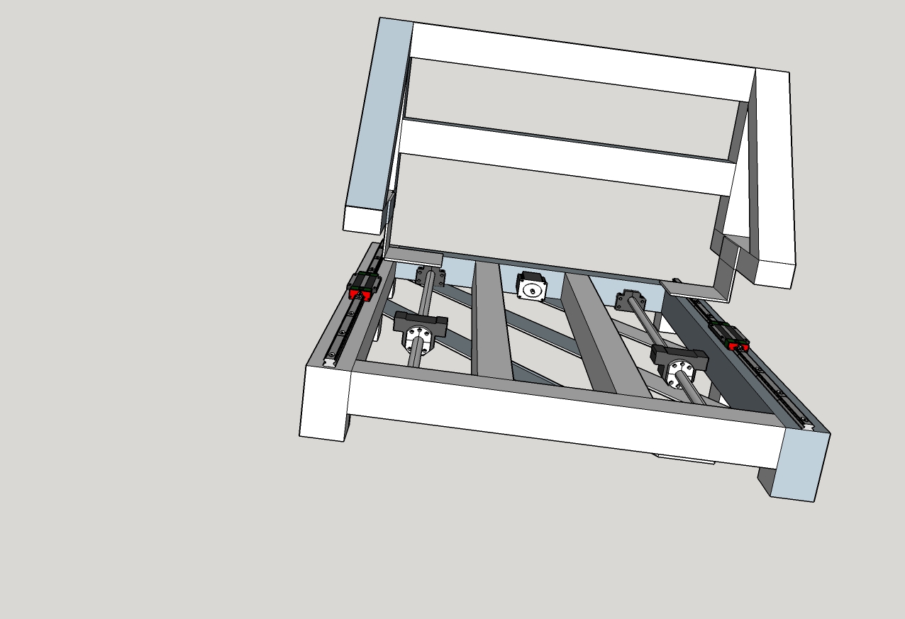

    Hi
    Thanks for all the advice, I have scraped the last attempt and had another go something similar to the first attempt but using two stepper motors and timing belts for the x axis. all box section is 50 x 50 x 4mm as I have a lot off it in stock. For mounting the gantry to the bearings I will probably mount a plate to the bearings and attach the gantry to the plate like EddyCurrent suggested .
