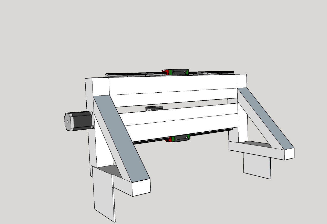

    Thanks for the advice would this be a better design.

    Hi Gregor
    That setup would ensure you get the Z axis very close to the gantry and the motor should be positioned as near to the centre of the X bearings as possible.
    Only problem i envisage is the alignment of the gantry rails, do have a solution to this ?
    Mike
    Yes, that's a better design.
    Mike
    You are right, maybe one rail could be welded and the other bolted to allow adjustment ?

    Hi
    When you talk about the gantry rails are they the rails on the x axis,Heres a few new pics ,I have done all the metal work to scale on sketchup and the dimension's off the base are 860mmx720mm not including the end plates on the base. The gantry was made 730mm to allow for clearance for the plates for the ballscrews. As I say I want to try and make it as simple and easy to make with most off it made by welding so let me know if this design is a load off Cr@P

    Quote Originally Posted by Gregor View Post
    Hi
    Well I assumed mekanik was talking about the Y rails, those actually on the top and bottom of the gantry cross beams.
    Are you putting the Y ball screw between the two cross beams ? if you are it's been suggested to add a plate to the front to keep crap away from the screw. This means putting a slot in the plate to allow the bracket where the ball nut attaches to the Z axis to move across. like here; http://www.mycncuk.com/threads/6418-...8048#post48048
    It also adds strength to the two cross beams.
    Yes the Gantry rails, top one can be leveled as per the X axis ie with epoxy but you then need to align the bottom gantry rail to the top one.
    Good point Mekanik I don't have an answer to that I hope someone will read this and know how to do it. EddyCurrent I don't have anything to cut a slut but I could weld some 3 or 4mm plate on like in the sketch
