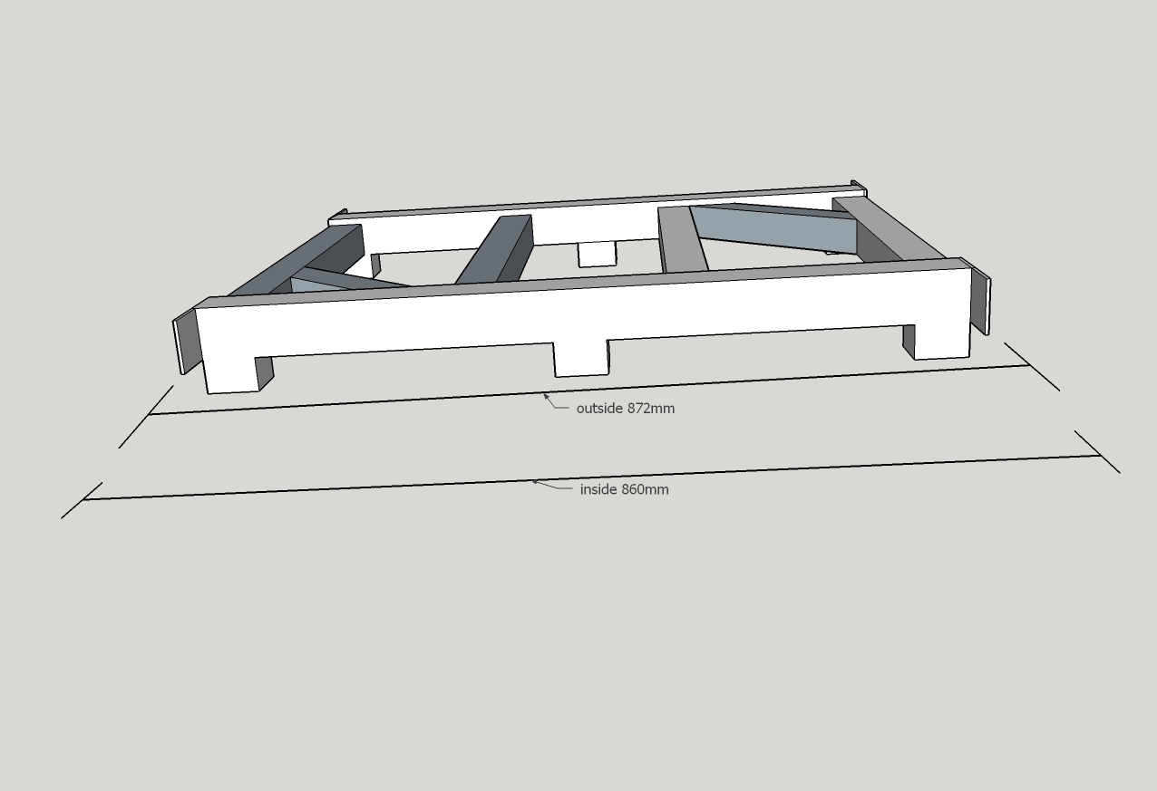

    Could someone please explain how you measure ballscrews and what fixing you need to order in order to fix the ballscrew.The ballscrew in the picture is the x axis off the machine and there is an end plate at each end welded to the frame . there is an outer and an inner measurement.
    Cheers.
Name:	cnc base finished with measurements ballscrew.jpg
    This is the 'standard machining', if you are going to use pulleys then ask for 'dimension F' to be increased to 30mm, that's what I asked Chai to do and he did it no problem and accurately.
    http://www.mycncuk.com/threads/4826-...2863#post32863
    BK and BF bearings are the usual choice, dimensions here; http://www.alibaba.com/product-detai...961879637.html
    Using that info you should draw it up in CAD to find the exact size you need.
