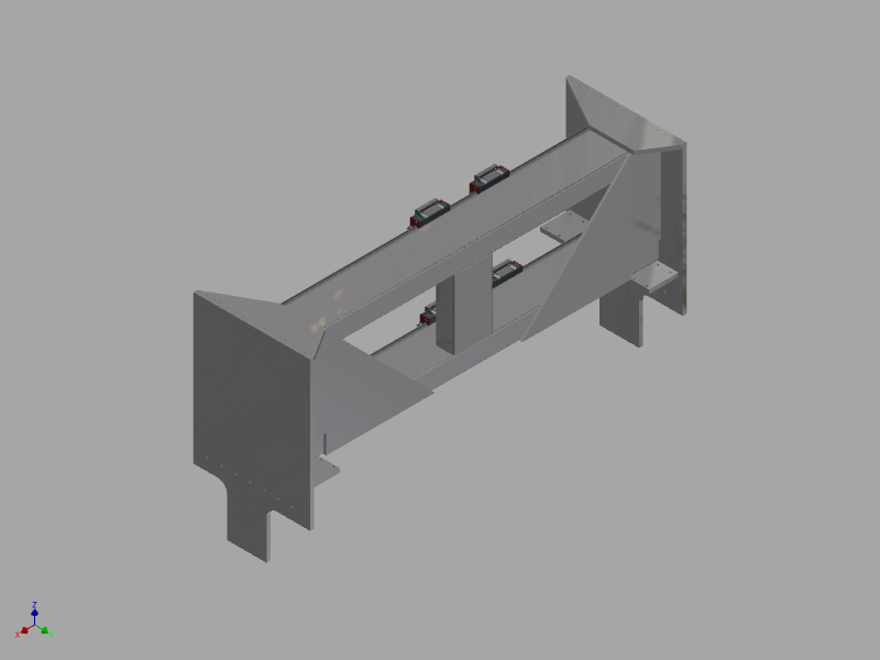

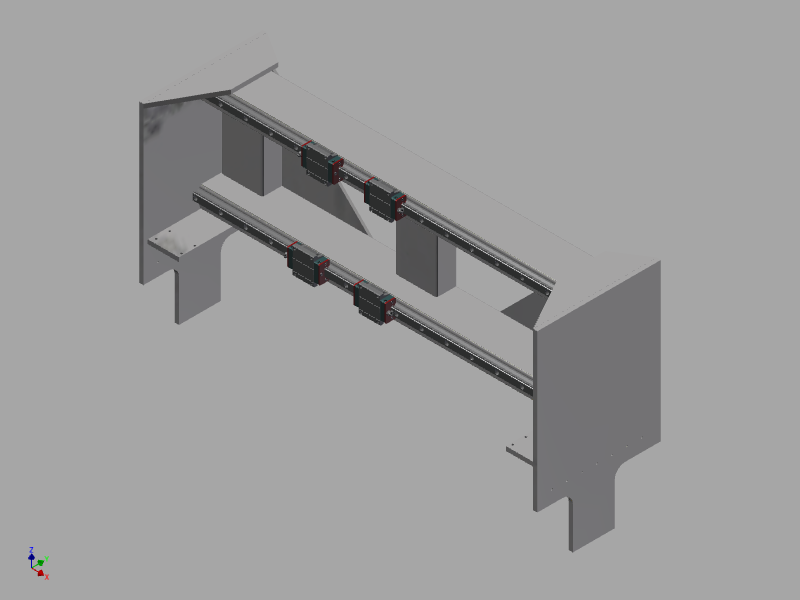

  7. #6
    playing with gantrys... please ignore drawing errors....just reused parts to get some ideas together
    1, steel, with welded beam (100x50 box), 4/6mm brace. Ends & bearing carriage are 10mm bolted and tacked or TIG brazed if necessary and bolted to gantry beam. gantry approximately 930 wide, weight approx. Mass approx. 52kg
ID:	14154   Click image for larger version.
  8. #7
    15 or 25 mm belts? What is the "rule" for minimum radius on pulleys for this kind of application
