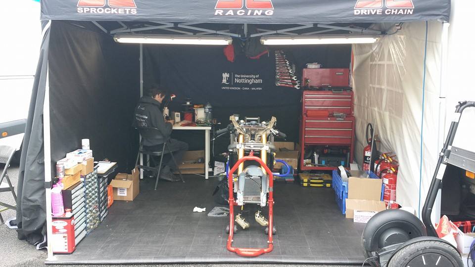

    We're at the TT now - arrived yesterday. All set up in the paddock, so now it's a race to get the bike finished in time and resit the temptation to play with our pit vehicle - a Segway.

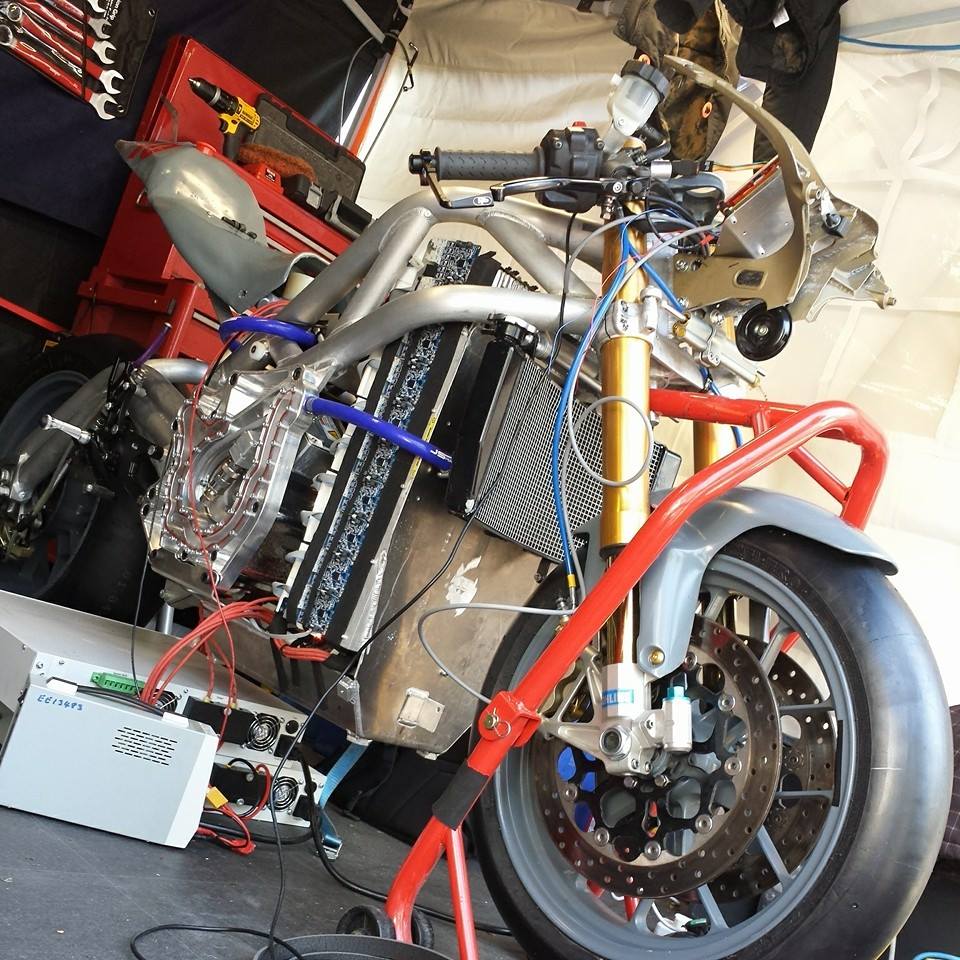

    We're almost ready now. First qualifier is on Friday...

    How much does it weigh Jonathan.? The squareness makes it look heavy but sure it's not.!
    Got any scales?
    Seriously, we've not had the bike all together yet so it's not been weighed and it doesn't look like there are scales for bikes on this island! We'll weigh it when we can, but I guess about 230-240kg. The batteries are the main weight at ~87kg. The frame hardly weighs anything - it's 7xxx series aluminium.
    Can anyone spot the bits I made ;)
    Would that be for hanging onto.?
    Don't they have a Minimum weight classification for Electric bike racing.? They do for the smelly versions.!
