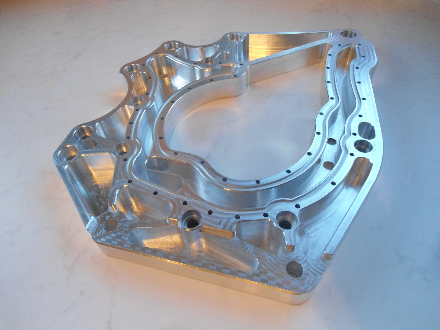

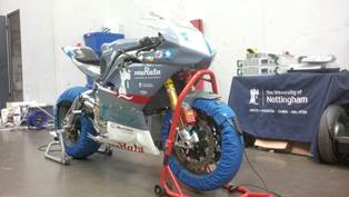

    I've had a mad last two weeks or so - but we did it! The bike survived the TT ... we blew up plenty of bits between races in testing and had problems with the bike cutting out (10 times!) during the race, but were still the fastest university.
    Must remember to buy more cooling hoses for next time, or hire the same van
    Would that be for hanging onto.?
    Yep, I also made the water cooling block below by borrowing my friend's CNC router. We were nowhere near finishing so we took my mini lathe in the van. Almost everyone who passed our box said 'look, they have a lathe!'... you'd think they'd never seen one before. The lathe proved just as useful to other teams as us - I think I helped out 5 different teams with it, including skimming a shaft from a sidecar.

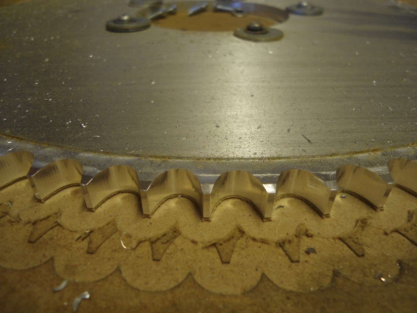

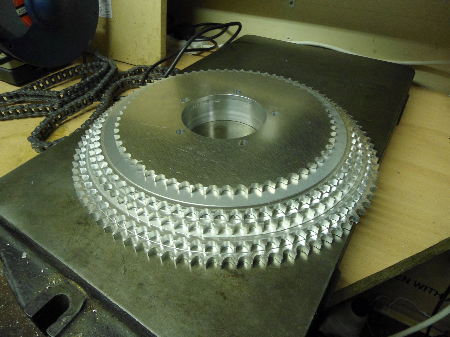

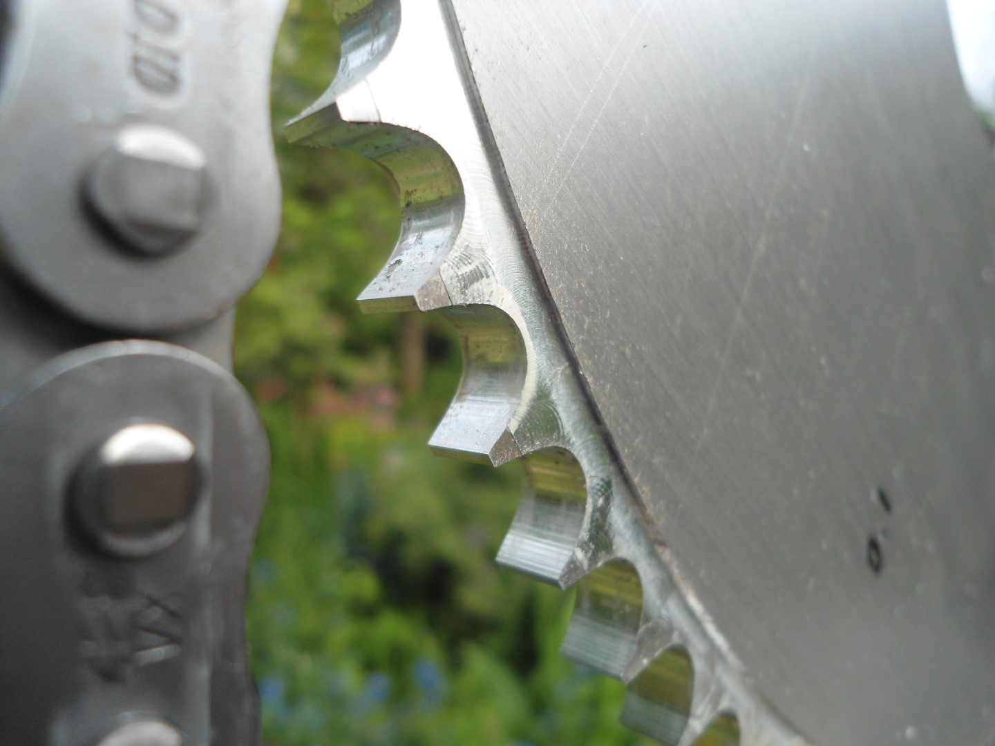

    Here are some more parts I machined for the bike - some sprockets:
    They were surprisingly easy - I just used a 6mm cutter for the main profile and a simple V-shaped tool I made from silver steel for the chamfer. Next time I will add some pockets to save weight. For these I was in a hurry so didn't bother.
    They worked, but were a bit wobbly as the aluminium plate wasn't terribly flat! The bike has done about 100 miles on the TT course and the 6082T6 aluminium hasn't worn much at all, so it doesn't seem worthwhile splashing out on 7075 grade. I think I'll just order some tooling plate to guarantee sufficient flatness and make plenty.

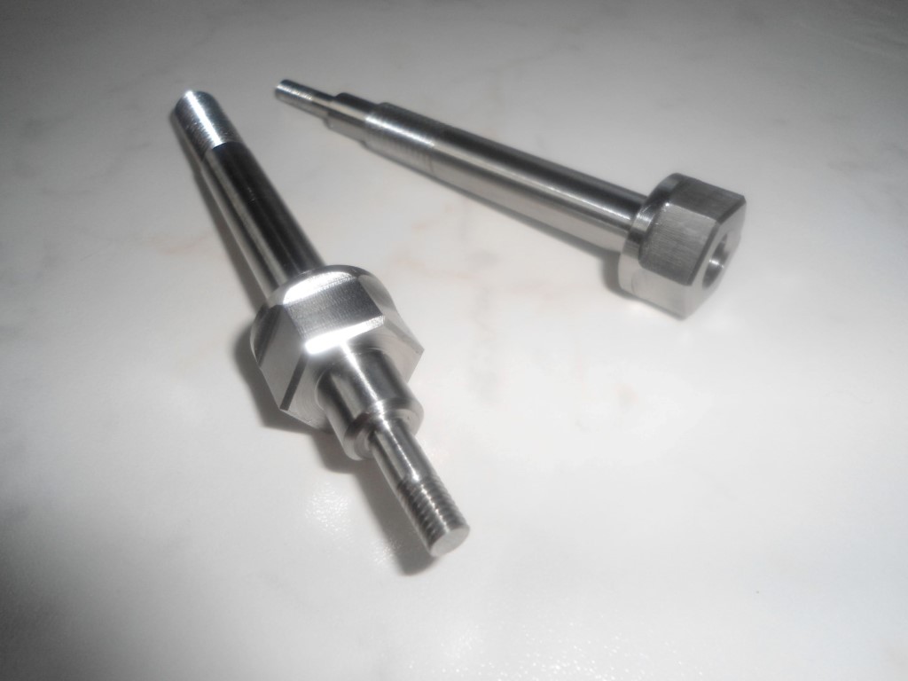

    Had some weird problems with our motor controller (resulting in us taking the bike to bits 3 times over the course of the weekend), so we had to limit both the torque and speed to 66%, but even so we were still just only 4 seconds a lap behind the superbikes.
    For this race I made a new rear sprocket plus some titanium M12 bolts so that we can have data logging of the suspension:
