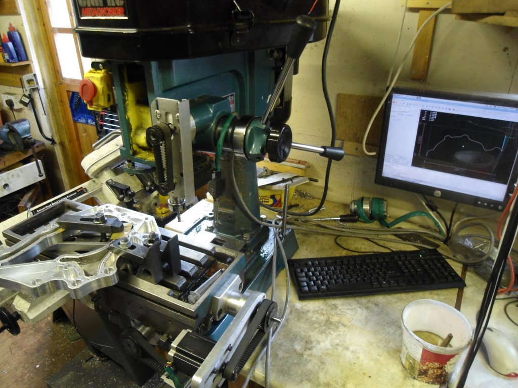

    Here are some more parts I machined for the bike - some sprockets:
    They were surprisingly easy - I just used a 6mm cutter for the main profile and a simple V-shaped tool I made from silver steel for the chamfer. Next time I will add some pockets to save weight. For these I was in a hurry so didn't bother.
    They worked, but were a bit wobbly as the aluminium plate wasn't terribly flat! The bike has done about 100 miles on the TT course and the 6082T6 aluminium hasn't worn much at all, so it doesn't seem worthwhile splashing out on 7075 grade. I think I'll just order some tooling plate to guarantee sufficient flatness and make plenty.

    About time I updated this...
    We won the races in Anglesey and Pembrey, messed up in Cadwell and won all three races in Portimao which meant we won the overall championship. We got a top speed of 145mph in Portimao, though still limited to 50% power output due to issues with the motor controller, so the focus is to make our own now.
    In terms of machining, I made several more sprockets - this time from tooling plate and they held up well. Also modified the water cooling block on the motor, as the rider ground it down a bit when leaning the bike over.
