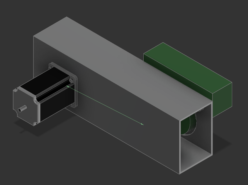

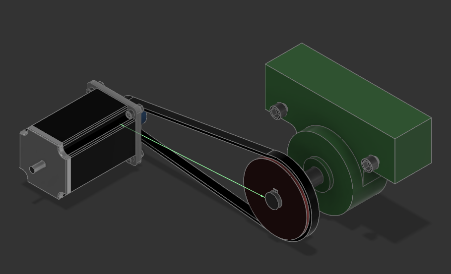

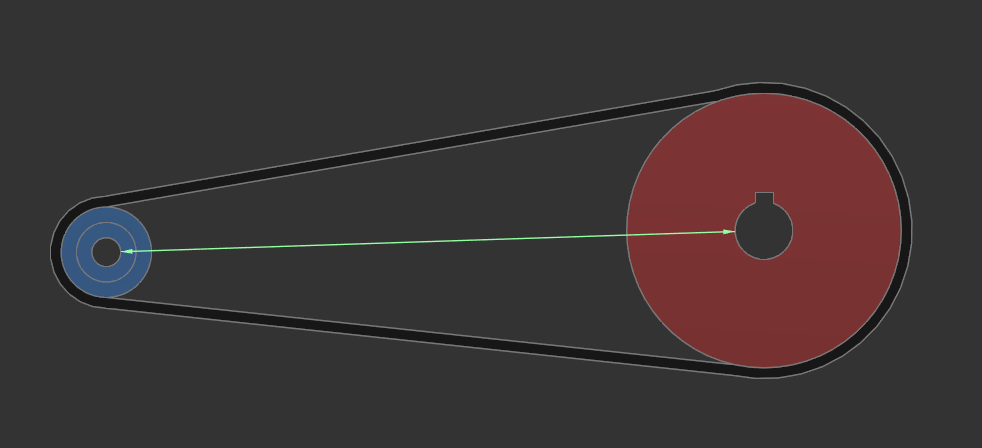

  1. #21

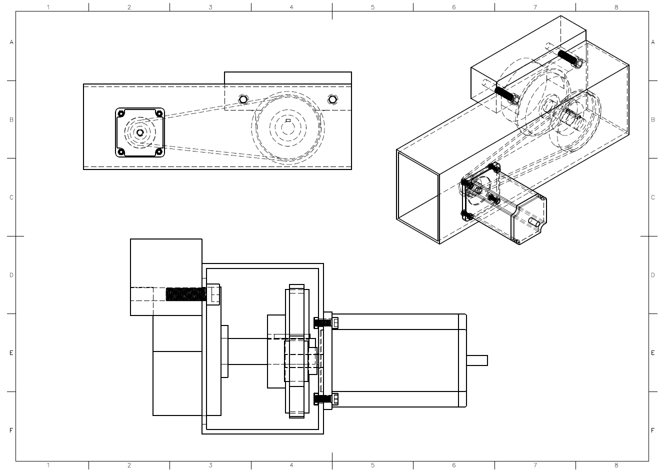

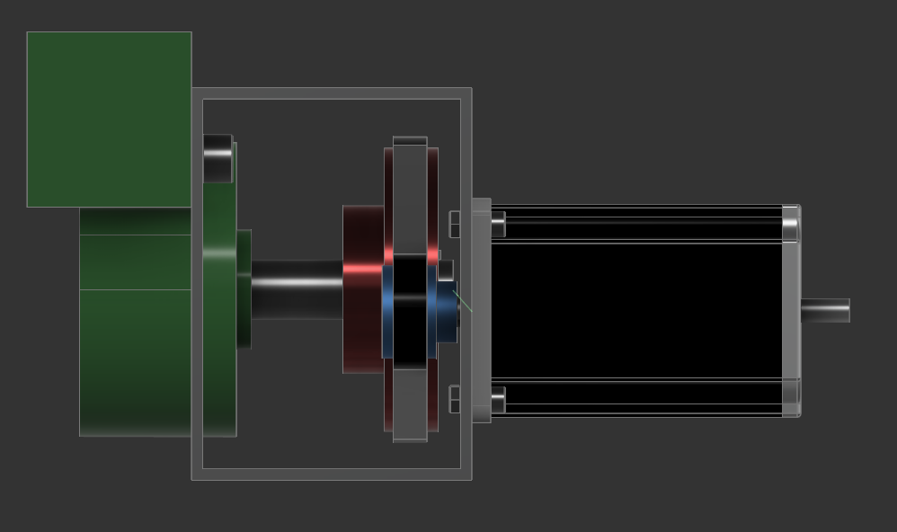

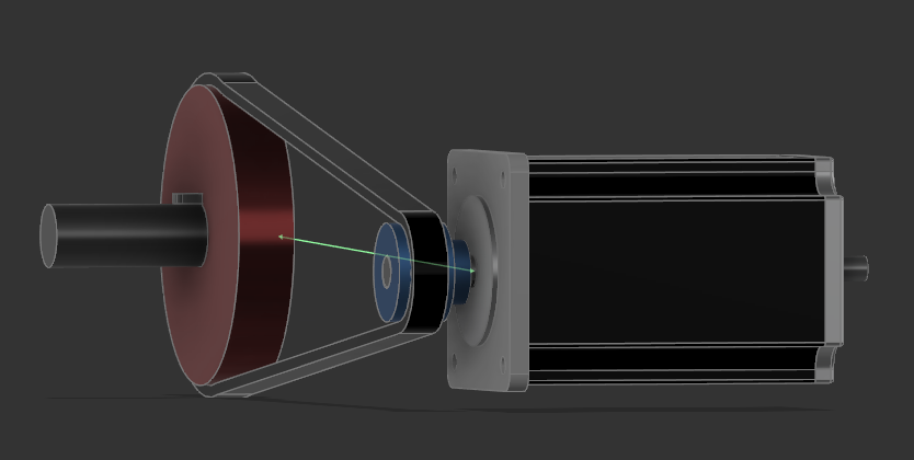

    Just on the first stages of design. This is the first version for the x-axis cnc mounting. I am looking at using 48 tooth 9mm HTD5 and 16 tooth 9mm HTD5 pulleys. Next drawings will be for the y-axis. Im saving the z-axis till last as I think it will take me a very long time.
    I forgot to add the slots on the stepper mounting to allow for belt tensioning.

  2. #22
    i2i's Avatar
    have you thought about driving the base of the z axis screw rather than the right angled motion shaft. More direct than either method you described.
  3. #23
    There are 2 kinds of toothed pulleys, timing belt and power transmission. I use XL pulleys because I have been caught out by backlash the one time I strayed. I am not saying HTD5 is wrong, but have you checked?
  4. #24
    Good thought.
    I did have a thought about direct driving the x and y with a stepper. However, after looking at other conversions it seems that everyone has done belt systems rather than direct drive, and only direct drive on smaller machines. All that I could think of for being an advantage would be that you would increase the available torque. Im not sure how much torque is required however im sure that a single Nema 23 3Nm stepper would be suitable for operating the axis'.
    If anyone has any some thoughts on this, again any suggestions would be sooo helpful.

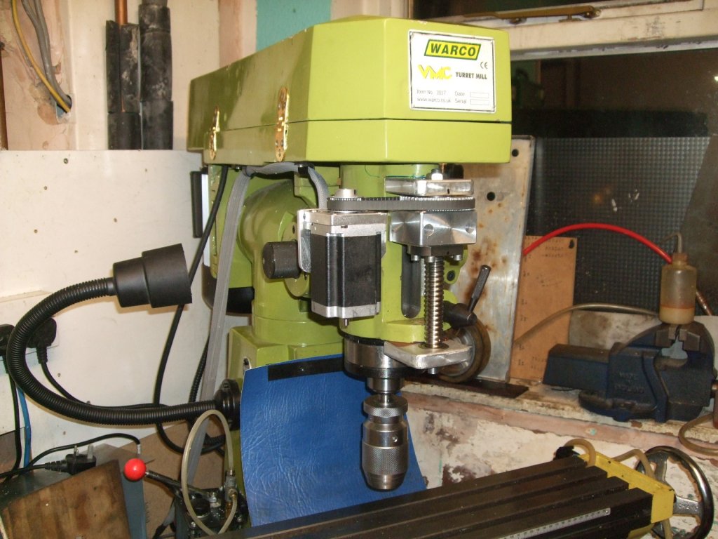

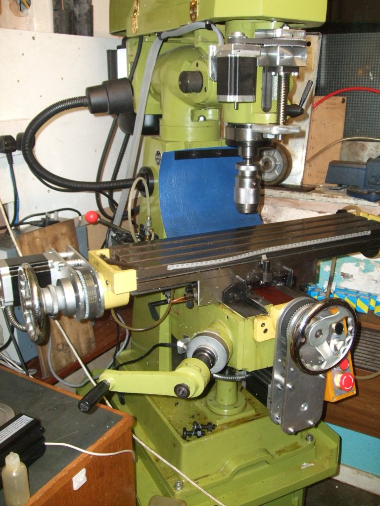

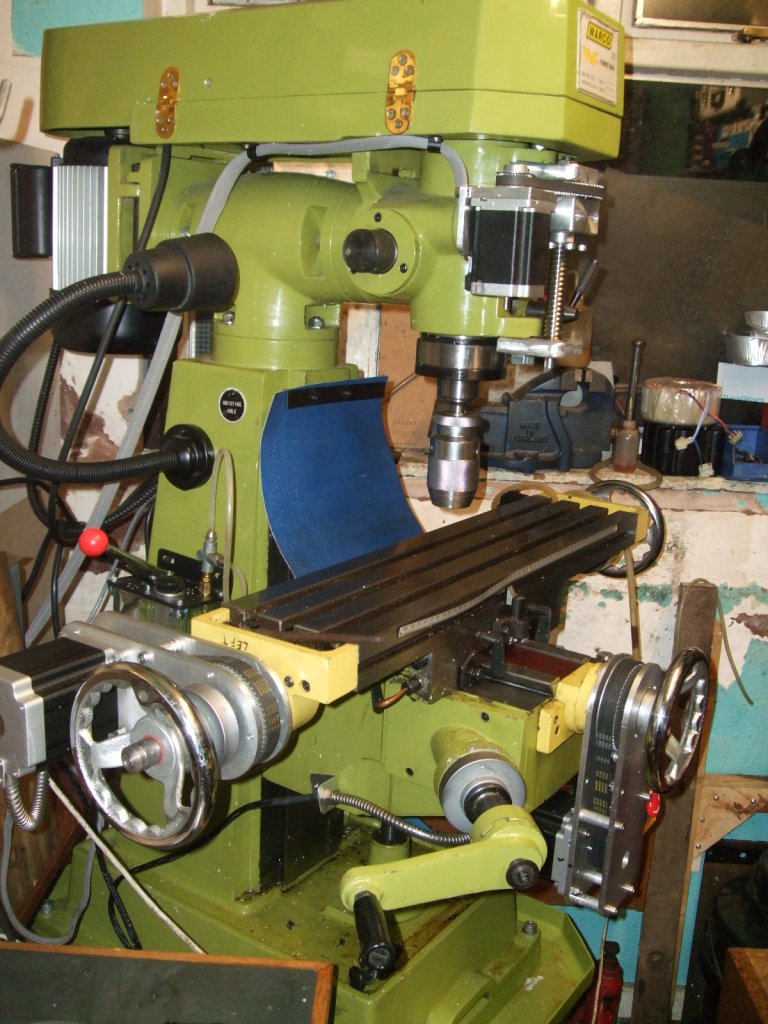

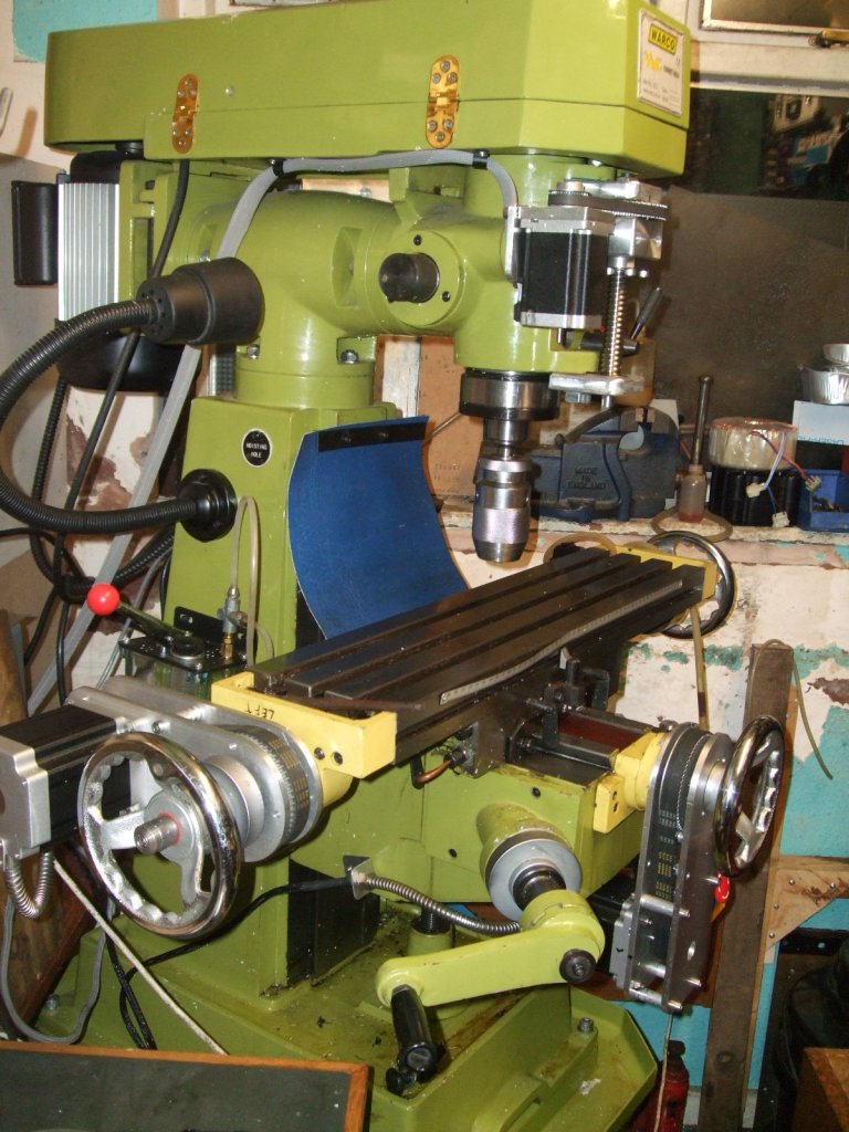

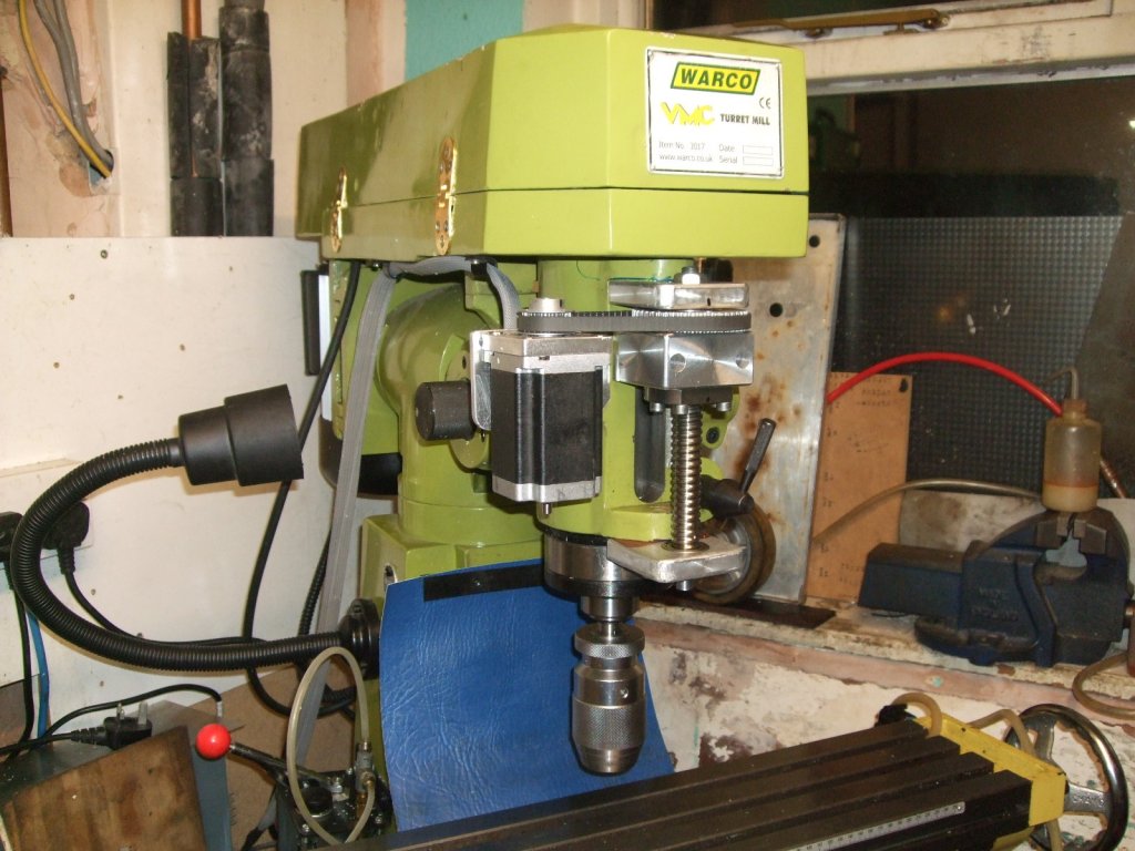

  8. #28
    Like this.
    Works quite well for a my uses.
    Some of the parts used
    Stepper motors
    http://www.ebay.co.uk/itm/German-Shi...E:L:OC:GB:3160
    Stepper driver
    http://www.ebay.co.uk/itm/Single-Axi...item2ed842f005
    Although I have blown 2 up. One was by turning the Travel handle while it Was moving.
    With careful treatment they now seem ok. I would like to try something better. May be a Gekko....
    Ball screws on X Y X
    I bought 2 Chinese Ball screws with 4 Ball nuts , and had the machine the ends to 16mm, then made suitable sleeves to fit the bearings.
    http://www.ebay.com/itm/2-anti-backl...:X:RTQ:US:1123
ID:	14322   Click image for larger version.
ID:	14323   Click image for larger version.
