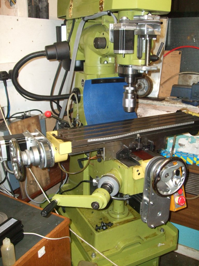

    Like this.
    Works quite well for a my uses.
    Some of the parts used
    Stepper motors
    http://www.ebay.co.uk/itm/German-Shi...E:L:OC:GB:3160
    Stepper driver
    http://www.ebay.co.uk/itm/Single-Axi...item2ed842f005
    Although I have blown 2 up. One was by turning the Travel handle while it Was moving.
    With careful treatment they now seem ok. I would like to try something better. May be a Gekko....
    Ball screws on X Y X
    I bought 2 Chinese Ball screws with 4 Ball nuts , and had the machine the ends to 16mm, then made suitable sleeves to fit the bearings.
    http://www.ebay.com/itm/2-anti-backl...:X:RTQ:US:1123

    Clive S's Avatar
    Lives in Marple Stockport, United Kingdom. Last Activity: 10 Hours Ago Forum Superstar, has done so much to help others, they deserve a medal. Has a total post count of 3,345. Received thanks 618 times, giving thanks to others 83 times. Made a monetary donation to the upkeep of the community. Is a beta tester for Machinists Network features.
    Nice Job. Did you not consider higher voltage drives to run the nema 34 motors. ..Clive

    Very nice looking build! So apart from blowing a few drives, any other problems?

    Quote Originally Posted by thorphar View Post
    In light of this recent discovery. I have re done my basket.
    I use to use AM882 however, after looking around online someone mentioned the DQ860MA Driver being ok instead of the AM882. Im just worried about the lack of sensor less stall detection not being on the DQ860MA. Thoughts ?
    Stall detect only works after 300rpm so it's not such a big deal for a mill. But what is bigger deal is how they handle resonance better and give smoother running motors. The DQ860ma are not as good in my experience so I wouldn't use them over AM882 or better still the updated EM806.
