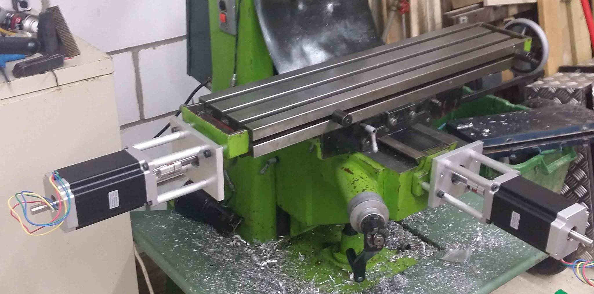

    Thank you all for the advice and help relating to this conversion. Here is where ive got to so far. I have managed to create a mounting system for the x and y axis drives. I have three nema 34 1600oz stepper motors. I have a custom ball screw to drive the quill. What I need to complete is the quill drive system. Im hoping to use the 2 Axis CNC to help create the parts for the quill drive. Things having been moving slow due to problems that occurred with the Chinese supplier for the Stepper Motors.
    I have attached a photo of the machine so far .
