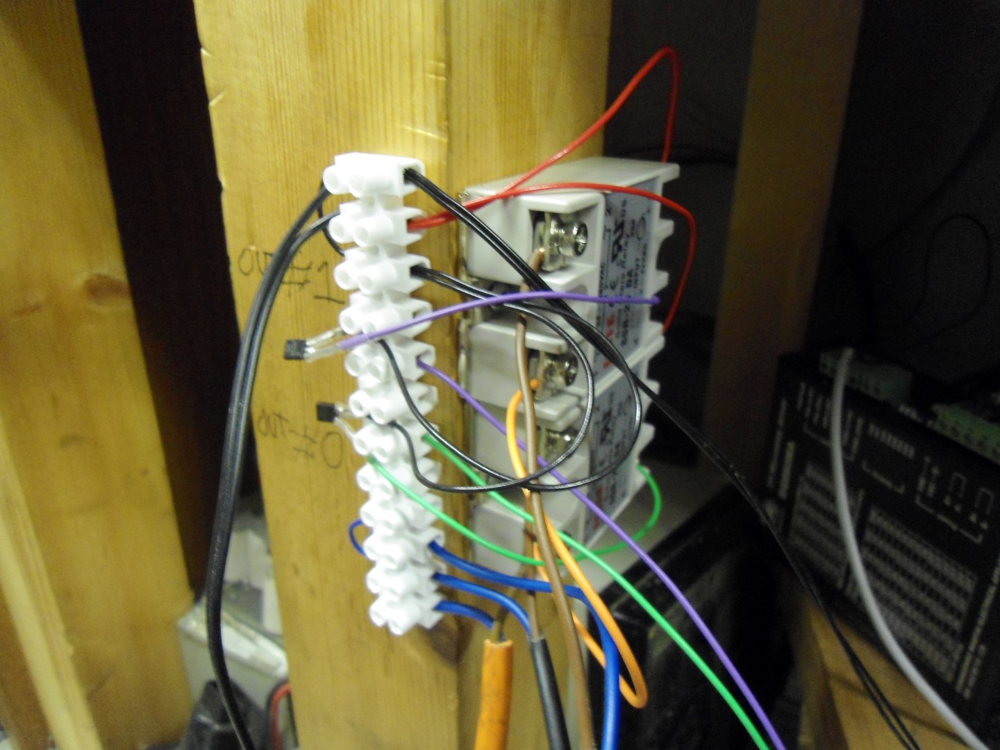

    You can shift it to 5V with a small mosfet/transistor and a couple of resistors, like my impromptu 'breakout board' here:
    Or you could go for something more sophisticated - e.g. add a schmitt gate. Or kill two birds with one stone and use and optocoupler and phototransistor instead of just a transistor.

    Thanks for all the posts.
    Case is that I already has a semi-working controlcabinet. A wood router based on stepmotors, controlled via puls/step from an ESS smoothstepper.
    However I have a lot of noise (Due to improper shielding, and poor worksmanship, I know !)
    Now I want to make it more correct and one of the things is to drive the stepper controller inputs (Optocouplers) from a line driver, using a shielded twisted pair cable.
    Right now it's single ended connection (Common anode) and a straight, non shileded cable.
    So from the ESS output, I want a Differential/Complementary Line driver, so 2 wires to each input.
    In order to make it as immune as possible i want that to have 24V on the lines.
    And the driver must be able to source/sink 20mA for the Photo-LED
    I expect a min. of 500kHz pulse frequency.
    For Limit switched i use Omron proximity sensors that work in 12-24VDC range. And is Sinking current (Ground) when activated.
    Again this I want to drive in 2 wires as before, to a "reciever" chaninge the 24V line signal to the ESS input pin.
    I have 5-12-24-48V available in my cabinet.
    On top of the all the cable routing must be reworked, so stepper, sensor and spindle cables are routed separately.
    Hope this draws a more clear picture of what I'm trying to achieve here.
    Again thanks for all the replies, I have something to google now :-)
