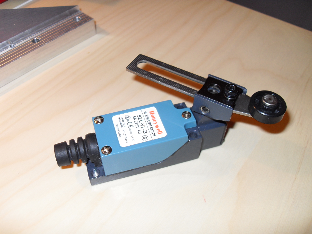

    Found some limit switch's, bit big but they will do.
