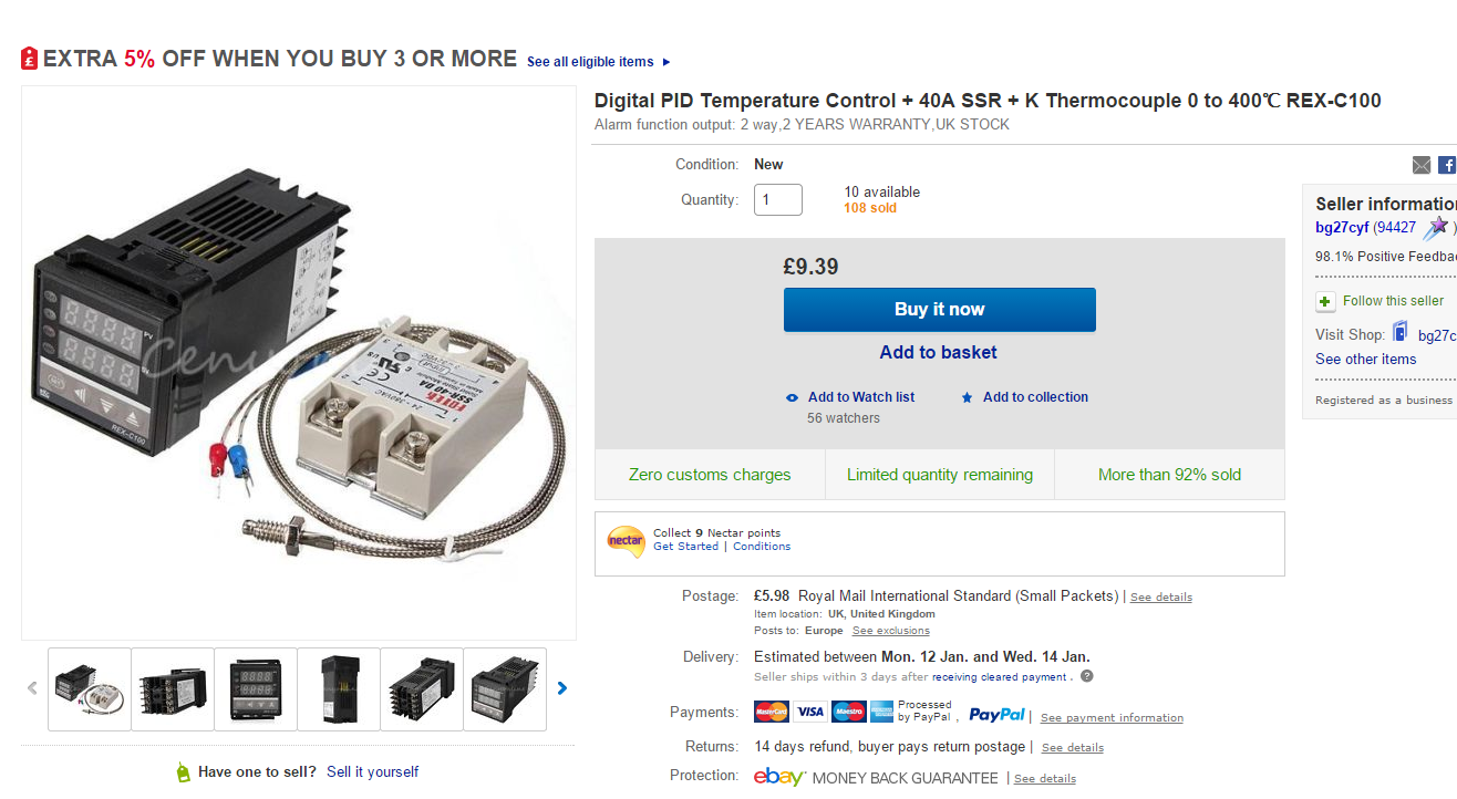

    How did you calculate that 530 euros? Double head setup? 1 head setup is around 250 shipped to you. Look below. I suggest powering the bed and the hot end 220V via cheap ceramic elements the right size ~5 euro at ebay and using separate cheap PID control, look 2nd snip below. Thats much cheaper than dedicated board which needs 12VDc or 24VDC. The only thing thats left from my calc is the driver.
    But you are absolutely right, 2 head setup will be that money. The suggested setup we were speaking above is Top notch, full metal heads and reliable extruders. I believe, yes its worth it if you will use it.
    My line of thought is this. If you prototype or produce something with strange shape from plastic, it would pay on the second job. Imagine making something bulky from solid plastic, wow, it will be very expensive. Imagine then making it where necessary and only surface machine it later. Thats where the 3d printing will shine, though most of the guys are unaware of that cause they don't have CNC routers.
    But if you want to play around and make a couple of parts, just prepare 2 head setup but buy one head, so if you need later just buy the second head.
