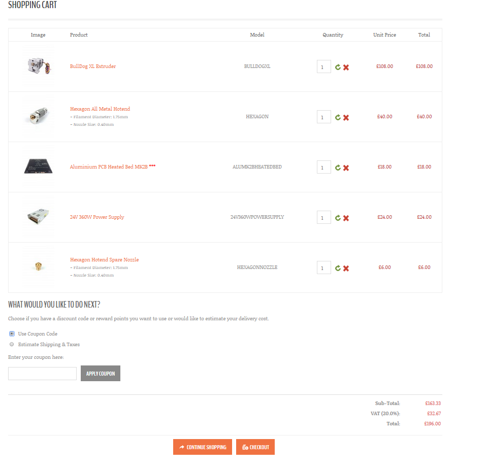

    How did you calculate that 530 euros? Double head setup? 1 head setup is around 250 shipped to you. Look below. I suggest powering the bed and the hot end 220V via cheap ceramic elements the right size ~5 euro at ebay and using separate cheap PID control, look 2nd snip below. Thats much cheaper than dedicated board which needs 12VDc or 24VDC. The only thing thats left from my calc is the driver.
    But you are absolutely right, 2 head setup will be that money. The suggested setup we were speaking above is Top notch, full metal heads and reliable extruders. I believe, yes its worth it if you will use it.
    My line of thought is this. If you prototype or produce something with strange shape from plastic, it would pay on the second job. Imagine making something bulky from solid plastic, wow, it will be very expensive. Imagine then making it where necessary and only surface machine it later. Thats where the 3d printing will shine, though most of the guys are unaware of that cause they don't have CNC routers.
    But if you want to play around and make a couple of parts, just prepare 2 head setup but buy one head, so if you need later just buy the second head.

    No single.
    Well that's certainly cheaper than what i looked at thanks.
    The driver I am looking at is around 29 pounds, and I have to get a 4 axis Bob as mine is a 3 axis (has to be USB controlled 200khz as I have no printer port = 65 pounds)
    To get a double head setup.....buy two extruders and 2x nozzles ??
    I guess the bed on ebay is "slightly better" as it comes complete, but then there is an added post charge. Does nobody make larger heated beds ? I'd like one the same size as my cutting bed 500x300
    Apart from all the parts above and a custom made Z plate adapter for all of it, is there any other hardware needed (apart from cable/connectors) ?

    yeah, the bed you can get from aliexpress . Here are the guys that actually make them , so they can make one for your exact machine but first check cause they have many sizes
    I would rather start with only 1 good extruder and hot end than 2 bad ones. And build piece by piece the system if i dont have the cash to buy it right now.
    I know its hard but you have to take the bullet if you want to sleep well in the future.
    The better the system the better will look the final product and more precise.
