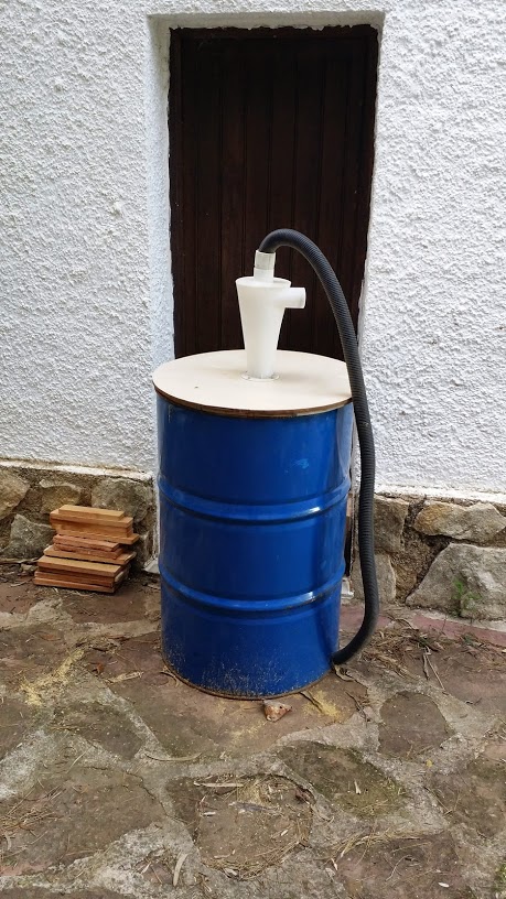

    This bellow is my dust separator, made from 200l tank which is 1mm thick. So my 2000w shop vac will not bend it at all when all closed. You can not lift the top either when vac is working, though it just rests there, is not screwed. Pads ring is from old yoga mat. Of course the compressor will pull much more vacuum than the vac cleaner.
    By the way this thing works really well. The plastic conical thing is from Aliexpress.

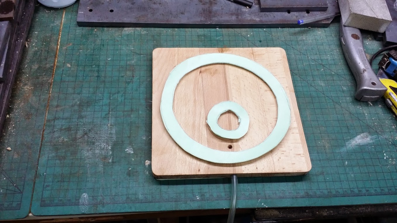

    I made some test jig from wood. Works perfectly.
    One thing is clear to me now. All hosing from compressor up to the CNC must be industrial 1/4 or 3/8, cause i will step on it, solder over it and so on. It must be strong so no cheap PVC hoses here. Added bonus is that i use the same hoses and extensions like for air. So the only thing i bought is the 3/8 quick connector which i fitted at the compressor inlet side.
    Decided to save on connectors :-) so i drilled the vacuum fixture and just pushed the PVC hose inside, it works perfectly. Recessed all the necessary areas 3mm. Drilled hole to the back so the vacuum fixture is self fixing to the table. Hole could be closed and instead fixture clamped.
    The mat is non slip mat from chinese shop -2euro. 15mm wide rings, i wanted a superb friction.
    Next step will be when i have time to fit the Vacuum switch to the compressor, check the negative pressure achieved and test if using vacuum reservoir/the compressor tank/ is better in any way.

    has the wood been sealed ?
  6. #26
    Quote Originally Posted by Blackrat View Post
    No, but it seems is not necessary. Its very dense. I made it from wood as a test to understand better how it works, before making some stuff in aluminum. It seems though it will perfectly work if wooden. it made from a solid kitchen cutting board. however sealing it is recommendable, due to humidity so it would not twist when dry or humid
    it will suck probably more air from the actual part, which is has 3mm bottom /pine/

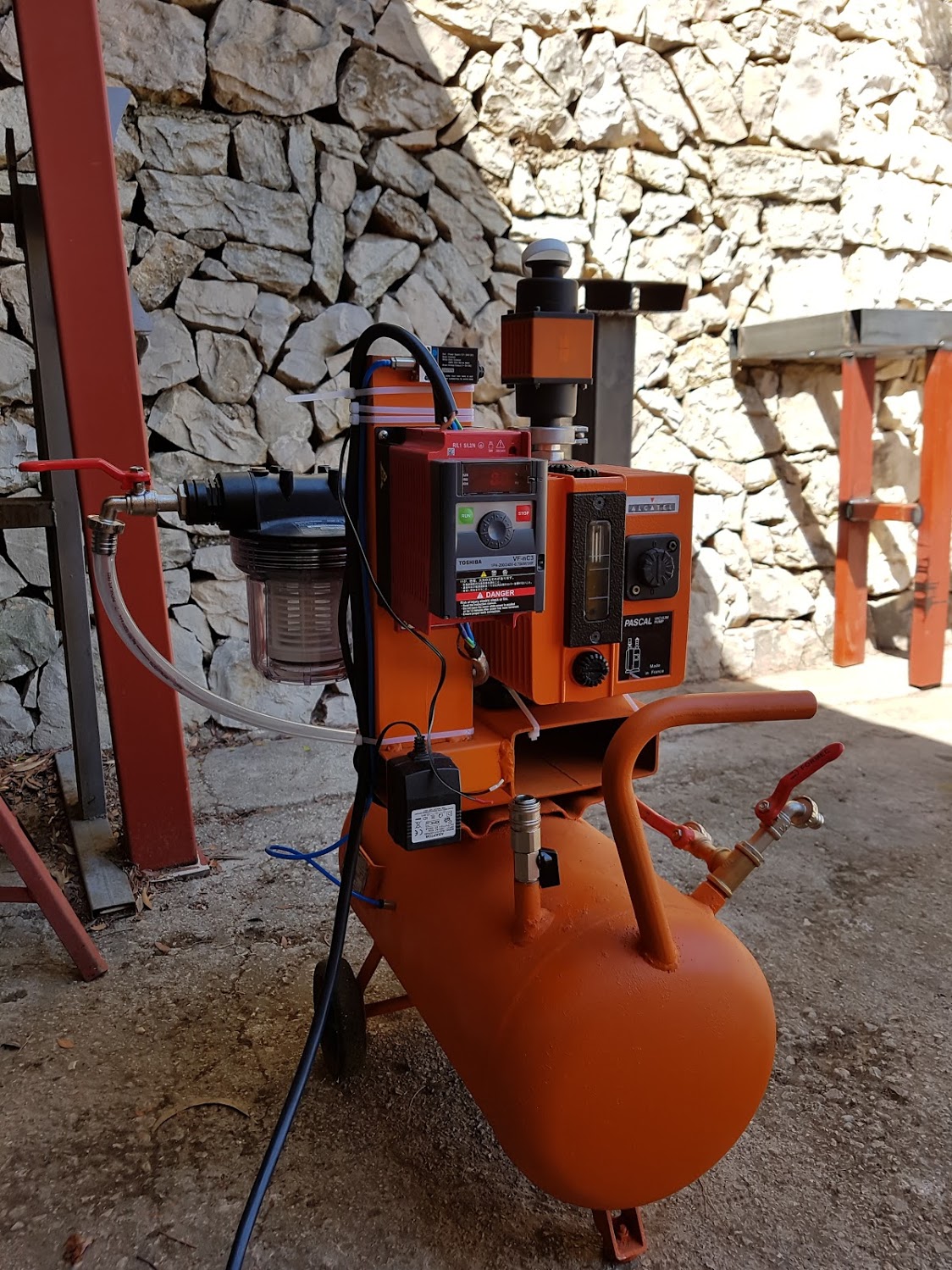

    Bought from ebay an Alcatel 2010 vacuum pump from Lithuania. WOW what a sucker! 7cfpm , 2 stage, 350W. So these days i have been finishing my new Vacuum Pump Station.
Name:	vacuum station.jpg

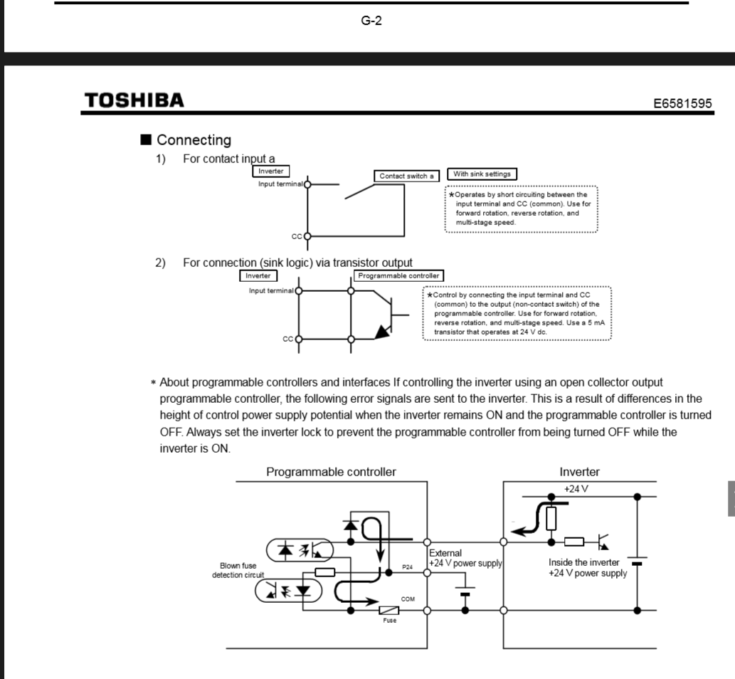

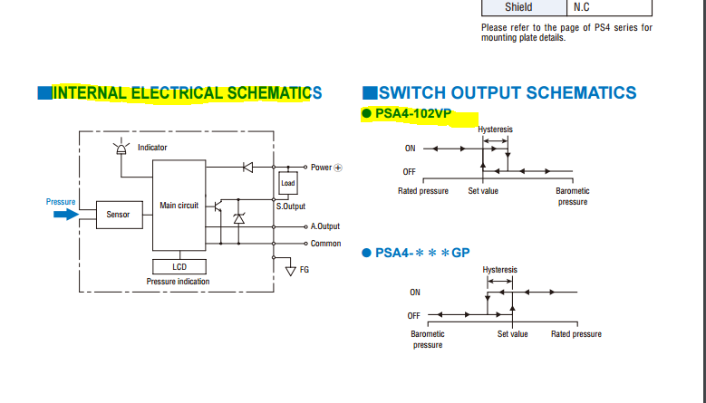

    Basically the pump is mounted on old air compressor tank, driven by VFD as its motor is 3 phase 350w. The pump is fitted an original exhaust and DIY inlet filter and separator. The pump sucks -filter-hose-tank-quick connector. There is an vacuum sensor switch fitted to see pressure and eventually when i figure how to connect it to my VFD. May be i need a relay or sth. This is the part that i always don't understand...
