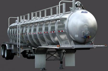

    Be careful with compressor tanks they are designed for positive pressure not negative and they DO implode under high vacuum esp if they are old rusted and not vented correctly.
    I'm not scare mongering here it really does happen. My son builds and tests tankers and you'll be amazed at how destructive Vacuum can be on what seem like strong tanks. Watch the Video.!
    The Lad in the Green jumper connecting the pipes at 3:19 is my Son he was also the one who crushed the tank hiding behind the tanker while filming and venting the tank . This was an old tank with it's internal baffels cut out to help crush (Your compessor also doesn't have these braces or baffels.) and you'll be amazed how little Vac pressure was needed to flatten that thing.!! . . . . Don't under estimate Vac pressure it's a Killer.!
    If your planning on using the compressor has Vac tank then suggest you weld exterior rings as braces to strengthen. Like this. Click image for larger version.

    EdIt: Oh by the way those Numpty's weren't acting either they really thought they'd crushed the tank. . .Lol (Serieously)
