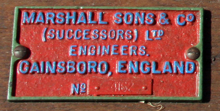

    The parts I want to make are for steam engine name plates. So no real tolerance problems. Although it will be interesting to see what it can hold. I will be working on plate sizes no more than 75x75 and will locate workpiece origin close to machine origin. This will also minimise the deflection

    Unfortunately they are anything but simple. Some have 3D coat of arms and fancy foliate lettering.
    Reproducing the original cast iron plates.
  6. #16
    A relativly simple one!!
Name:	Marshall Logo plate.jpg
  7. #17
    Going for emboss will mean a lot of material removal, in contrast to engraving the letter path only. Also, the whole area removed will show the endmill paths, it is a natural aspect of milled surfaces.
    The plate you showed is more suitable to casting, rather then milling. On the opposite side, if the surface was flat and the letter sunk into it, it was more suitable to engraving.
